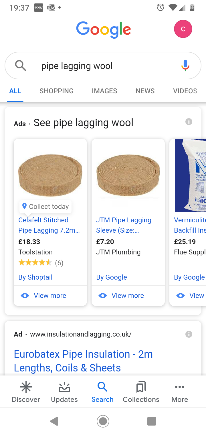

Pipe lagging/wool/felt/wrap depending on who's selling it.
