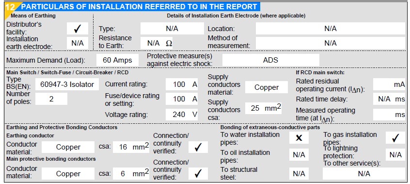

Bonding Q
probaly 6mm
On EICR is does say it's 6mm and no comment about being undersize, or needing upgrading
As advised here 10mm is required I'll get that upgraded to 10mm.
probaly 6mm
Whether installations that are safe but "not to current standards" should be upgraded is one that comes up from time to time here...
Personally I would not recommend replacing what you have unless you are doing some other work at the same time.
The electrician added an advisory to swap out CU for a metal one. When I asked him to check, he then advised existing plastic CU’s are still OK.
Planning to change it out when Tennant leaves as only advisory, could get bonding upgrade then.
