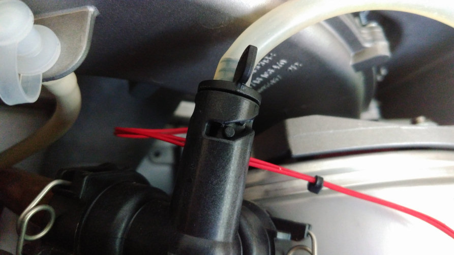

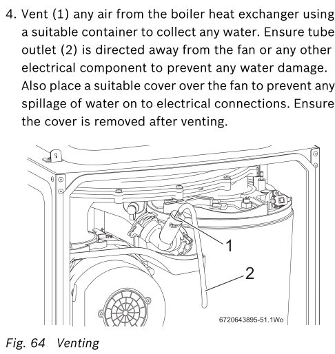

Hi all,
I'm trying to open my heat exchanger vent to remove any trapped air (after a system flush) but the wingnut only turns a few mm before stopping and no air/water escapes out of the tube outlet.
pic of wingnut in closed position:

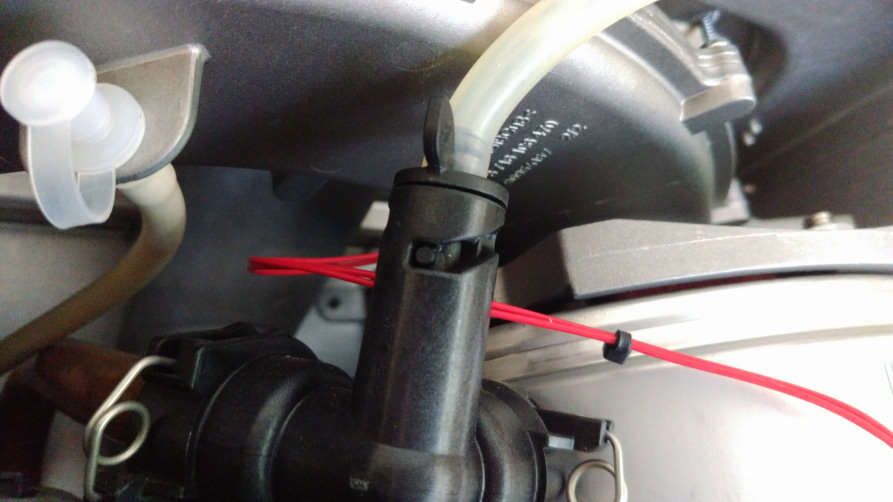

pic of wingnut in "open" position:
As you can see from the "open" position it stops at the bottom before the angled riser to the right. I didn't want to force the wingnut too much in case I snapped it but it looks like it should turn a lot more and why no air/water is vented through the tube outlet.
Should the wingnut turn further to open the vent or is there perhaps a blockage?

Answered this myself - I have found a youtube vid showing exactly how far it turns.
