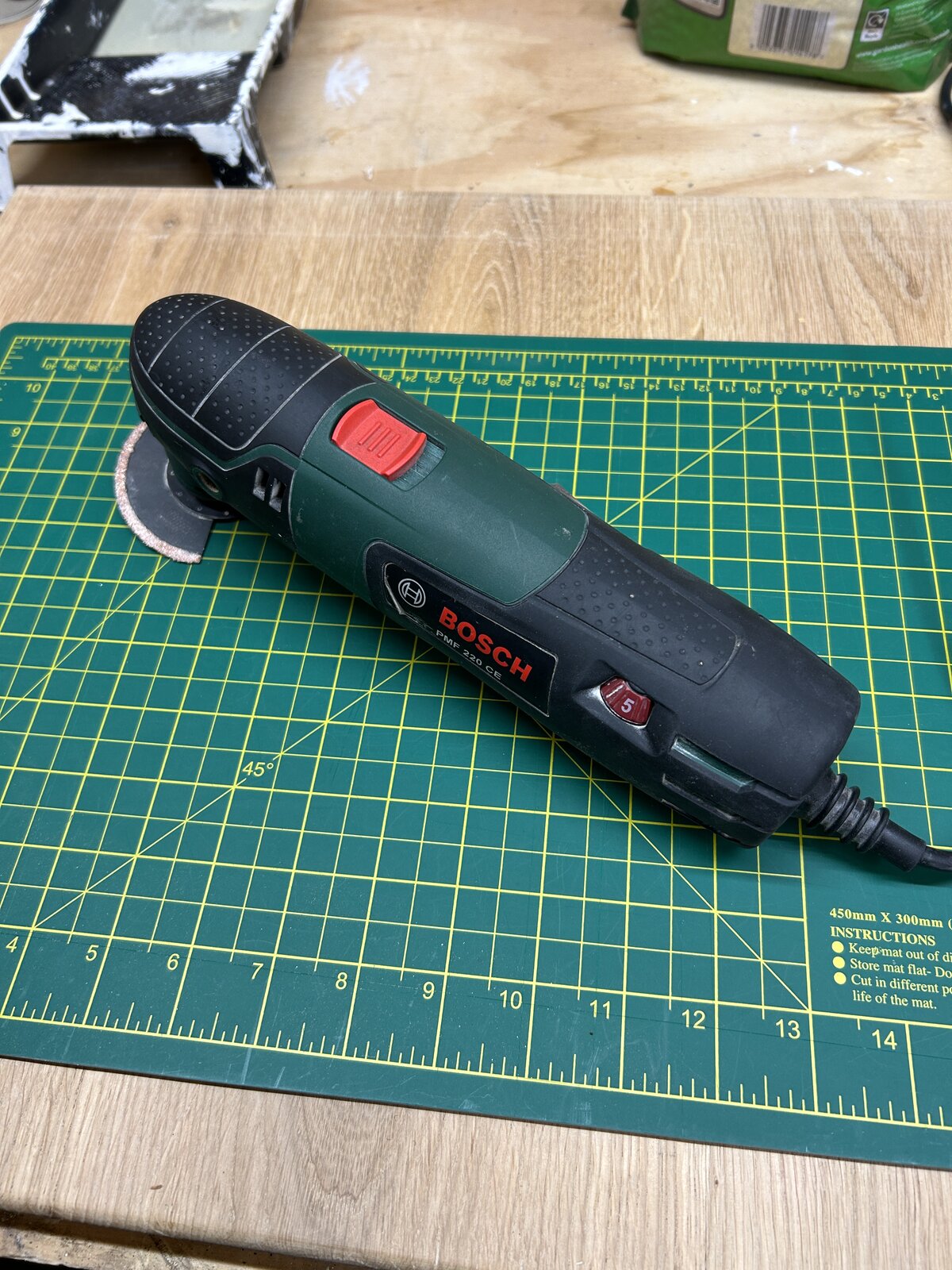

Evening.
I’ve got the above multitool which I’m currently using to regrout bathroom tiles.
It’s suddenly started losing power and sort of fluctuating.
I was wondering if this could be the brushes? If so they don’t seem to be listed as a spare part.
Any ideas?
Cheers.

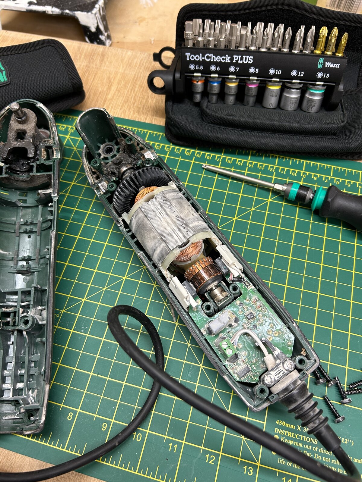

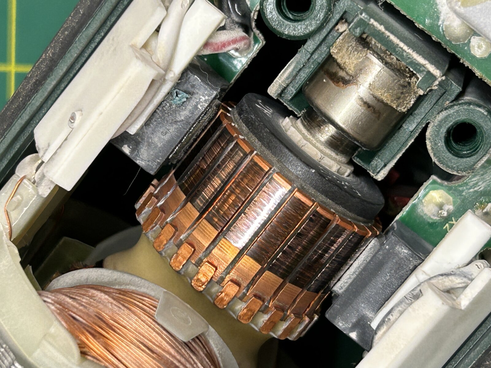

The insides look quite grotty. I assume they are the brushes either side of the cylinder?
7A97724A-61E4-49D8-8925-87AA8BCF4314.jpegDF7D47AE-CCE3-4E7D-B0A8-2BBB41BF02A9.jpeg07355952-F347-4A5A-A080-CD4C5B3DE5A4.jpeg
yes, they are, the lower one seems to have some spare graphite showing, the upper one it is hard to tell, might have to take it out for a look to see what state it is in.
when you come to clean the commutator[copper bit] do not use anything coarser than metal polish like brasso or silver polish
Don't use metal polish! You do not want any liquids near the commutator. Liquid polish will leave residues which may cause tracking. Use fine grade GLASS paper, NOT SAND or EMERY paper! After polishing, remove dust with a soft paint brush and vacuum nozzle.
Yes the two boxes are the brushes. Bottom one looks as though it may still have a little life left in it but top one looks past the point.
If you can get them off, you may be able to find a carbon brush to cut down to size but it will be tricky re-fitting them. There is probably a small spring/tension bar behind the brush which will need to be put back in place as you assemble it.

In my limited experience, brushes spark when they wear down to the spring. The exception being my Festool tools- they have a sprung loaded slug in the brushes that pops out when the brush wears down- thereby protecting the commutator by sending power through.
Your intermittent, and then loss, of power sounds like a cable fault. Use a multimeter to check the continuity between both ends of the live, and then the neutral. BTW, I once made the mistake of using a volt pen on a lead for one of my dust extractors in the expectation of finding a break. I hadn't considered the fact that the break was in the neutral...
Another possibility is the capacitor. With some of my tools a faulty capacitor has caused the motor to turn very slowly and sometimes speed up and eventually stay in extremely slow rotation, nevertheless the motor has tried to turn (whereas your doesn't).
