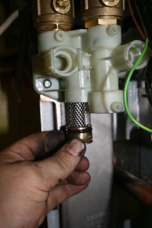

Ive got a heatslave oil boiler in my utility. 1st thing i did was throw a magnaclean on the return and put 3ltrs of inhibitor in. Still didnt stop the div vlv seizing :lol:
Petit Pablo, said filter is not fitted to all 400s. Know this from experience. Stripped almost all the units to single parts looking for this filter but non fitted as advised by WB during 4th call while on that job.
Client had Scottish Gas in to carry out repair before I was invited, to be told power flush needed. Turned out thhe pump was week and there was a massive air lock. The diverter is servo operated by pump power.
All the stripping, cleaning, replaced pump and new seals and air lock clearing had given the boiler a new lease of life.
Quite often come across a few where a previous engineer has taken it out in the belief it will last a little longer Danny, but I always put them back in.
[/img]
Thanks pal, another tip filed away for future use. Great picture
That must be one of the BG "tips" to remove it which are listed on that computer system the rest of us are envious of !
Its one of the facts of life that removing filters does increase the MTBF. Its just that the next one cakked out has to spend four times as long !
