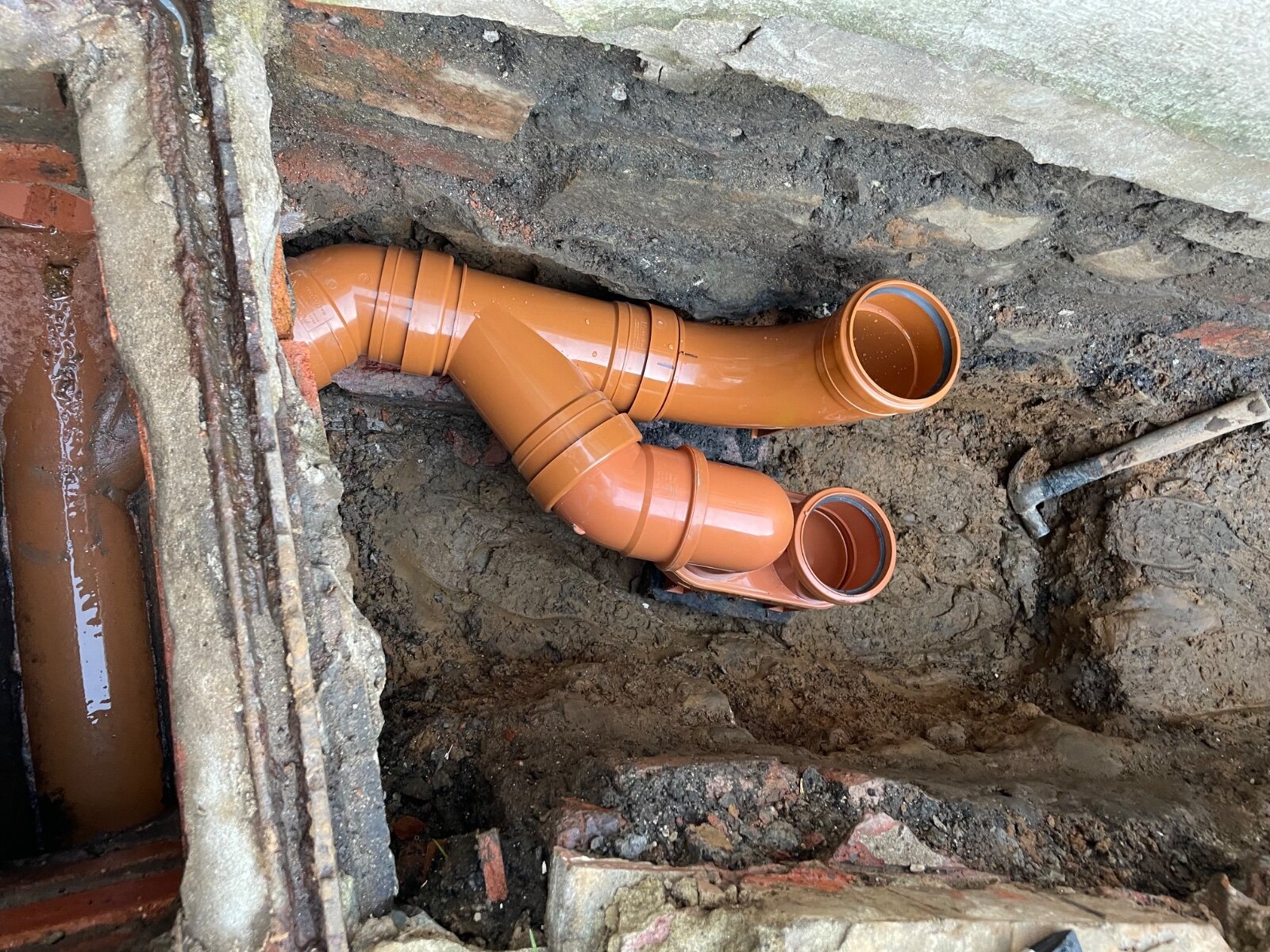

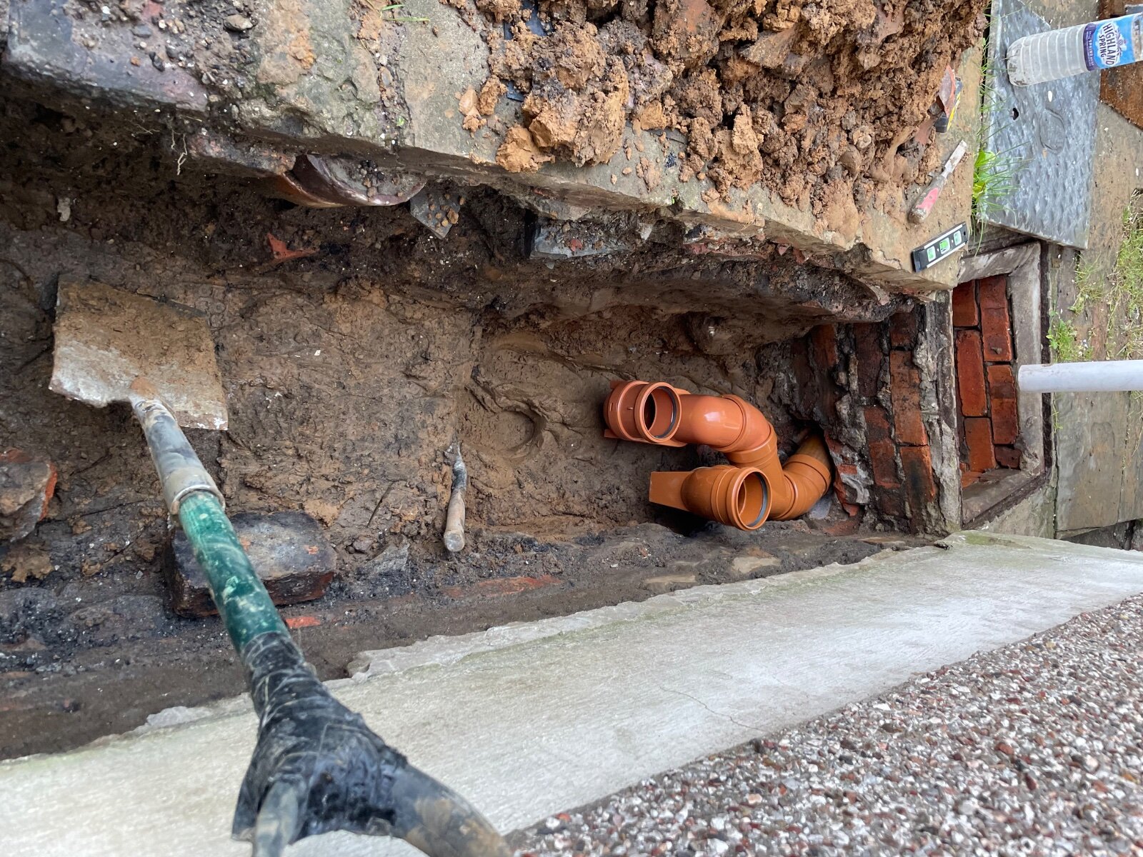

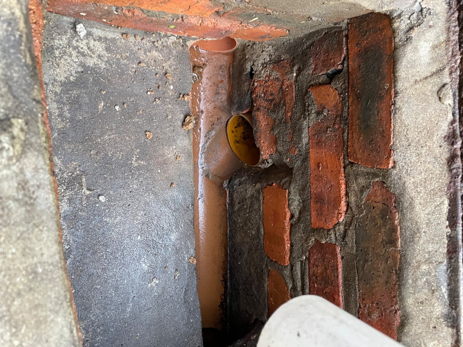

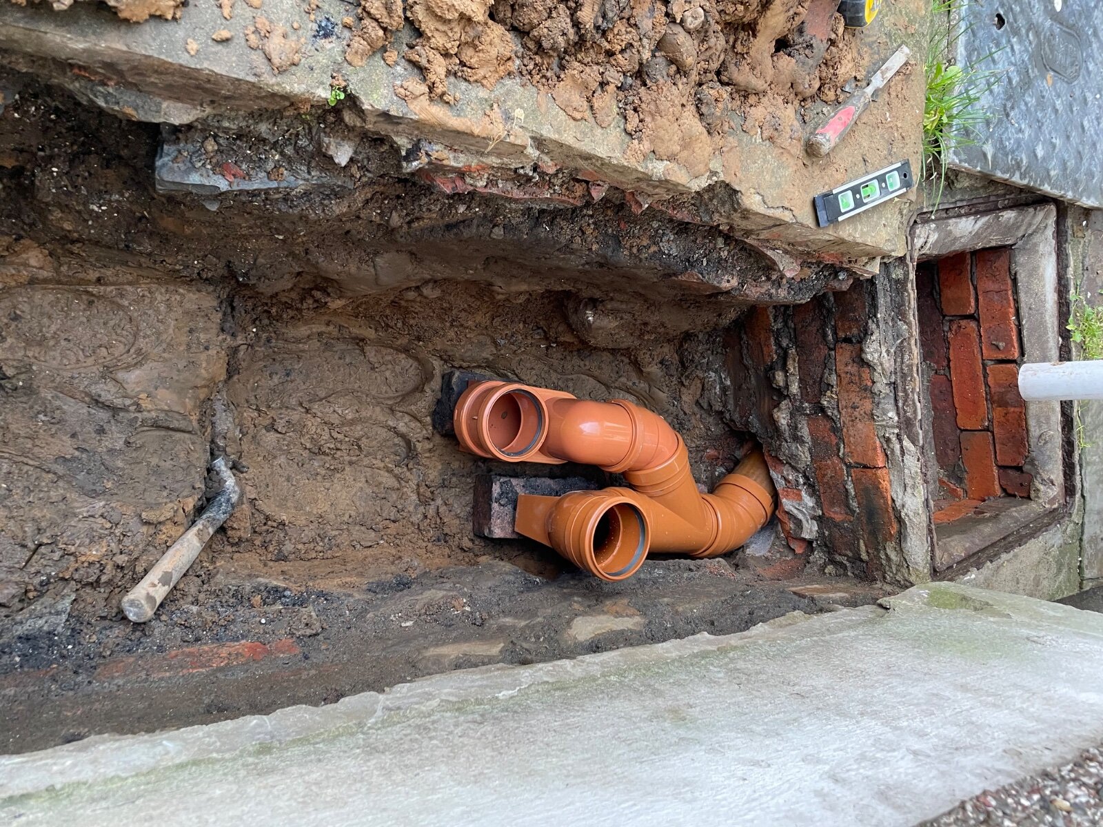

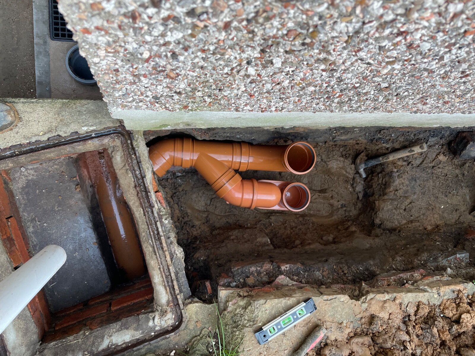

Hi,
thought I’d ask here before jumping two feet in again!
What would be my next steps here?
The plan is to route the p-trap connection behind the rest bend opening to have the ACOs connected to it running along the house wall.
This area will be covered over by decking later.
Original thought was concrete around the opening of the rest bend and ACOs but not sure how to achieve this with pea gravel and type 1 in this area and also two levels (lower where fittings are, higher where ACOs will run)

I'd put a bit of concrete where needed to hold everything in place, i.e. the Rest bend and P Trap, (you only need to go about half way up so they cant move), then peagravel the rest. Seal the gap around where the pipe enters the chamber with some strong mortar.

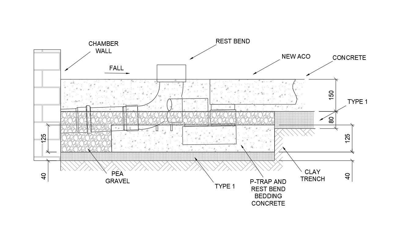

I have another question: I want to channel the rainwater from the left side trench area of the rest bend opening back to the ACOs to the right.
For this area (with no footfall) is it ok to put the concrete on top of the pea gravel?
There's not enough height for pea gravel and type 1, then concrete. I'm just not sure how to layer this? It's almost encased in concrete
I've added another sketch to explain what It looks like side on

If only footfall, then the Concrete doesn't have to be a ridiculous depth, as long as the pipework is secure and wont move, then reduce the depth of concrete to suit.
