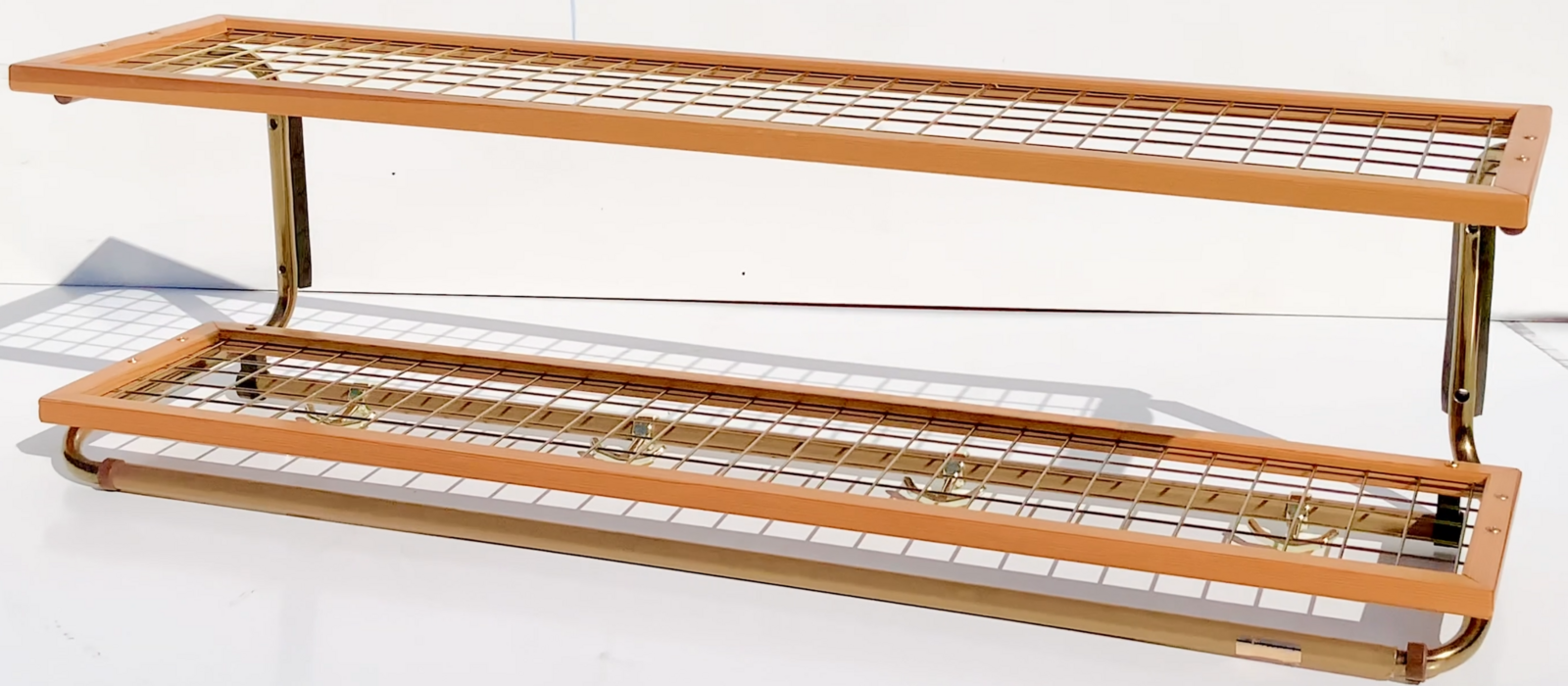

I've got a coat rack which is partially made of steel tubes with a naff-looking brass coloured (sort of) plastic coating, and I want to replace them with real brass. They're about 1m long, one has 5 or 6 hooks for coats, the other is bare for hangers to be hooked over.
I've noticed that some people selling tube for wardrobe rails are using brass plated steel. Is this purely for cost reasons, or is it because brass would bend?
I'd be using 19mm tube with 1.5mm wall thickness, or possibly 16 gauge which is a tad thicker, so reasonably sturdy, I think, but would I be better off using plated steel?
That's assuming I could even get plated steel with an I/D of 16mm - that matters because the ends slide over some other tubes which are about 16mm O/D.
Yes - the whole point of the exercise is to make it look better - it's not a rail in a wardrobe.
It's the rail at the front (and back, with hooks on, but you can't see that very well in the photo) which has the sort-of-brass-coloured plastic coating. Don't think that galvanised tube would be much of an improvement. And anyway, 20mm is too big.

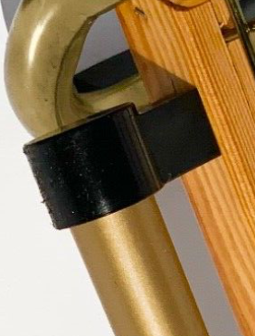

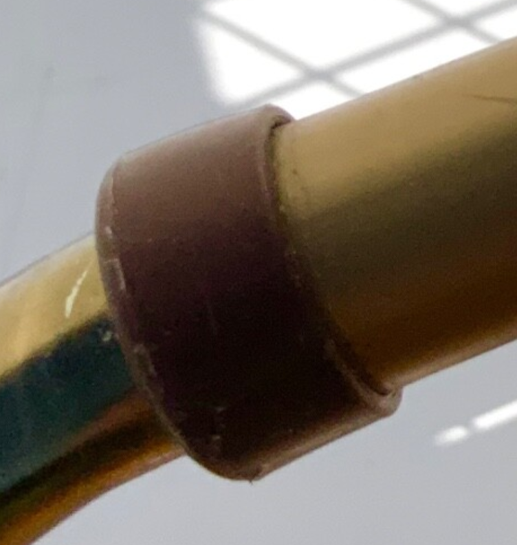

This is why O/D matters:
And this why I/D:

As long as the OD is 19mm/¾" it will fit these:
and as for these:
I'll get some replacements 3D printed anyway so that they are black to match.
