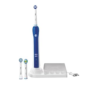

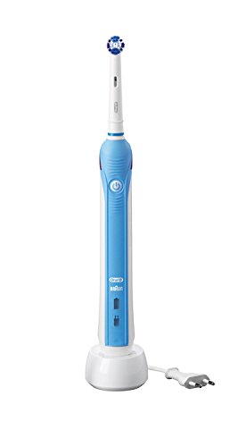

Pointing out that BS 4573 / IEC 60884-1 shaver plugs and CEE 7/16 Europlugs (quite possibly what a German toothbrush charger comes with) are not the same is not complicating things.
A mismatch might be the reason he has to jiggle the plug around.
The charger has the original moulded plug on it, so there is no issue there. He has to jiggle it because the flex has failed at the point where it enters the moulded housing. All he needs is a new plug.

Nor are you, but in my experience failure of the cord at that point is quite common. I would expect the OP to put a new plug on and see if that solves the problem. Maybe he could try plugging something else into the socket to see if the issue really is the charger plug/lead itself.
Yes, it could be the socket into the charging point, but lets take the easy step first.

What I DO know is that the existing moulded plug is not, and never has been, a shaver plug. It is attached to a toothbrush charger as supplied by Braun. So there fore it will be a toothbrush plug.
For a UK product, the plug will conform to BS 4573.
