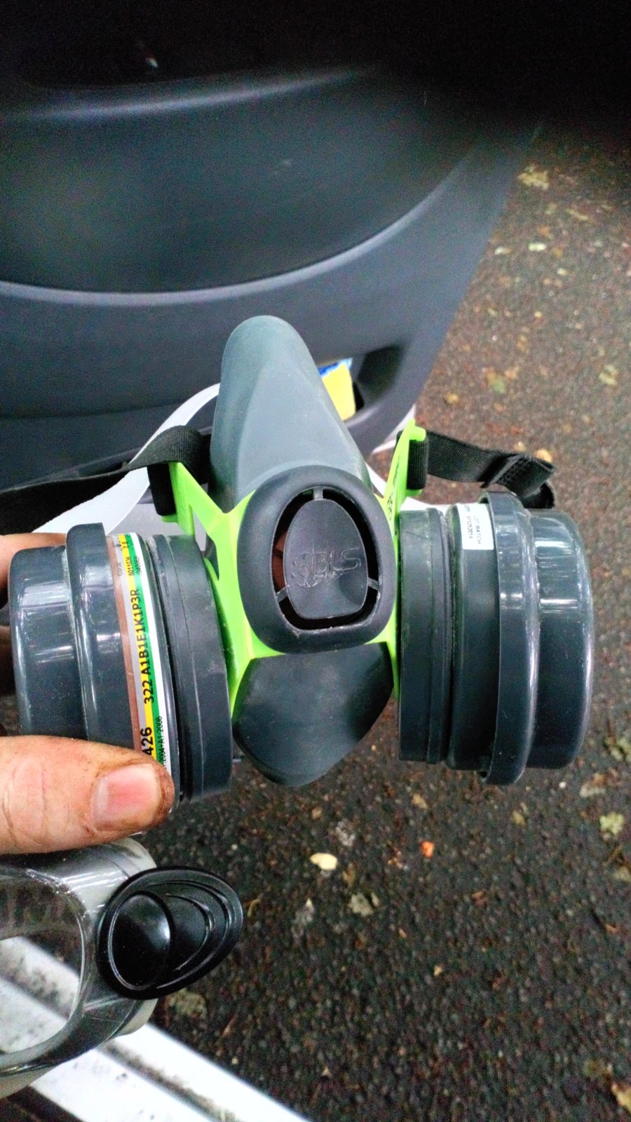

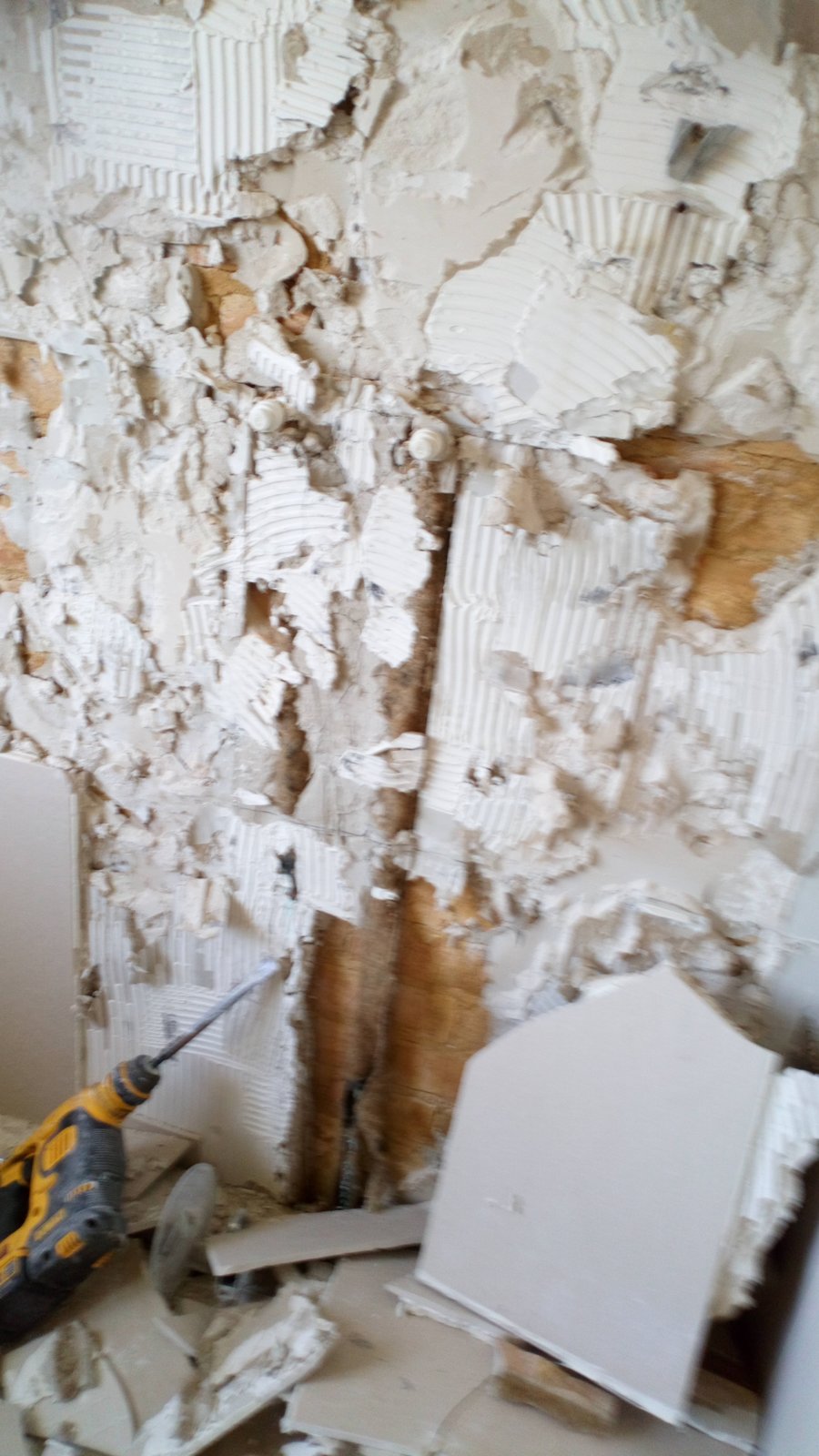

Was knocking down tiles in a bathroom and there was dust everywhere. Wore a rubber filter mask but still had a bad throat for a week. How do you know if its asbestos your drilling into? I heard pipe lagging is the worst what does that look like? A builder wants me to help take up floorboards etc as he's raising the roof on his bungalow.

Is there anything bad in the picture I am taking tiles out? Anything in plaster on brickwork or that hessian pipe wrap on shower pipe, isn't asbestos?

I've had to do asbestos awareness for work and you very quickly learn you can compare it to a picture on Google images all day long and you still won't know.
Usually has to be tested by professionals with lab testing gear if there's any concern. The long term effect of ingesting/breathing this in is death, basically. Doesn't happen over night but it's no way to go from what I've seen.
