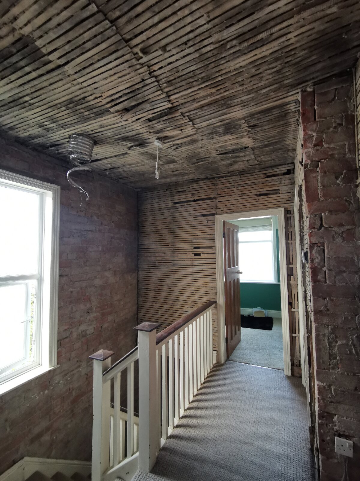

Hi.
So some of you may have seen my other posts on our hallway rennovation of our 1920s semi.
Well it's been back to brick and laths for a couple of months now and we are not getting anywhere!
I had to let our agreed builder go, before he put it back together, as I learnt that it had lime mortar solid bricks and that dot and dab plasterboarding was seriously frowned upon by historical house tradespeople. As it would prevent the house breathing and cause damp, condensation and mould eventually, (at least on the external solid brick wall and downstairs walls, which are on wooden footings with suspended floors).

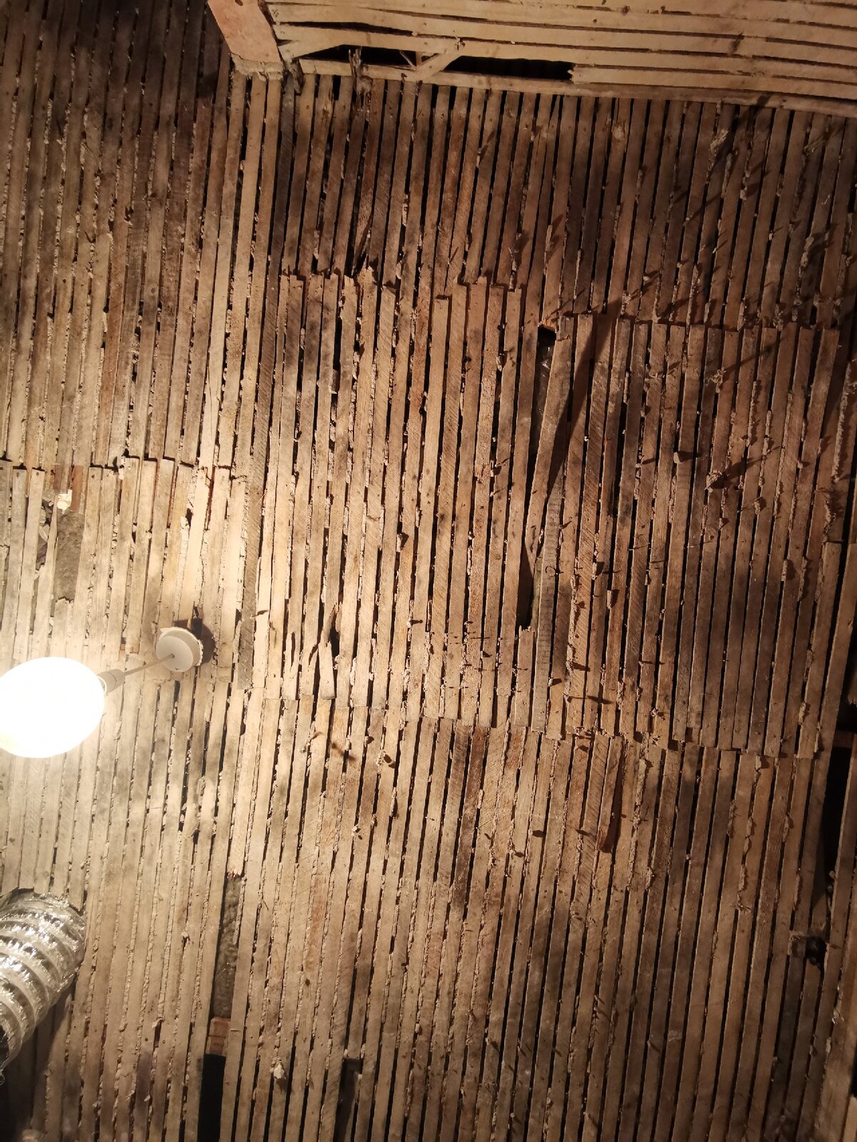

Yesterday, a family friend who's a 'new build' board and skim plasterer in the main, looked at the landing ceiling, and said that the demolision company we hired to do it, has not finished the job, as all the laths need taking down in order to get any plasterboards to sit evenly and not undulate. The laths overlap and are in bad shape.
The demolishion company also damaged the plaster in our front living room wall, from a double socket getting pushed through and also in the rear living room, by yanking off the skirting in the hall, that pulled the door architrave off from inside the living room around the doorway, and all the plaster skim, which I'd just painted.
They knocked out a stair spindle and trashed one side of the front door architrave, which we'll one day have to get remade, or else pull off all the architraves and buy new, which as timber is so expensive now means more cost.
My original intention of posting was... If you've taken down a lath and lime ceiling, would you consider the job to include removal of the laths too? Leaving the joists revealed and the floor above visible (in this case that would be the loft insulation and boarding above (very dusty and dirty with lime plaster debris loose everywhere - dropping all the time)?
My plasterer friend said we'll find it hard to get a Plasterer currently, who'll take them down, as they are all inundated with work and can pick and choose.
We had what seemed a fantastic lime plasterer/heritage House restorer, due to save us, booked for 31st May but he cancelled after been booked in for a month, 2 days before and hasn't recommitted to a new date. I trusted him too come through for us and now have lost 2 months on getting other guys in, and living with it is wearing us down badly now. We both work 5 days a week and have a young child and are knackered at the weekend, plus this is a job that's our of our remit being over a high ceiling staircase.
Do you think I should contact the demolition company and say I'm not happy with the laths having been left in place, and ask them to come back and re-sheet up everywhere and take them down?
We paid 2k for the demolishion, which was for to the artex coating containing asbestos to be removed and ceilings. The wall plaster had blown and cracked in several places so was unsafe in my mind.

You can't hold the original contractor to account because your current plasterer has let you down.
It might be cheaper to get a quote from a builder to remove the laths and overboard, as it might not be a job a plasterer alone would want to do. You could remove them yourself working from the loft.

Well I think we're going to have to try and do it ourselves and ship out daughter out on a weekend!
The thing with the loft is it has old dusty fibreglass insulation in at the moment and we didn't want to move it until it starting sagging through having taking off some laths. I've seen a really long wrecking bar you can get but I still will need to invest in a few hundred worth of equipment such as stair platform, ladder, tarpourlin to catch the debris...
Just seems like part of the original job really, to take down the ceiling. The original contractor finished a day early yet charged us am extra day to do the ceilings of £600. We didn't know what state they needed to be in though for reboarding and we want to use wood wool board and lime.
Thanks anyway!
If your really against stripping the lot down yourself then you could possibly fit some timber along the tops of the walls then run new 'joists' across the old laths between the wall timbers and then use those to fit boards to, you'd end up with a lower ceiling height but I doubt you'd notice as there quite high currently
Take a weekend, go in hard and get all the lathes down, and the old dirty insulation.
Go to town on it, get it into a burnables skip, and shower 5 times.
Then plasterboard it all (Or get a builder to), and roll out 100mm of new insulation out, and 200mm the other direction, early in the mornings before it gets hot. Or wait for autumn.... but ideally do it before it gets plastered in case of any accidents.
Trades do seem overloaded, and so can pick and choose.
It's tough with kids I know, but do-able, and the sooner you do it the better you will feel. If you get as far as plasterboarding and then can't get a plasterer, at least it will be clean and light. We had plasterboard exposed for 6 months in some places, you get used to it.
It is quite hard work and very dirty and dusty to remove lath and plaster ceilings. Really a job for a building labourer.
Most plasterers only want to be fitting new plasterboard and doing new plastering and not what they probably see as a labourer's job.
Many will just nail plasterboard over the old lath ceiling but that is a bit of a bodge although saves a lot of cost.

To access a high ceiling over stairs what you can do is build a temporary "scaffold" out of 4x2 to support a couple of builders planks resting between the landing and across the scaffold creating a temporary floor - it's a little bit better than the plank and ladder approach and can be full width of the space and a 2-3 planks wide - it should be solid enough for you to use hop-ups etc from it.
Pull it all down, refix PB securely with screws, adding noggins on joints as required. Ready for your plasterer.
