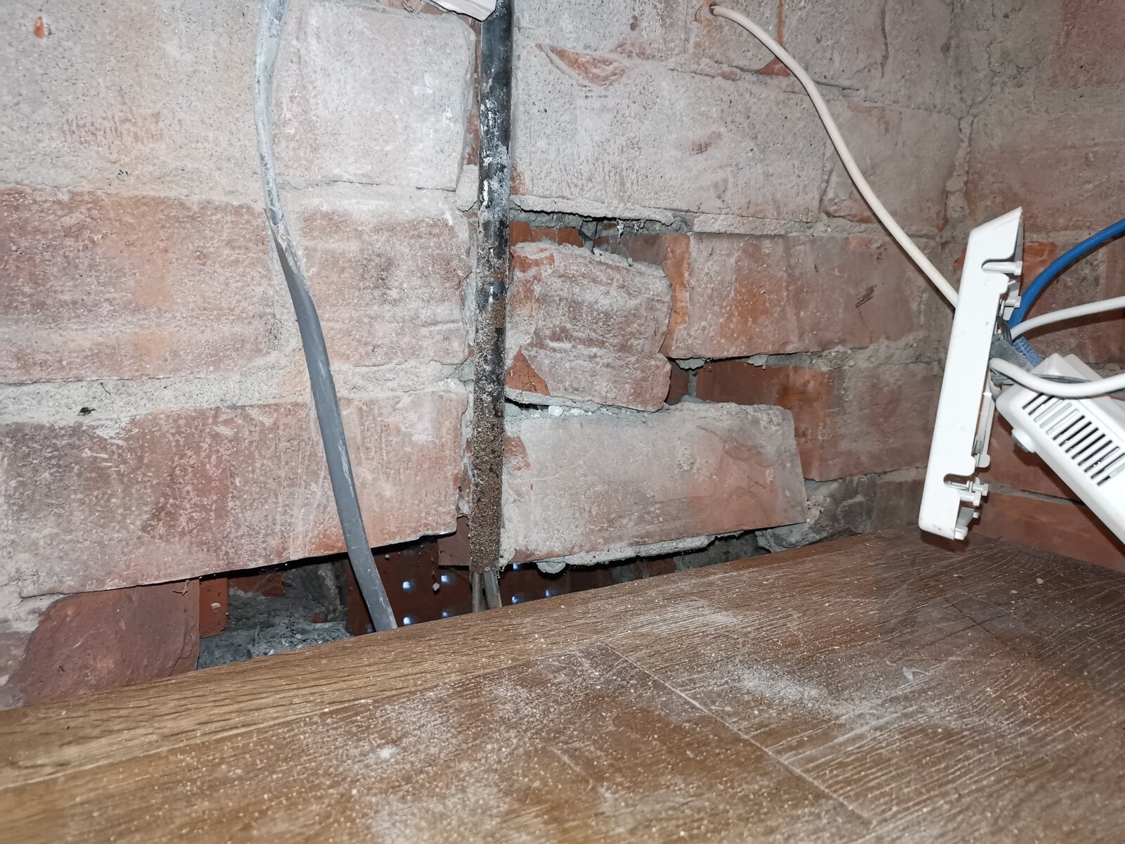

So we've had the hall and landing taken back to brick as the original lime plaster had blown and cracked badly in corners or was hole sounding and was coated with a Chrysotile artex skim that was damaged in places.
We had a professional asbestos company do this work a few days ago, who fully sheeted off the area and used a wet removal product on the artex first, plus double bagged and disposed of it all correctly. Had the old skirtings removed too.
Now we're dealing with a new problem of living in what feels like a derelict house with radiator removed in the hall so it's freezing in there! Electrics are hanging everywhere.
The external wall up the stairs is solid brick and north facing but is fairly sheltered by the next property that also reflects a lot of sunlight onto the wall due to there's being painted white.
I was hoping to take this opportunity to insulate the walls and ceiling before plasterboarding over (our plasterer insists dot and dab is fine for this with batten and board for the ceiling.
However the space between the stair string and brick is only 25mm and to insulate would need 40mm in total, due to 25mm insulation board plus 12mm plasterboard and 3mm skim. We'd therefore need to have a faux stair string made and lose stair width. Our plasterer said this would be very expensive and beyond our already heavy spend.
He said once we get it all boarded and the holes closed in the landing ceiling (old defunct air exchange system, which was taking heat away) to be removed and an insulated loft hatch fitted that it will be much warmer. But our energy and heating bills are very high! £6.50 a day in cold weather!
Also there are deep voids between stud walls of lath and plaster of empty space. Would it be a good idea to put insulated board in between studs? Would that help retain heat in those rooms?
If at the bare minimum we batterned and insulated just the area around the front door and later got a composite door, would that help retain heat?

That's a lot of north facing wall. Long-term it might be cheaper to move the stairs a few inches so you can get 50mm insulation board in there.
I'd love the budget to do that but the best we could possibly afford is to build the fake string with 25mm insulation. It's just our construction plasterer guy thinks that would be well over our budget of 4k. I almost wish we'd just scraped the asbestos artex coating off but it was cracked and hollow in quite a few places and holes in the upper ceiling with patterned plaster we couldn't replicate.
Is external insulation an option later on? Maybe focus on making it all good and then insulate on the outside when you've saved some more money. At least it is getting warmer now.
Or be pragmatic and use 10mm insulation? No idea how that compares to 25mm in terms of u value. However, its better then what was there (none).
Anything is better than nothing - 10mm might be enough to ward off condensation and black mould - I've done that around window reveals.
If doing 10mm I'd still be looking to insulate the external wall later on if you plan to stay in the house for a while.

When starting my renovation I was told by celotex to keep a void between the bricks and the insulation. Any damp (If there is any) would wick its way through the brick Ending up outside. After all, you don’t want it inside.
There’s a few posts on here not agreeing with this method Saying it should be directly applied so no chance of moisture forming, 4 years down the line all seems well.
I chose to reduce my stair width and insulate, and I remade the stringer from plywood, and made a template from around the treads/risers and used a jigsaw. It cost £25 for the wood.
I know what old properties are like to live in, usually cold, insulate as much as you can, sort drafts, do the floors, fit better windows/doors budget permitting.

Personally, last time I gutted a house, I removed all the old wooden laths prior to boarding.
All bits of plaster need removing.
You don’t need to insulate any internal walls.
