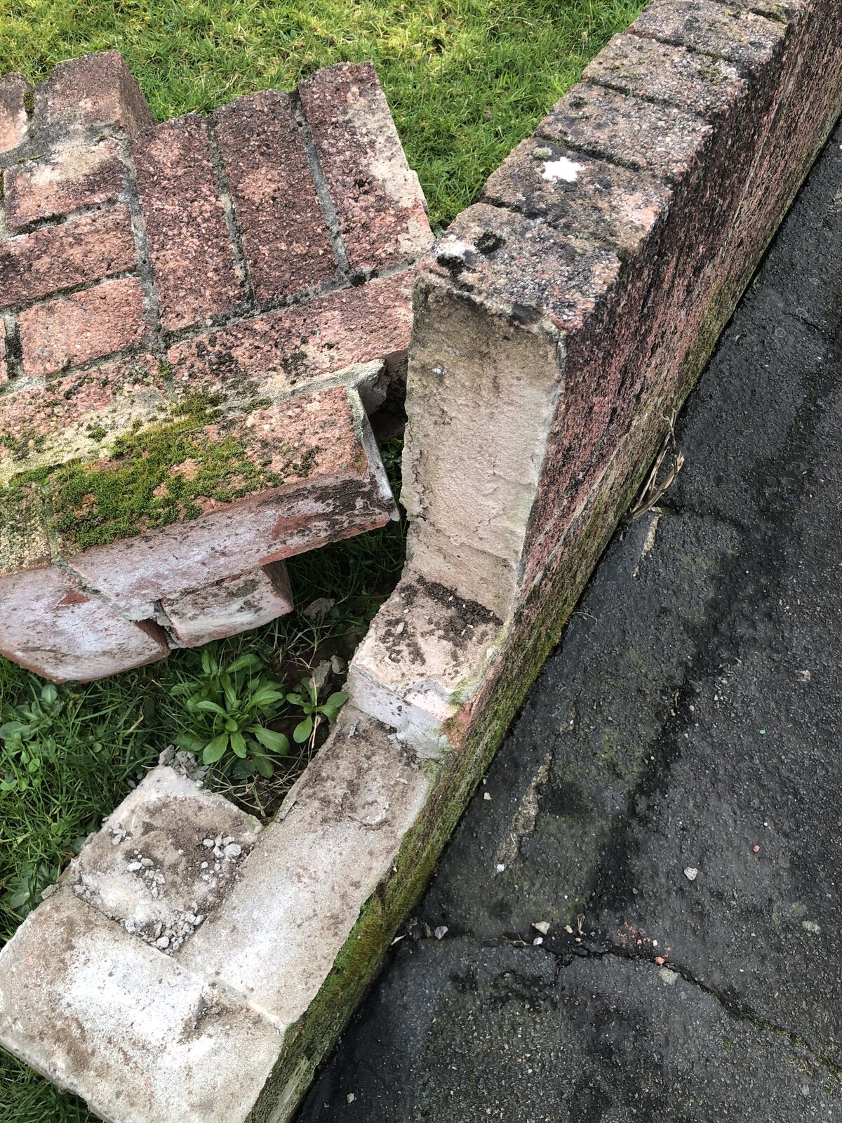

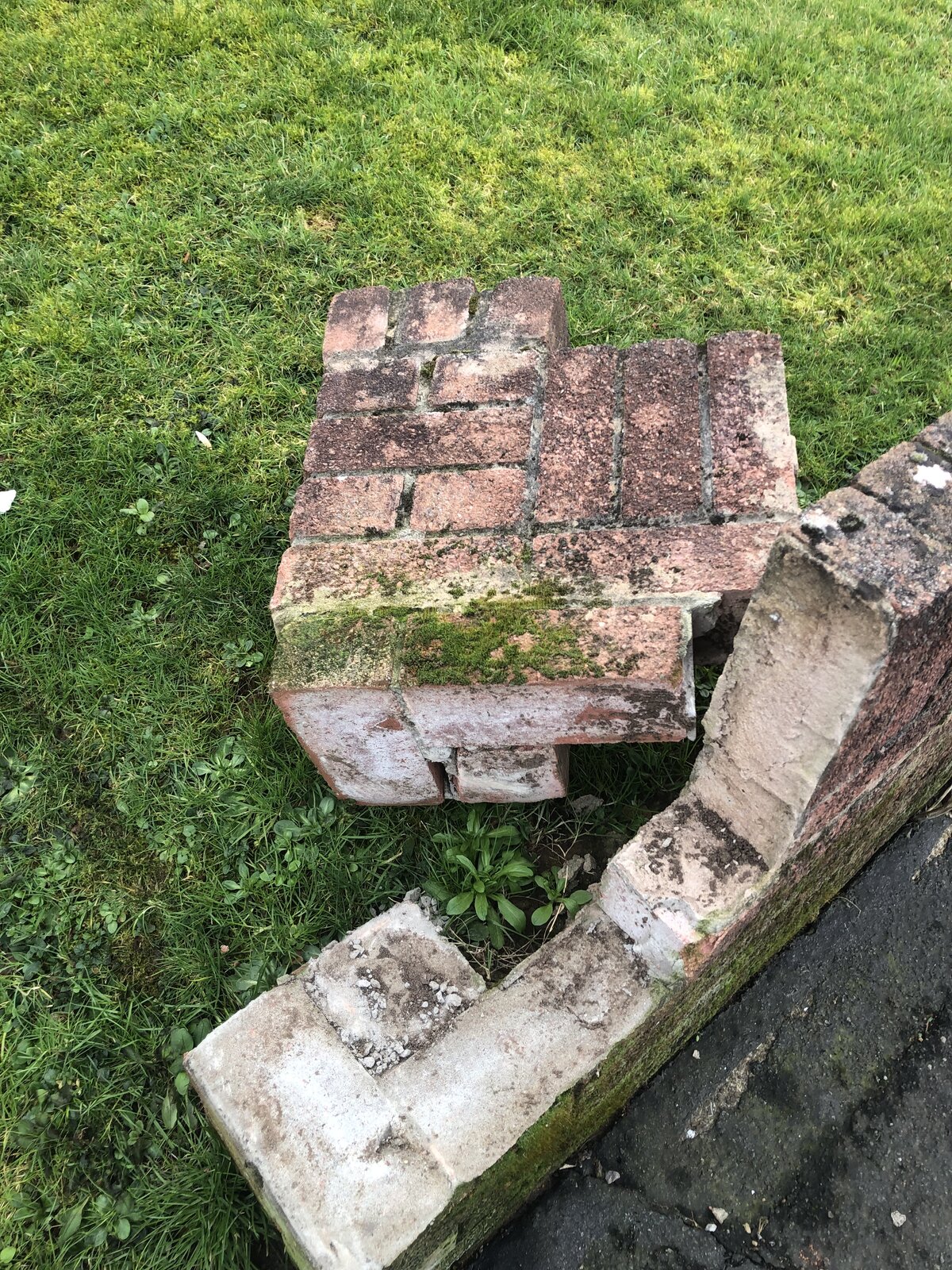

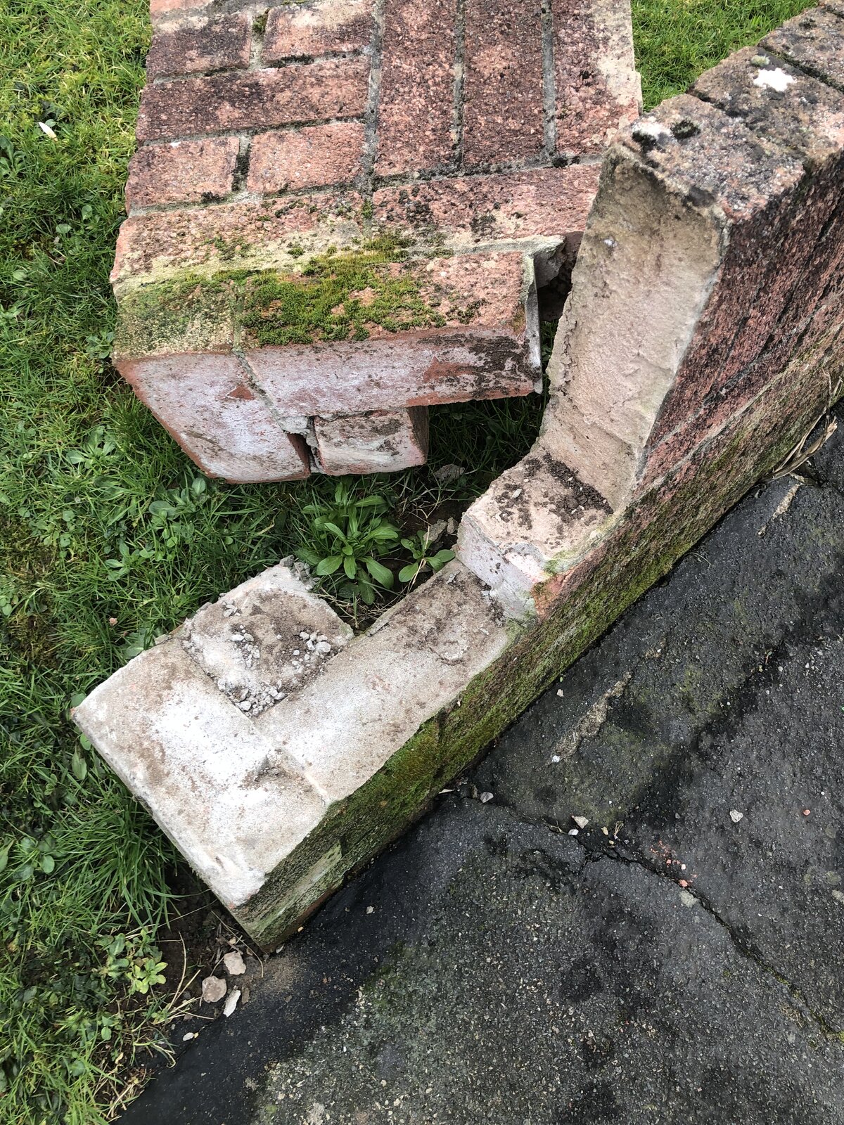

A bit of the wall was knocked down by a car. Is it ok to put back the whole bit back with new mortar?
Seem silly to break off the block apart. I was thinking of chiselling the old mortar around the broken bit and settle it back in place with fresh mortar

In the past, I have used MS polymers to glue bricks back.
Eg- clear Stixall
I have used it in situations like yours.
It has held the corner pier on my own wall for the last 10 years. I didn't remove any of the mortar.
If you try it, wait 3 days and kick the corner to make sure that it is strong enough.
Why not it's just a large odd shaped brick.Possibly put a couple of10mm spacers underneath to stop it squishing the mortar out, and a pair of helping hands
