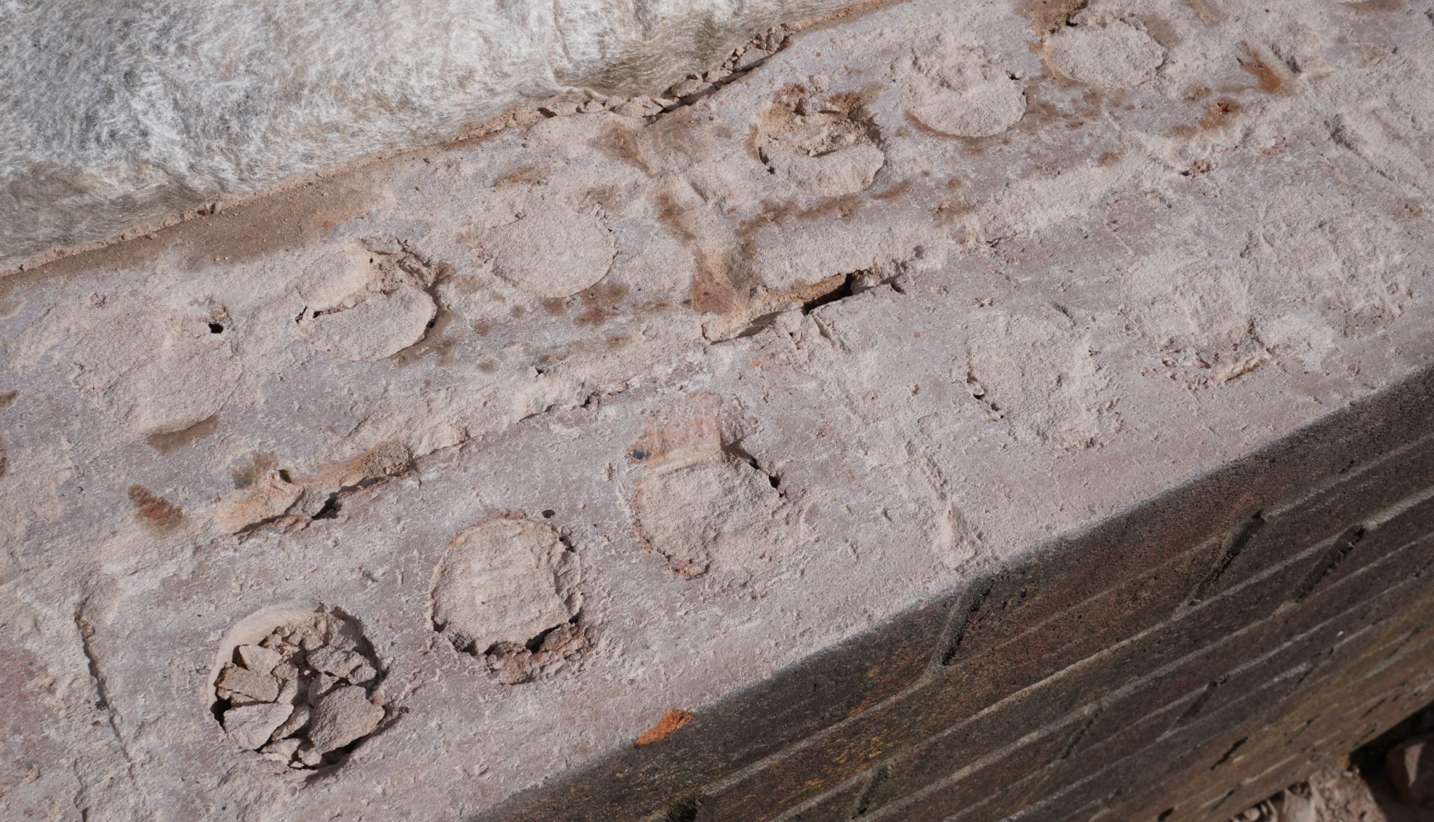

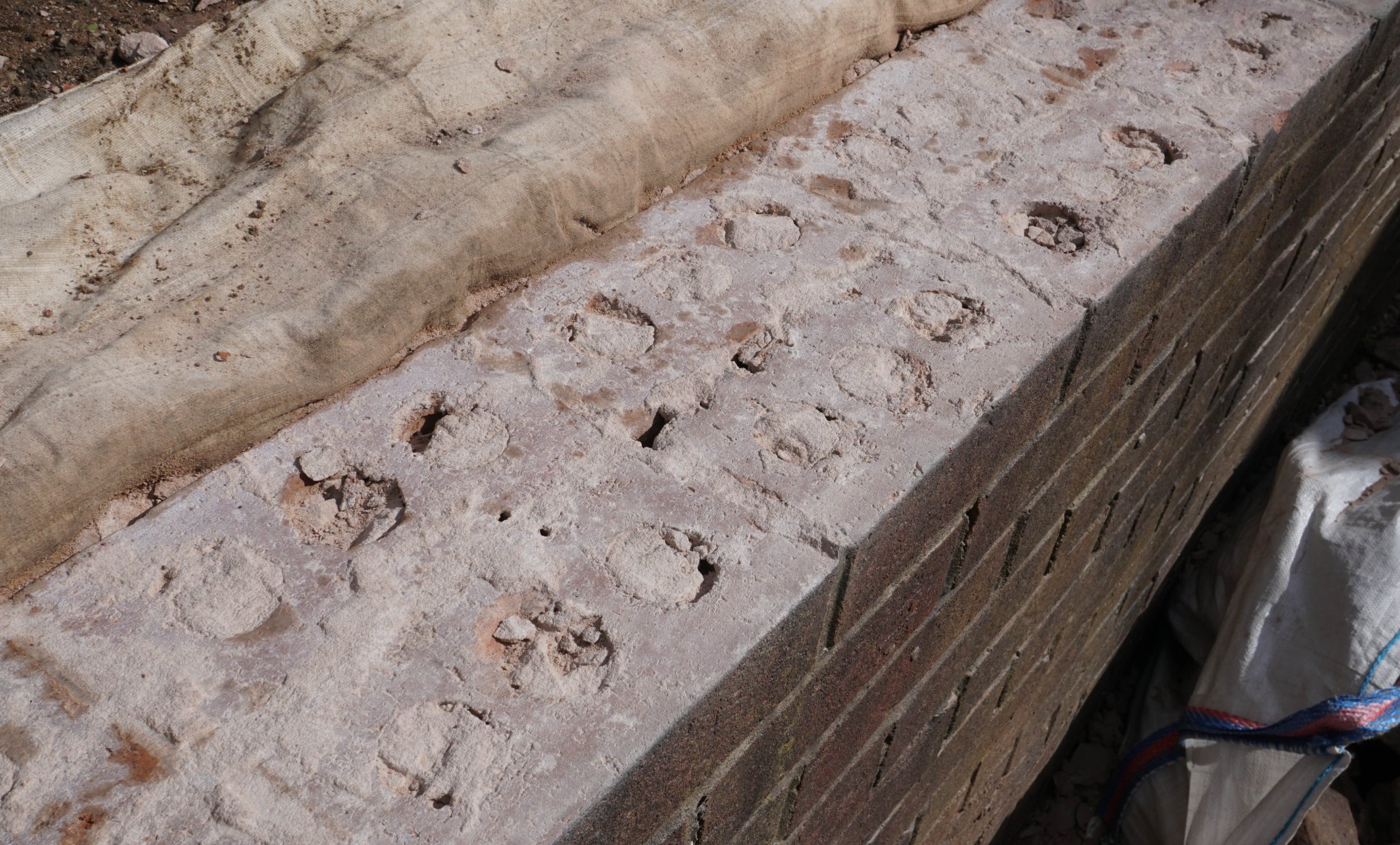

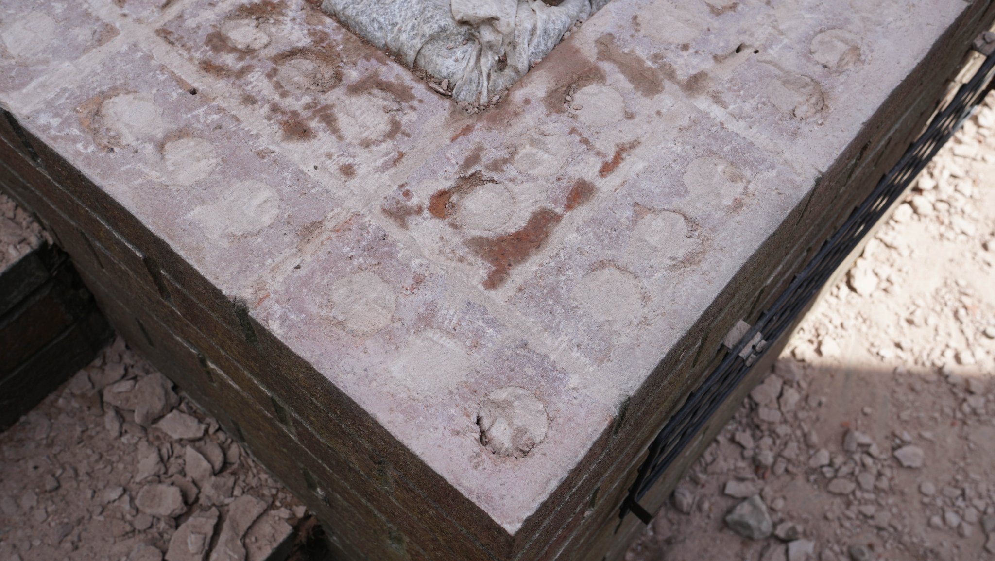

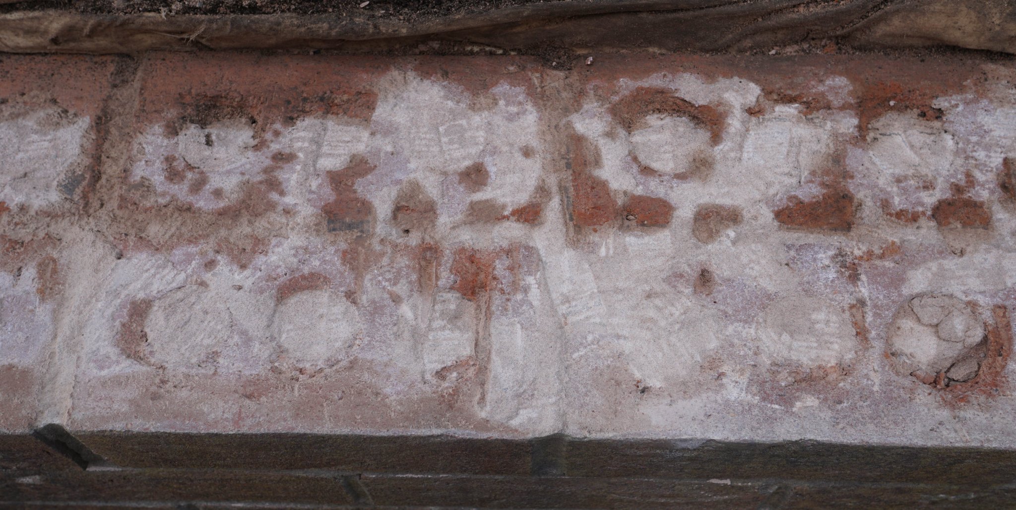

Hi,
I am replacing top row of bricks in garden wall, old bricks were damaged and splitting.
I have removed old mortar and everything is looking like per photos.
Does my prep look ok, is the wall clean enough to lay new bricks on top? I am planning to vacuum this once more time before I put fresh bed of mortar and wet the surface.
Thank for your help.

Sterile. (y)

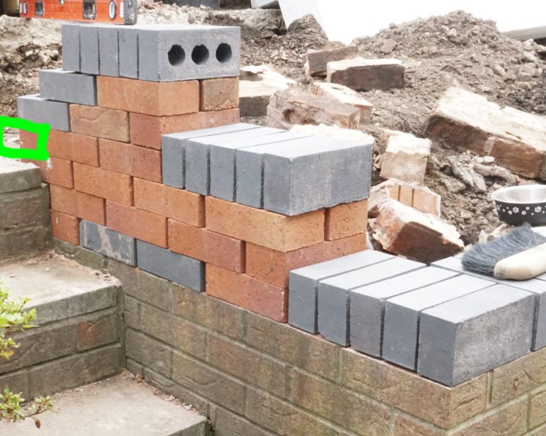

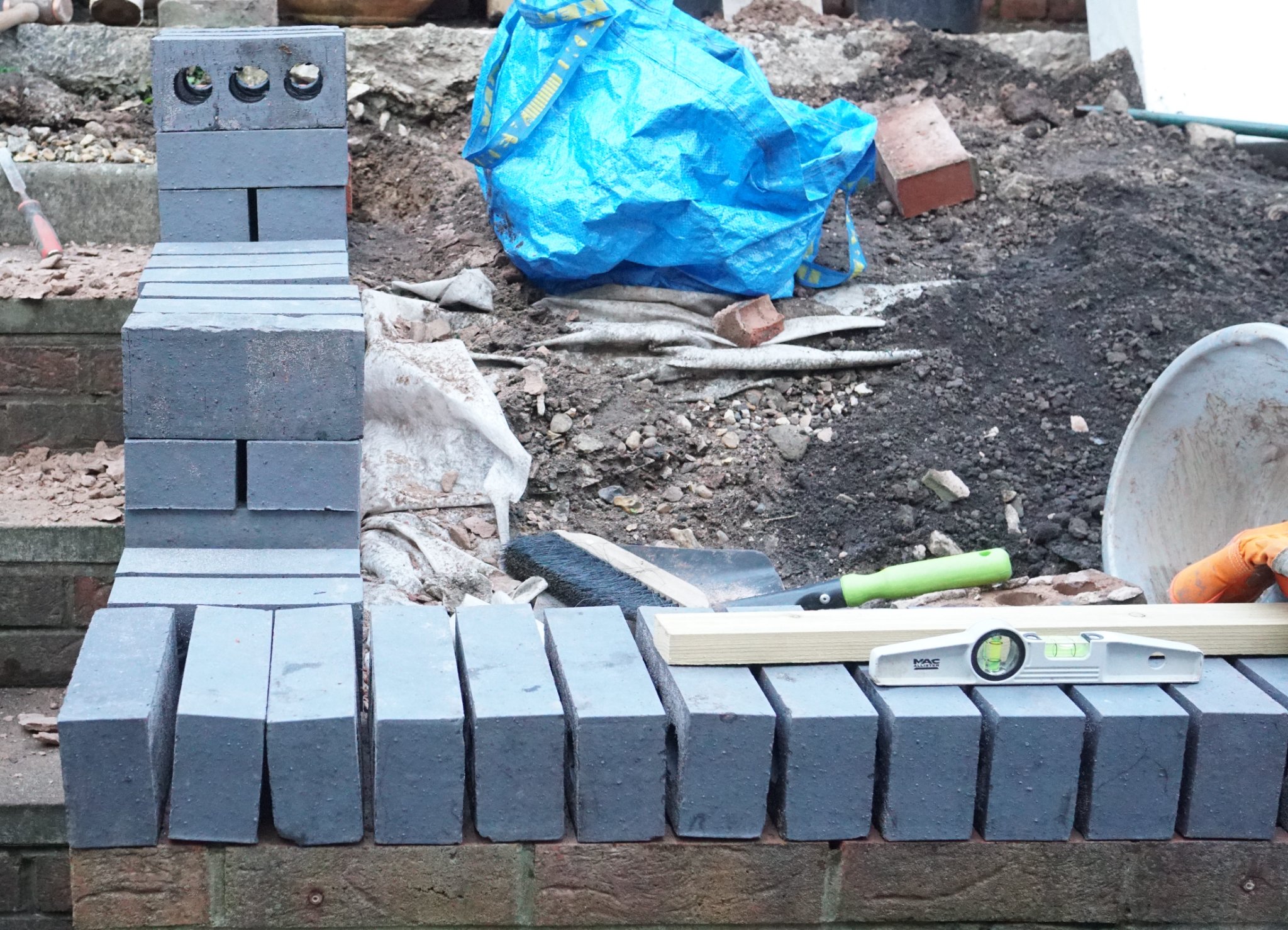

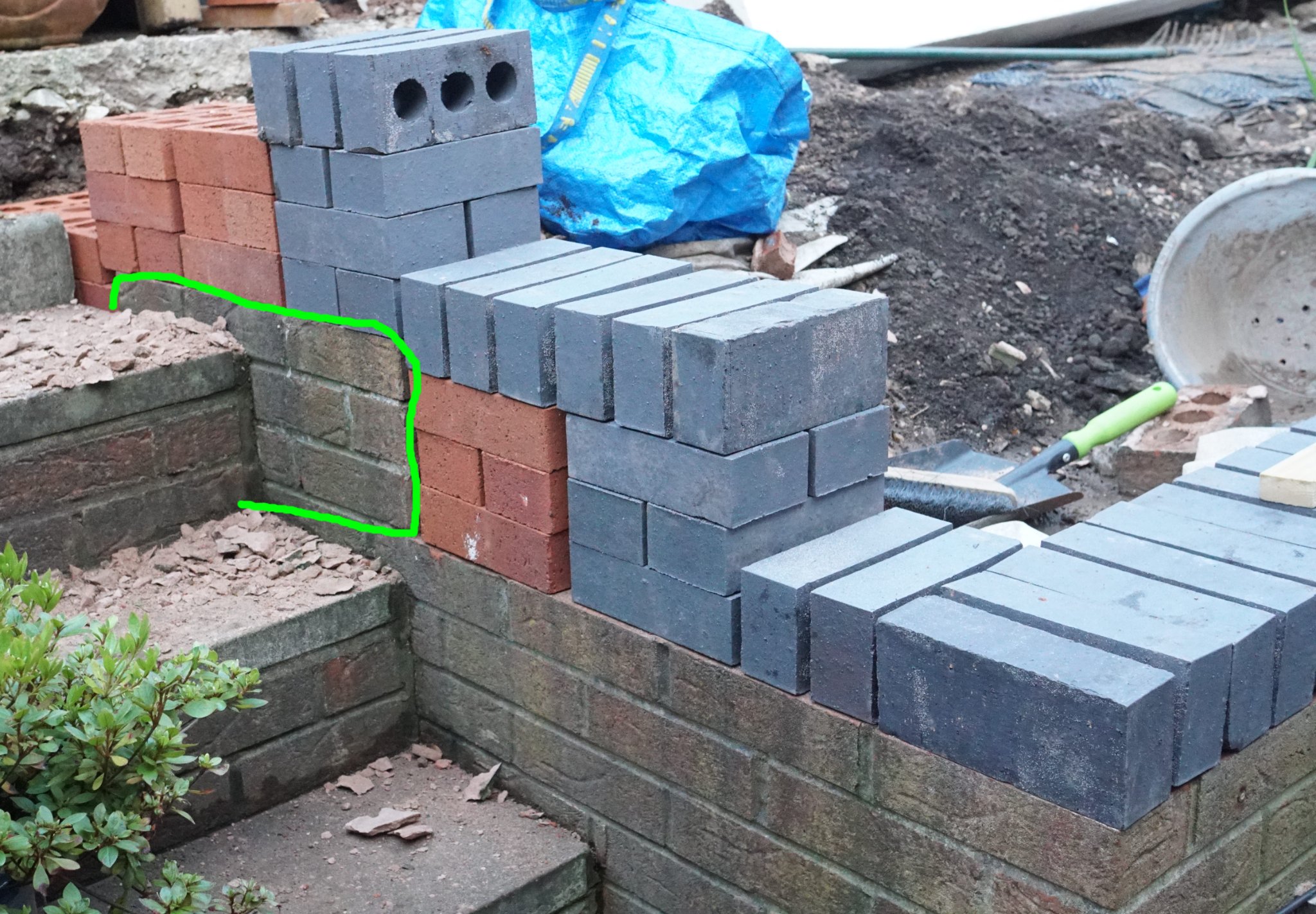

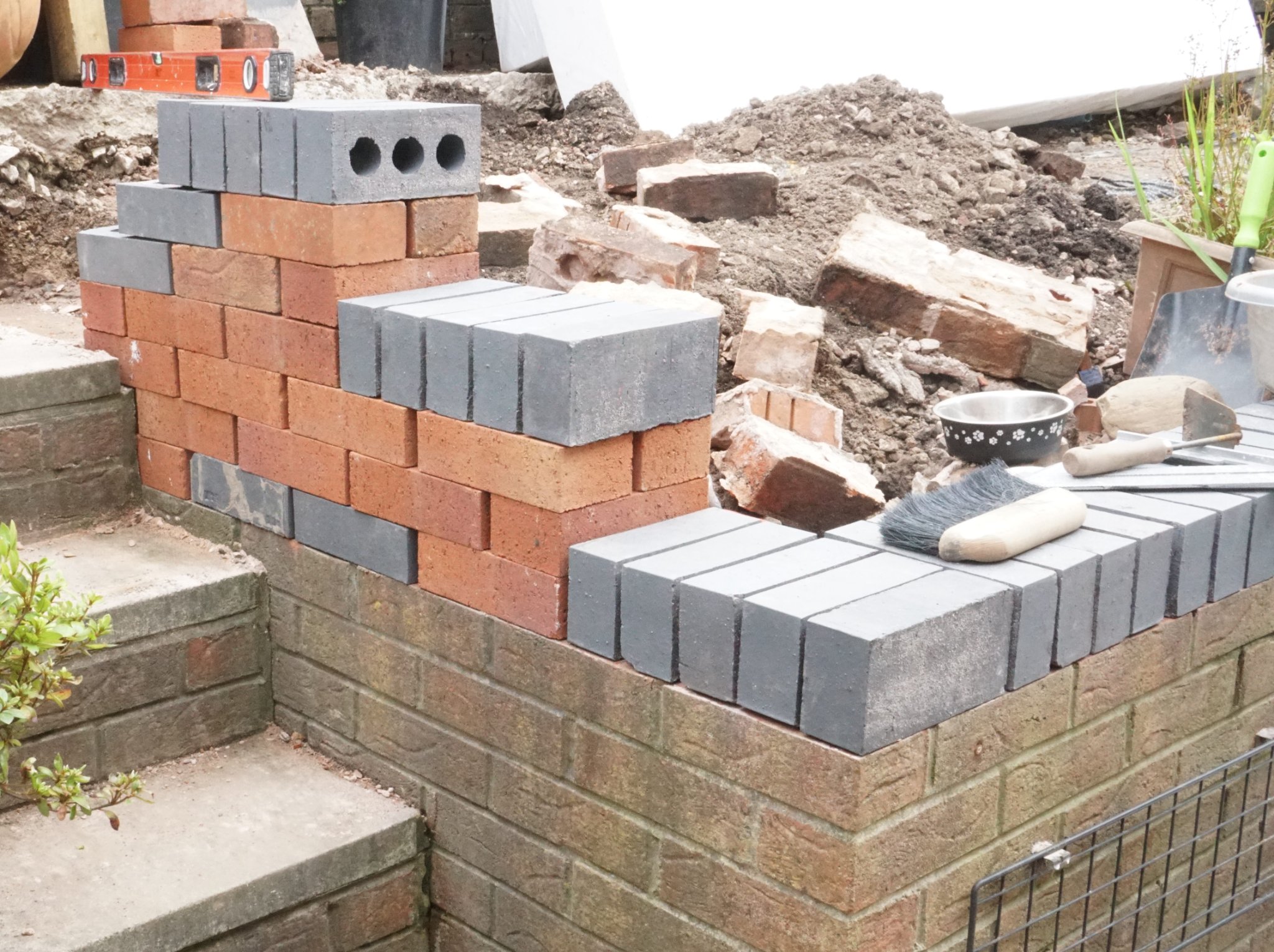

Could you please let me know if my idea is best case scenario for my wall? I need to bould extra few corses, wall is next to stairs in a garden. I will have to change brick bond as I want blue brick to follow nicely all the way to the top. The highlighted green brick wall will be changed to same bond as per my photos.
Do you guys have any other suggestions, maybe there is a better way to do this?

Are you happy with a straight joint of 3 courses plus the brick on edge joint? You could tie in with the blues instead. You could also mitre the corner brick on edge.
Thank You, earlier this morning, I realised the the long joints by looking at the photos again, so came with final solution, I hope. I was thinking about mitring the incline, but then I liked my latest brick layout, and it is simpler for me to do. What do you think?
The blue brick on top will go all the way to the foundation (together with the rest of the wall), the blue brick inside the wall ignore, just run out of red bricks.
I meant mitre the corner like this.
To my eye the stepped end (left) lookks wrong and why 2 random blues down low?
Stevie, the end is not 100% correct on photo, I had to put one brick to stabilise for photo purpose, but it will carry on as per this edited photo, basically it will be stretcher bond all the way to the foundation. So 4 top courses will be stretcher all the way, not including blue ones which will sit on top. The random blue bricks are there because I don't have any more red ones at the moment.
Stuart, do you mean mitre like this:

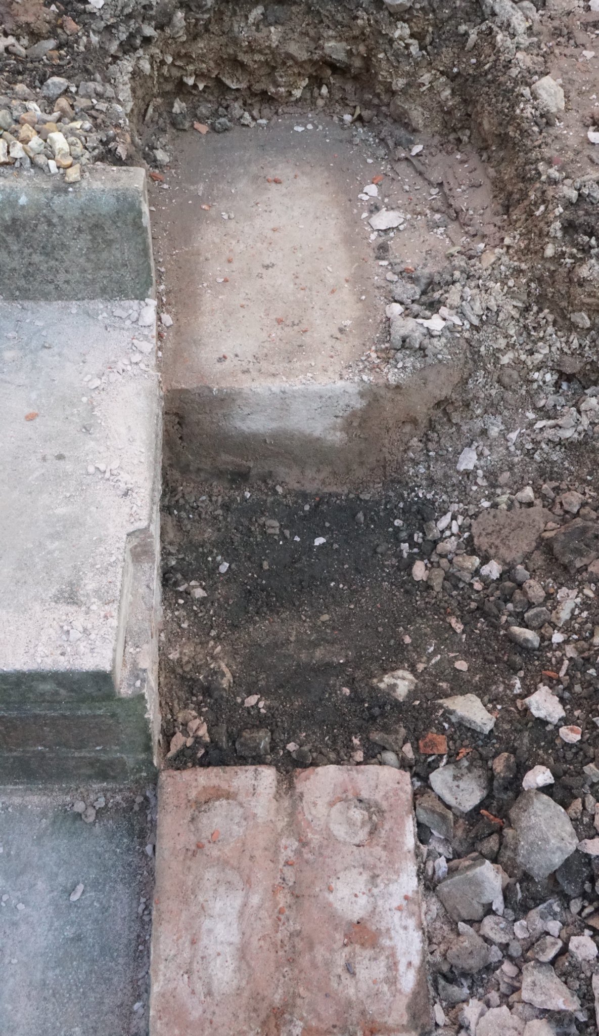

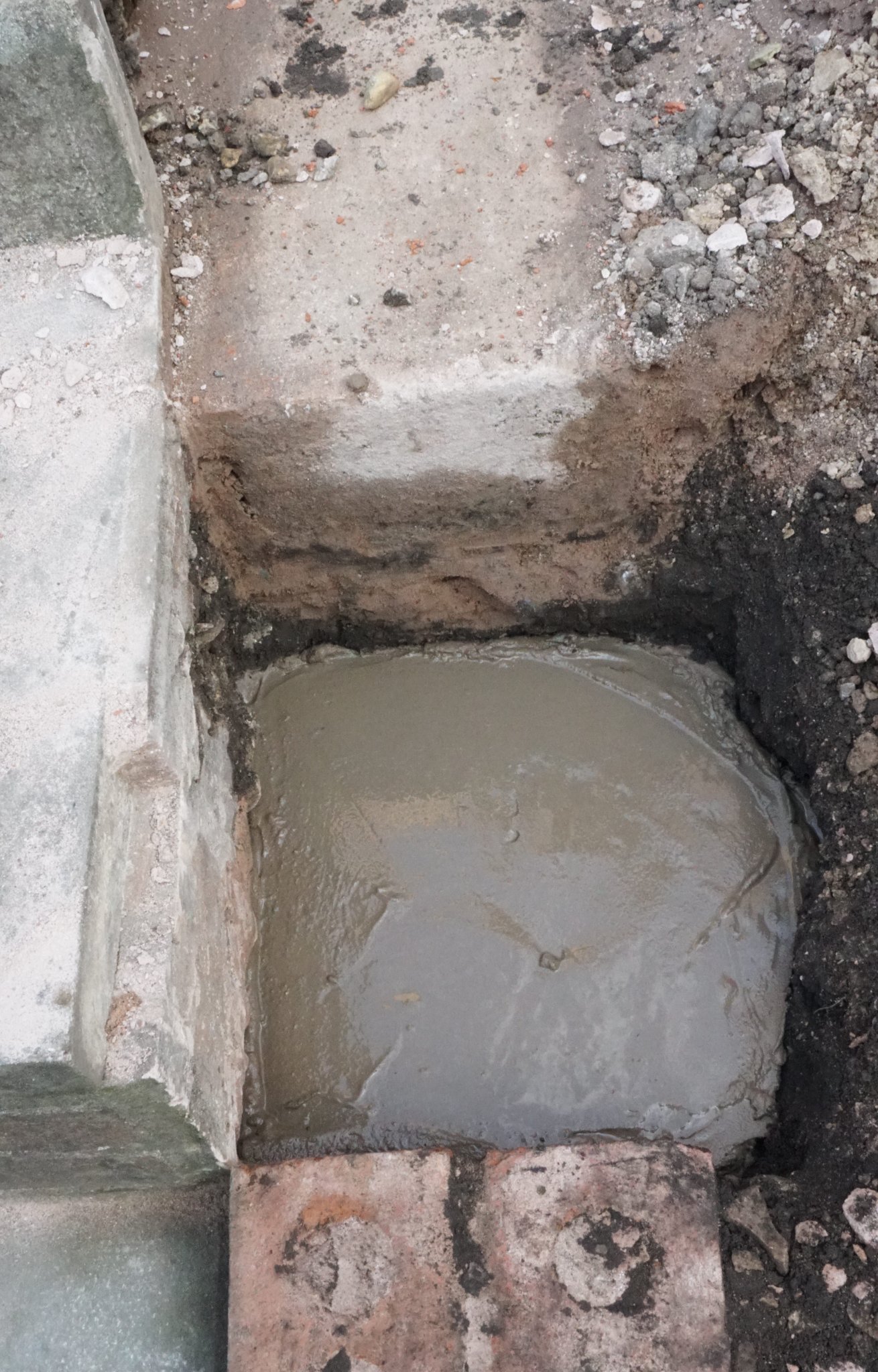

Also, check this out, few bricks were just lying on dirt, the block closer to foundation is something I did yesterday, but after removing old wall today, I did not expected to see just a dirt under the removed wall!
Thanks guys :)
Update, 20cm concrete poured, much better!

Yes, it's an alternative method of doing a brick on edge at the corner.
Yeah, I like this method, I might try it, need to get diamond blade for my saw. Thanks a lot Stuart.
