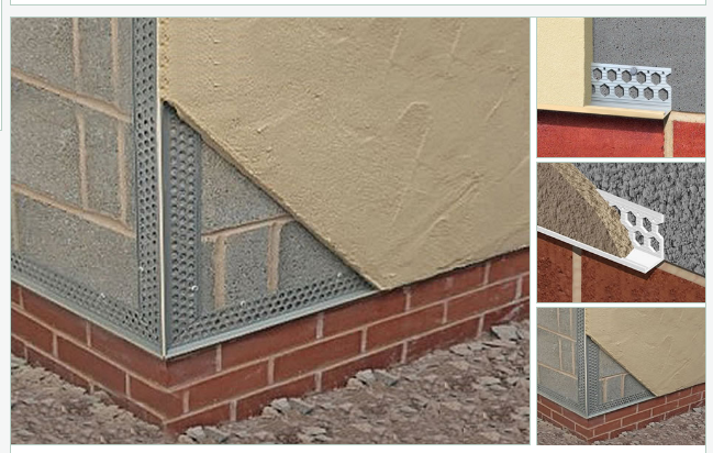

I understand this is the type of thing they are planning, using an external bellcast bead however the bricks will also be rendered but they will be recessed by 15mm from the rest of the wall, DPC and bead will divide, not sure how acceptable that sounds though.

@Rocky1000 Yes that's what they will be doing but apart from having only 3 bricks above ground level you'll have 8.
Get them to knock the outer skin down and start again, put up 2/3 bricks above external ground level then add a bit of dpm as a cavity tray. Weep holes in the course above the dpc. If you look at the vertical joints in brick work they should all line up with the matching bond below not be all over the place line in your wall.
I know it's not what you want to hear but it's much easier to fix this now. I'd also keep a keen eye on your builders if this is the quality of work they think is acceptable.
Thanks tomfe, I take your point, however the brick work will also be rendered with bead dividing DPC, not sure how much of different that makes but I will discuss with them!
You can't render over the dpc, you'd have to put a bead above and below the dpc.
Hi, yes that is what they are planning I believe to match the rest of the building, does this sounds acceptable???
