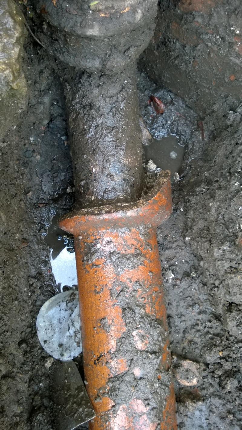

Thanks to a blocked drain getting power jetted, I have discovered my drain is broken and leaking.
The break is where my cast downpipe/wastepipe joins the clay/stone drain. The collar is broken and when I looked at it, there were rags wrapped round it and jammed into the gaps. They weren't working.
I have packed the gaps with putty just now so that we can at least flush the toilet but obviously I have to rectify it ASAP.
I don't know how far the main pipe goes so I don't know how much pipe would need to be replaced, if the whole thing needed replacing. But my question is, can this be sorted without replacing the entire stone pipe?
Whatever you do work carefully, both cast and especially the salt glazed (clay) pipes are very brittle, and disturb the salt glazed too much and you will end up replacing more, often the surrounding soil is all that is holding it together.
I'd start by carefully exposing as much of that broken collar as possible and give yourself enough room to get access with an angle grinder. Carefully cut remainder of broken collar off where it meets the pipe, assuming it doesn't crack the pipe, then you should be able to join the cast back to the clay using a Fernco type collar. Rubber sleeve with jubilee clips, slip it carefully over one pipe, then slide it back to cover the join and tighten clips to seal.
If this wont work, then use 2 Fernco's and replace the clay as far as required with plastic, (you'll still have to chop a collar off or cut a pipe to achieve a spigoted end to connect to though.) Wherever you cut, grind off any sharp edges to avoid material catching in the drain, treat cut/broken clayware with caution though, edges can be as sharp as broken glass! :eek:
Excellent, thanks for that. Sounds like a silly question but how does a collar connect 2 pipes of such different diameters? I had always understood those collars to connect 2 identical pipes.
Need to get the right coupling for the application. Fernco make a sizeable range, with different diameters at each end to suit such requirements as this. Measure external diameters of both pipes and take them along with you to help size what you require. :)
That all sounds a bit straight forward :) the cast enters the pipe at a slight angle - could the coupling cope with that?
Also, can you get these from local plumb stores?

Thanks again. I've just been outside and it has spewed all over the shop so I need to do this urgently. Will try sleeve.

Couplers are rubber, will cope with slight flexing. Will need a Builders or Plumbers merchants, wont find a range (if any at all) in DIY outlets.
Temporary fix, wrap a plastic sack, (type you get sand/ballast etc in, not a bin liner!) around the break and secure it with decent twine or wire. Should stop the worst of the mess until you can fix it properly. ;)
