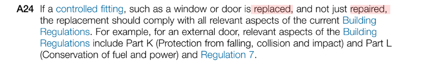

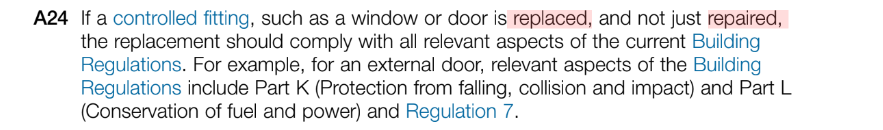

I hope you realise that you have to be replacing the whole window including the frame to require a building control notification. Just replacing the glass or openers is a repair - no BC involvement needed at all.
Thanks Noseall. Mr rusty, they are replacing the wood bit that the glass is in but not the whole window frame as such. Thanks
Oh Blimey! All that worry for nothing. Seems I have been misinformed. Thankyou
The guidance for the building regs from UKGov is attached. https://assets.publishing.service.g...4ff12/Manual_to_building_regs_-_July_2020.pdf Note it says regs only apply if the window (controlled fitting) is replaced, not just repaired, so e.g. if you have a window and just replace the openers and not the frame, that's a repair. It's always a little tricky to track this info down because of course anybody attached to the industry always tries to promote replacement.
If you have sash window and replace the sliders = repair. However if you install a complete uPVC window inside the old sash box frame then that would be a new window (stupid idea though).
