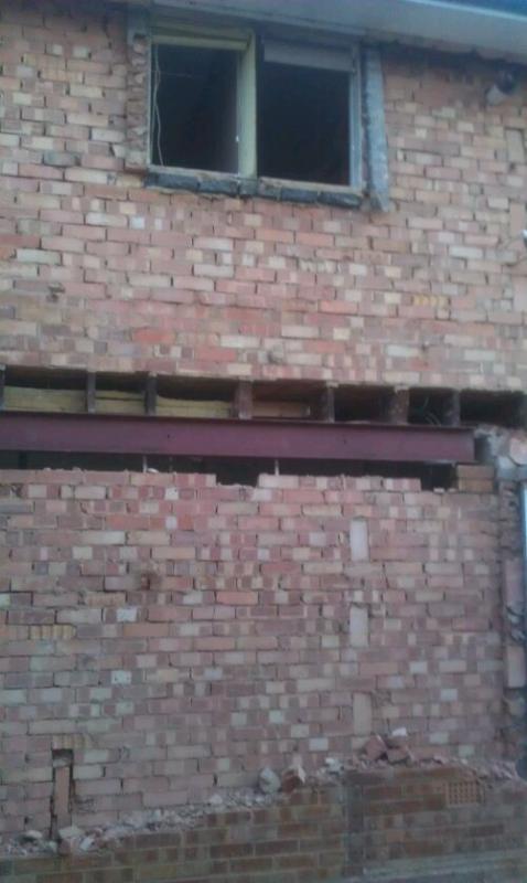

I've recently had a two storey extension completed on my house. During the build process, my builder asked if I wanted the outer leaf of the old external wall removed (now an internal wall) to create extra space. I agreed.

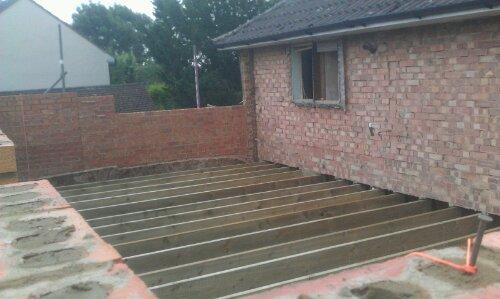

The floor joists for the new 1st floor and the old first floor sit on this single skinned wall. The joists from the old and new parts of the house don't appear to be connected to each other or to the wall. The rectangular spaces between these joist are empty - to allow space for wiring and pipes etc. I would've expected most or all of these gaps to be filled in with brick, so that the wall was a single wall, rather than a downstairs wall with some joists on it with another wall on top of the joists!

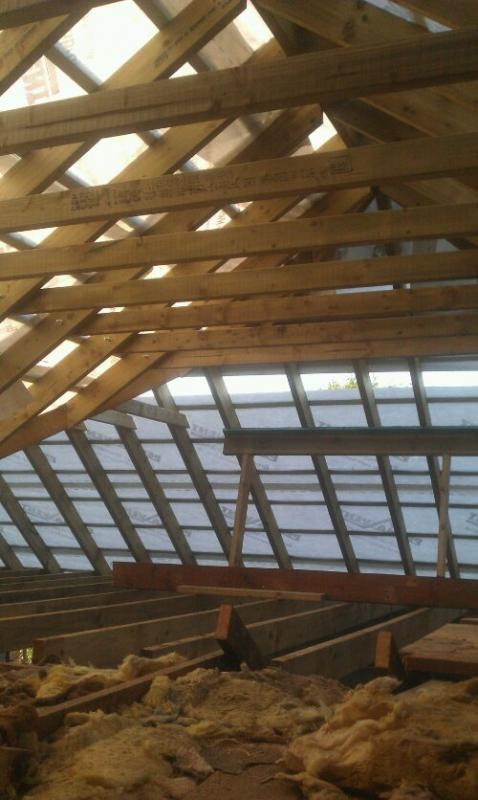

The whole setup seems vulnerable and flimsy. I have visions of the upstairs wall collapsing and the roof joists sitting loosely on top collapsing into the bedrooms (there are no roof purlins connected to the ceiling joists - just collars connecting the rafters). Or the entire flimsy wall giving way and the centre of the house collapsing!

no cross bracing between the joists, so the floor is now very springy. That movement makes me nervous - given my concern that the wall the joists are sitting on is flimsy.
The brick below the steel was removed for the kitchen. Does the beam looks a little short to anyone?
The builder bricked up one gap above the steel between the joists, but all of the rest are empty.
The joist in the loft look like this (no purlins supporting the roof joists from above)

However, I would not like to see the gaps left above the steel and they should be solidly filled-in.
The bearing of the steel on the r.h. side does look a bit short (1/2 brick?). If you have had calcs done for the beam, they will (or should) have detailed the padstone size; you might need a pier there.
I must agree with tony1851
The "bearing" of the steel beam looks "Iffy" all of the load is being carried on what appears to be a couple of bricks?
This combined with the fairly large "span" of this steel beam with the imposed load from the floor and the wall above appears "flimsy" to say the least?
All in all there appears to be a substantial "load" impinging on these bearings?
I there a "Structural Engineer" involved? or how detailed are the plans? if in doubt you could call in Building Control to shall we say adjudicate on the project?

But from a structual aspect, What's wrong? Sure, the beam looks little short and your builder should either replace it,or extend the bearing outwards by building a pier.
The floor joists will be springy unless and until (a) he puts solid brickwork between the ends and (b) he includes bridging or strutting between the joists.
the builder has fitted a new steel in the kitchen. He also bricked up the voids between the joists and installed noggins towards the mid-point of the joists. The floor is still very springy, so he's decided to install extra joists. He's not charging for any of it.
Out of interest, what's holding up the wall, above the joists sitting on the rather tricky beam.
if you mean the steel beam, then the beam itself it holding up the wall. The gaps above the beam between the joist have been filled in with brick & slate
