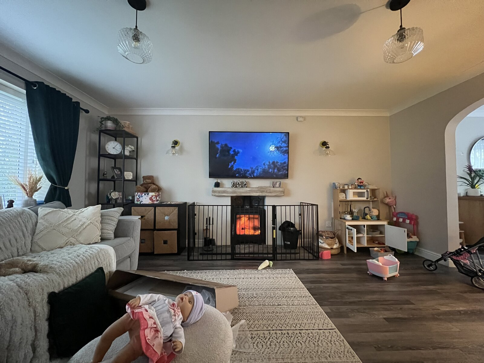

Hi,
Photo of my living room attached. I am looking for advice when it comes to creating a fake chimney breast... where would i buy the steel to create the 'chimney' i know we would also need fire proof boards.
Online i am seeing people making chimney breasts out of wood, but we can't do that because we have a wood burner and it gets very hot.
When we have the chimney breast done, our plan is the add cabinets either side of the fire place, with floating shelves above.
Then are looking to get a smaller tv and have it on one of the side cabinets so it can more at eye level (before anyone says how high the tv is haha).

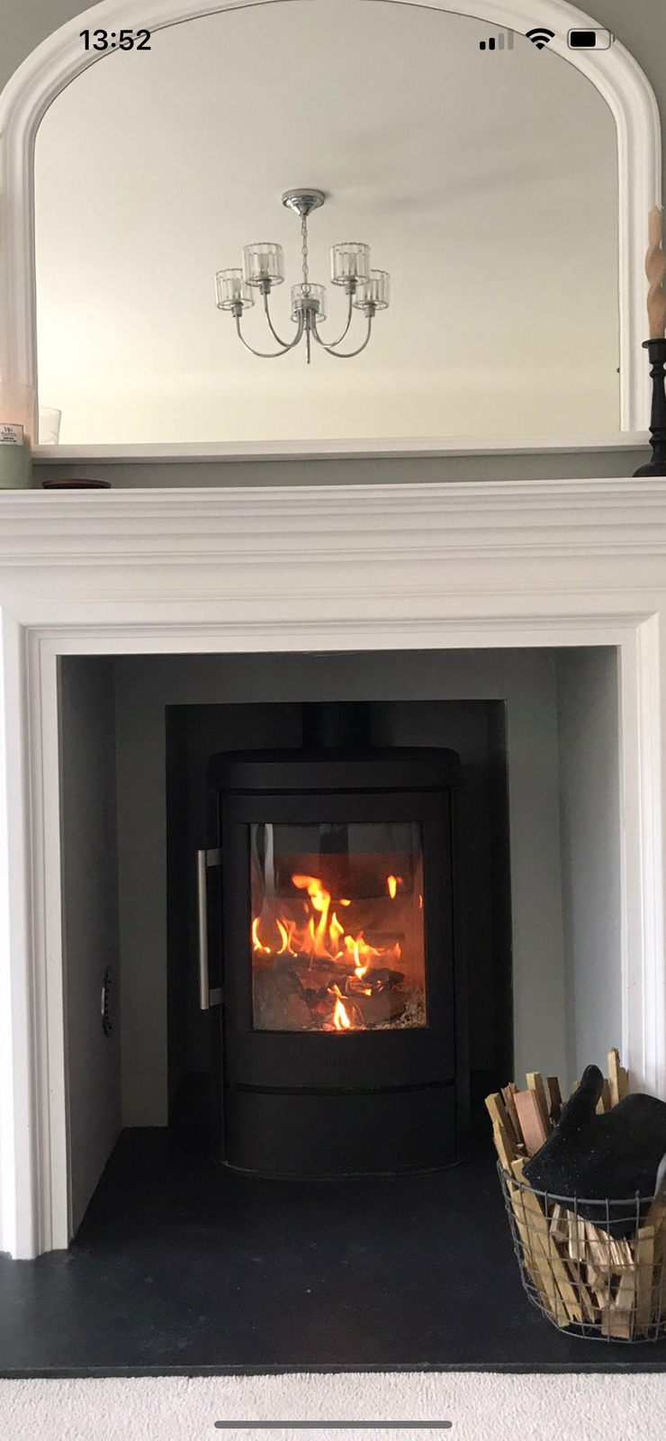

The only thing to account for now, I think is getting a new hearth. We want to bring the wood burner forward and that won’t leave much space at the front if we do that, don’t want the wood burner buried at the back of the chimney breast. The recess that is currently cut out of the largest it can be too!

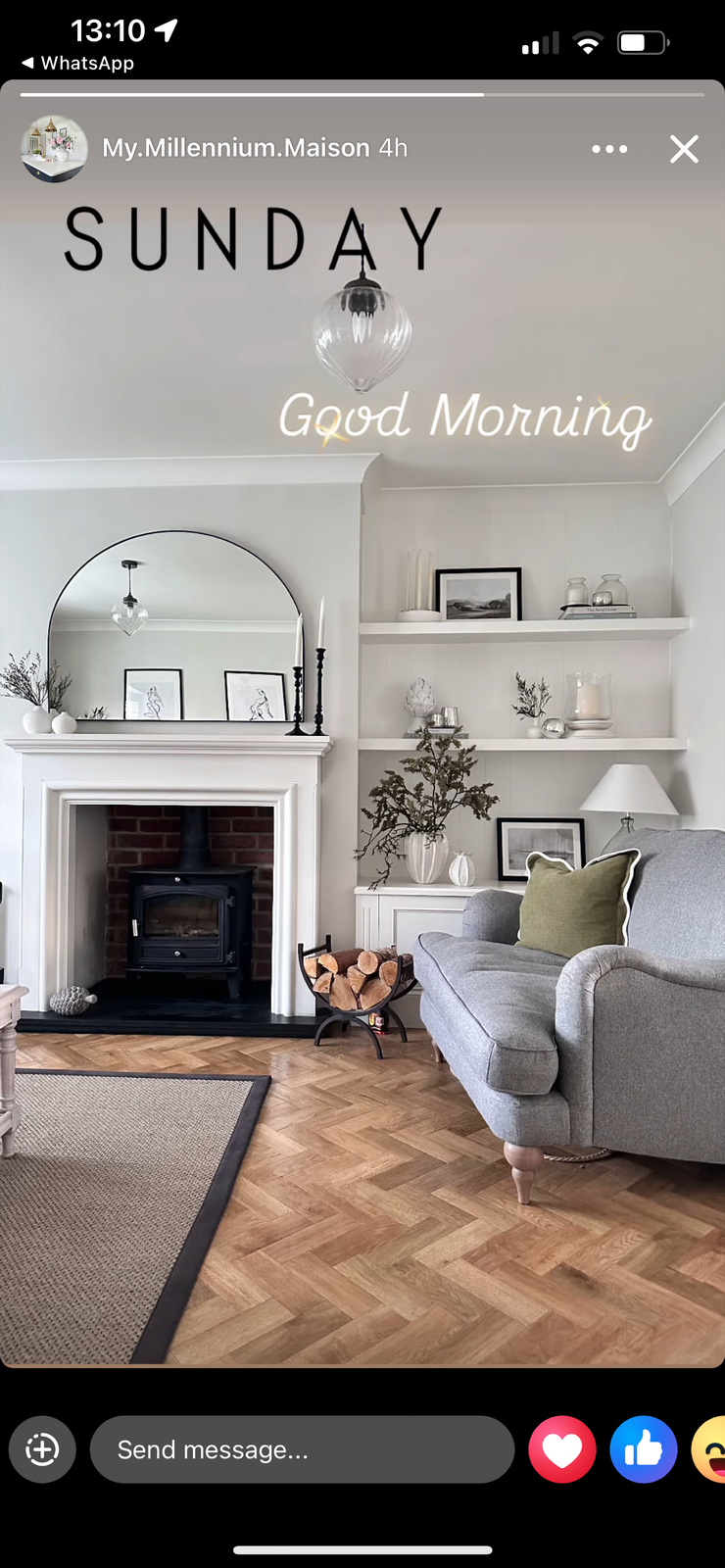

Ours might look similar to this, with frontal recess at the back and a newly made one which is wider …

but look how good this looks! And I’m mostly thinking about all the storage i would have with two cupboards either side hahaha
