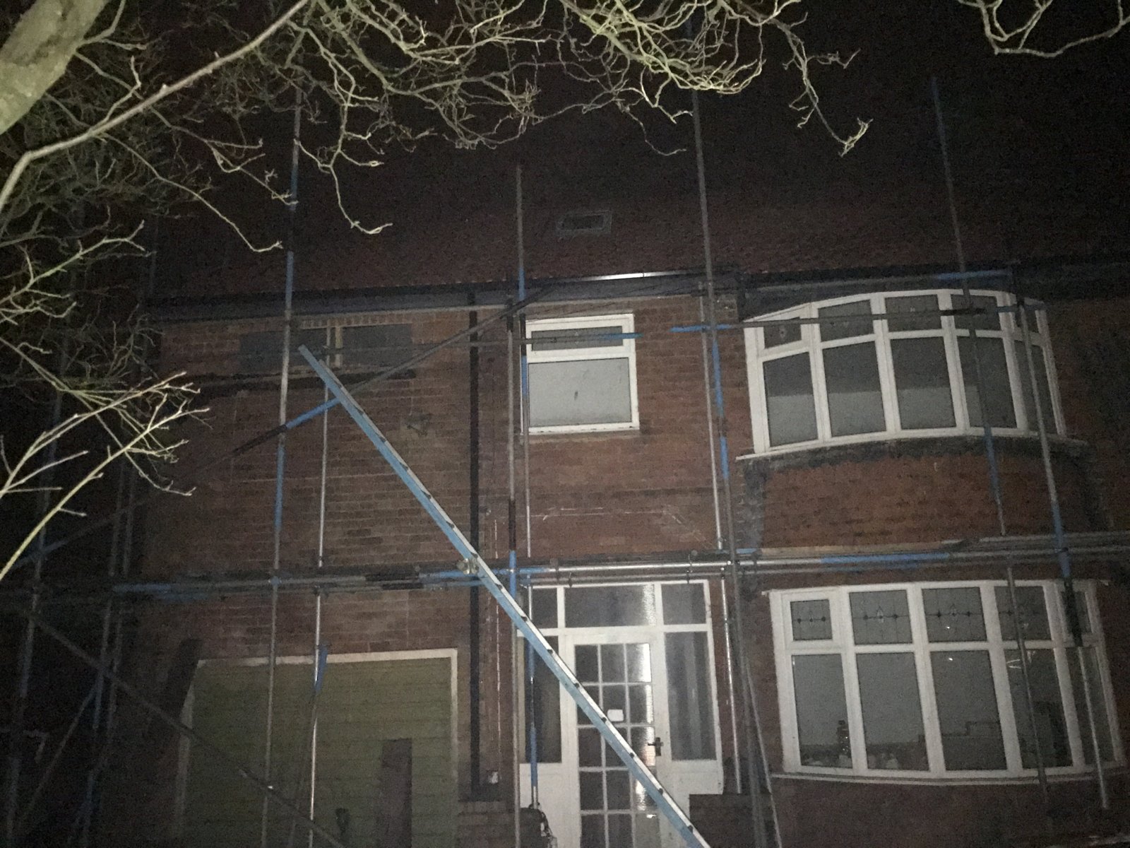

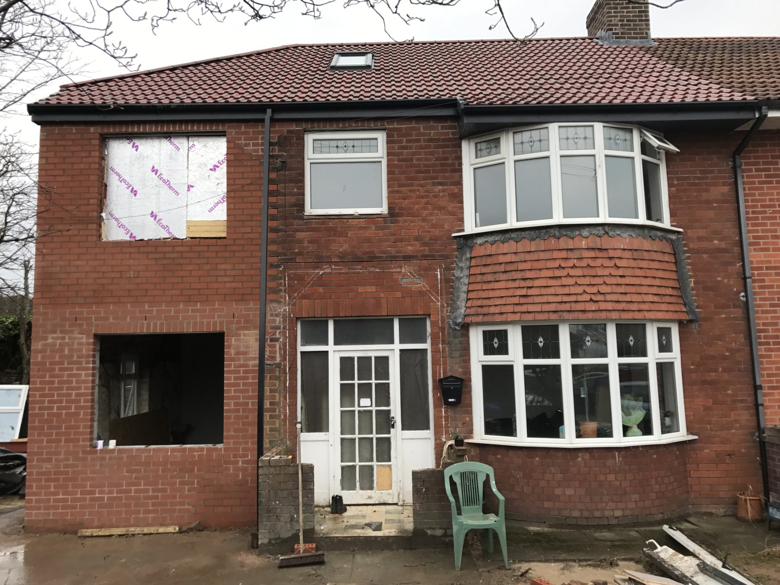

I think it best if I post a pic once the garage is bricked up and the opening made for the window above it. Should be 2 weeks.
This is the only pic I have of the front on my phone:
The neighbour attached has the same side extension with windows top and bottom, same porch as is there now and the other houses around (it's the end of a cul-de-sac) are bungalows
If the garage is being changed to a room, with a window, then you definitely don't want to be looking out at a brick wall in the side of the porch; it'll cut down the light coming into the room. Good point on the depth; is the porch door going to open inwards or outwards. If it opens inwards, think about stepping into the porch, and then shuffling round the door before you can get to the inner door.

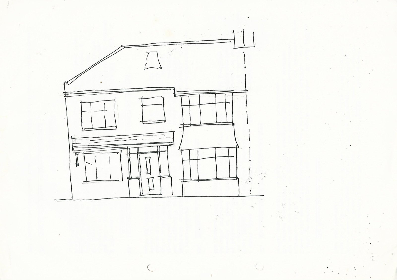

The thing I am thinking is stylistically the gable porch is more of a victorian feature and not found on inter-war housing. That is not to say it is wrong in any way though.
A lot depends on your plans for the building as a whole and if it is with an eye to selling at some point in the future.
A traditional solution would be an outdoor porch with a single pitched roof that extends over the window where the garage is, with posts each side to round it off. That one does break up the mass of the building.
Or you could consider a covered side entrance porch, which avoids that double door problem. You could then keep the glass at the front, which must be good for getting light into the house.
You could always replace the window above with something more in keeping with the house, or even a box or oriel window say. Just saying there is a lot you could do.

They are all 73mm sandfaced so I'm hoping they will all clean up the same.

Another thought about getting the ridge central to the window above.... could you not make that window wider to centralise it over the door?
No, too much work and the room is very small, we pinched half of it for the loft stairs.

FWIW, I think trying to cram a porch into the relatively narrow width available, and putting a gable on it as well, would make it look a bit 'forced', as though it had to be tightly shoehorned into the space.
Why not consider a simple lean-to roof, and carry this across the side extension in the form of a canopy. This would visually link the house up with the side extension and make it look more uniform, instead of the more staccato effect of bay-porch-window.
