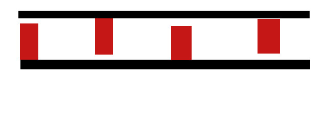

One idea is to have 2 sets of joists which are slightly offset (10mm for example) from each other, sommat like this:
How would one go about doing that, with the top and bottom plates?
3x2 verticals and 4x2 horizontals; or 4x2 and 5x2 etc.
Thread your fibre around the studs so that it is continuous.
The challenge is noggins. The obvious solution is to not have any. If you do have them, you could have e.g. 2x2 nogs, 3x2 studs and 6x2 plates. Or you could make "ladders" with pairs of verticals with studs between them, alternating from one side to the other.

that's the normal method, bring your studs for each leaf close together but not touching and insulate between and double check board on each side. Don't expect to completely eliminate the sound of a washing machine
