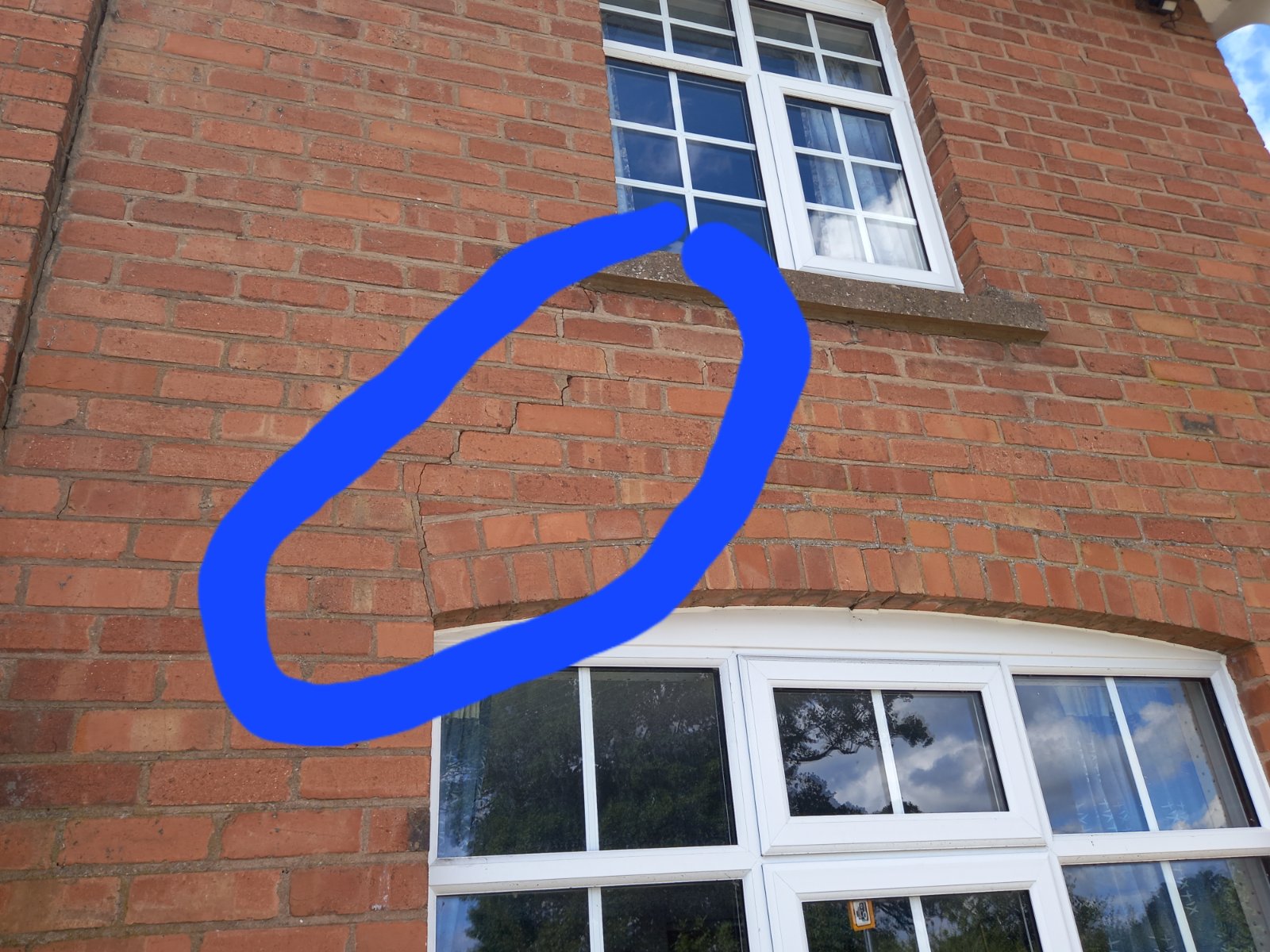

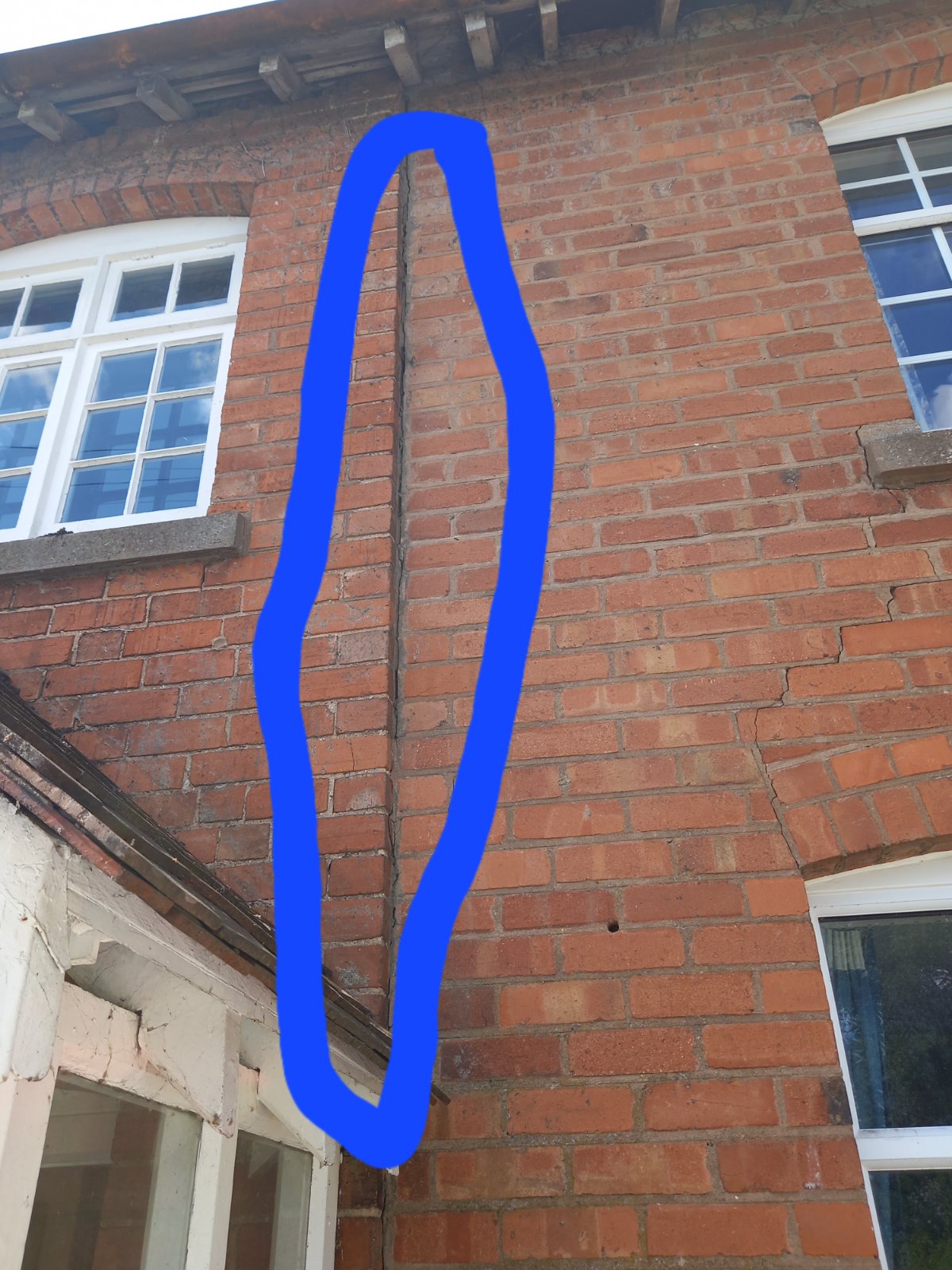

My parent's house has settlement cracks. There's a fairly decent one between the main house and the full height extension and others, below the windows of the extension etc. These are all historic as far as we can tell. They were present when I lived there as a youngster some 40+ years ago. We had ivy shoots growing through into the bedroom at one point, I remember. Long since filled in. I don't think things have gotten worse over the years.
For insurance purposes can these be ignored? Or, declared as 'settlement' even as historic? I don't think it would be classed as subsidence. It's certainly not falling down around our ears.

The vertical crack is expected and is a differential movement crack - usually alleviated with (polysulphide) mastic.
The one above the window likely occurred when the windows were swapped from a load bearing, sturdy mullioned, wooden window, to the placcy one you see there. The shallow arch and window above doesn't help. It's probably settled as much as it's going to, unless the walls start pushing out sideways.

As a lay person you would not be expected to know what they are called or caused by other than it being "a crack". You could elaborate with hairline/narrow/wide or suchlike or give dimensions, but you would be wise to avoid that level of detail. And avoid speculation on the cause too. They are just cracks to you.
FWIW, one is vertical abutment mortar cracking, the other is a stepped mortar cracking.
The vertical one is common where buildings meet and from movement mainly sideways due to contraction shrinkage in the wall. But there does appear to be some downward movement too - which again would be common as the houses appear to have been built independently.
The stepped cracking is likely the same cause in the absence of any other cracking further along or around the corner. Wall contacted, causing the opening to widen and the arch drop.
There are other potential causes, but more detail and investigation would be needed.
