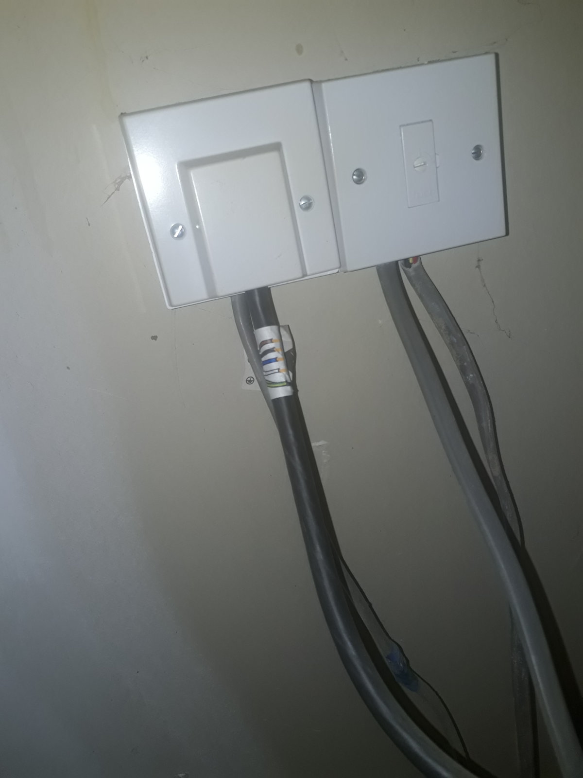

Just looking for opinions really before I go out an buy a hob that I may not be able to use! I have put a photo of the wiring behind the oven, the hob wires go into the left and the oven goes into the right

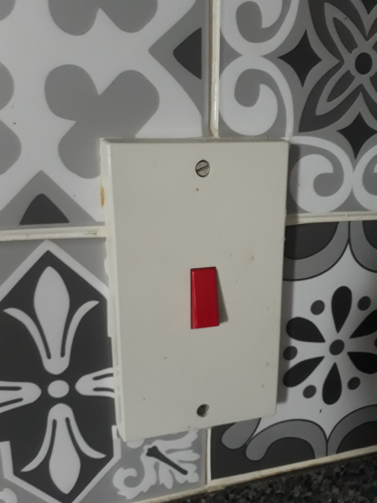

What is the rating of the fuse/MCB/RCBO for the cooker circuit?
Please post a photo of the switch.

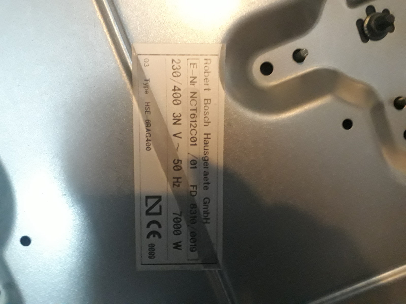

What's the rating of the old hob?
Why are there two cables coming out of each side?
Picture of switch. Current hob is 7000 and has been fine.
I'm not sure about the 2 wires I will have a look again. There's definitely only the 1 coming out of the hob.

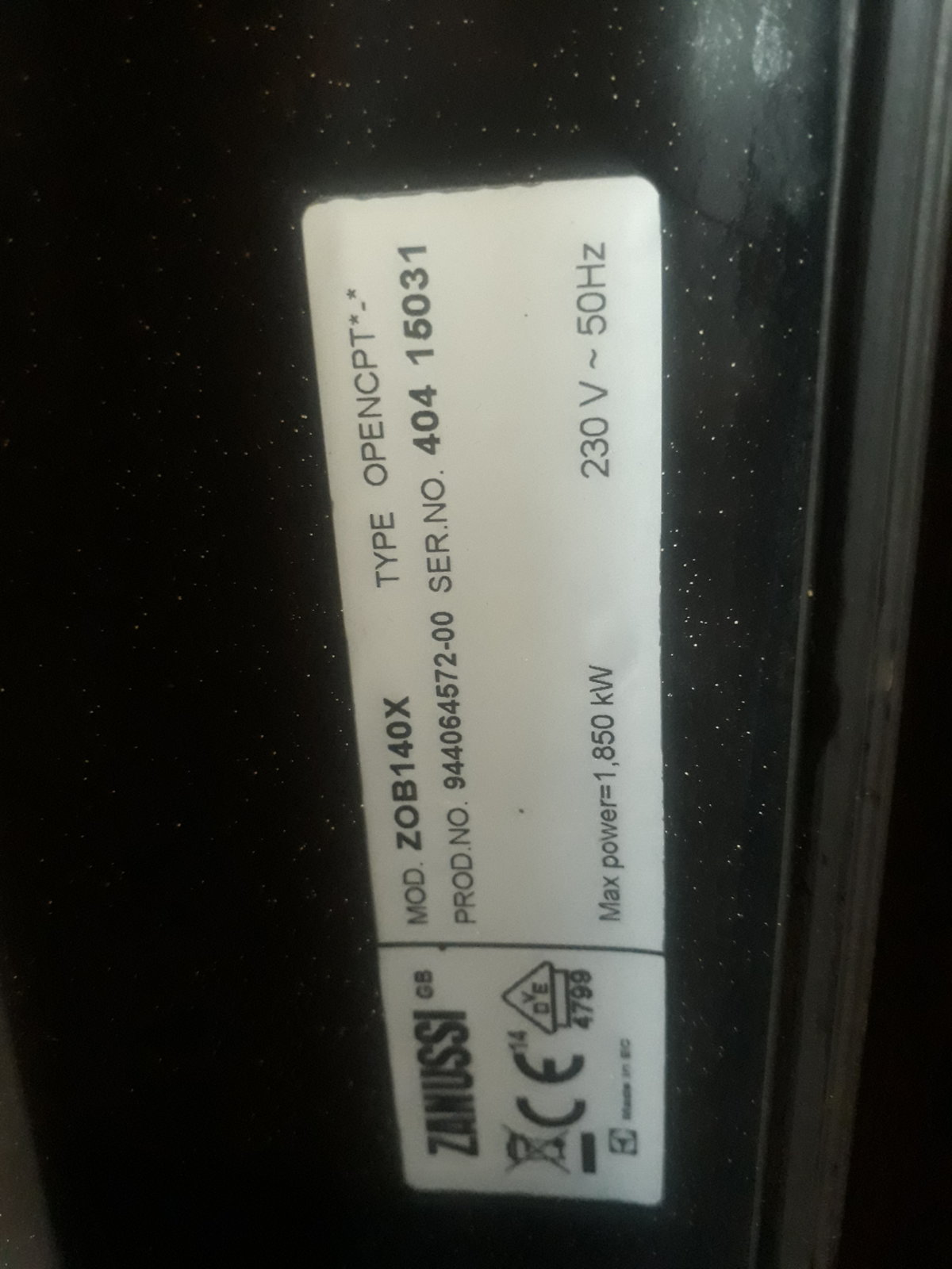

Have attached pic of inside oven. (Can you tell I don't have a clue!) You are right 1.85kw
It says max power 1,850 Kw
230 V ~ 50Hz

Assuming the oven rating is at 230V like the hob is, your current 7kW hob + 1.85kW oven is calculated as 18.6 or 21.6A (depending on how you parse the poor English wording of the guidelines. Most people use the interpretation which gives 18.6A).
http://www.tlc-direct.co.uk/Book/6.2.1.htm
Your so-called electrician is simply adding up the peak ratings of hob and oven, and is telling you you need a hob of no more than 5.5kW because he, in his ignorance of how to do his job, thinks that's what a 32A cooker circuit is limited to.
Do not waste your time asking him to explain, or reconsider etc.
Ignore the charlatan, and find an electrician who does actually know how to do the job you are paying him to do.
230 V ~ 50Hz
It does but that means 1.85Kw in English. In Germany they use a comma as a decimal point.
