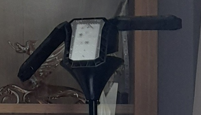

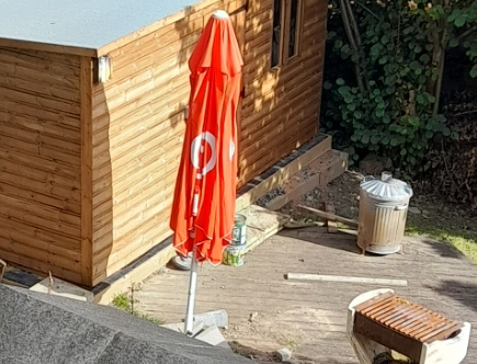

Which way up should it go, I have mounted as second one, with bulb holder at the top. 1757083920385.png Ready for next BBQ, but next question is how to switch it? At moment on plug in timer, so smart bulb, smart relay, smart light switch? Yes there are some high output bulbs 1757084197687.png but don't think they are needed, if I really want a lot of light I still have a metal halide 70 watt, and sunglasses.
But in the main that light is to see way up after parking the car, or clearing up at the end of a BBQ. So a 22 watt CFL bulb is ample. Will likely change for LED but did not have a BA22d in stock.

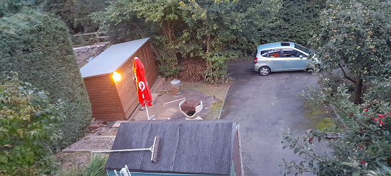

I did take a smart bulb down to the shed to see if it worked, it did. I am also watching to see how well it does light the area, not really dark enough yet, ⁣but 1757099297077.png seems OK. The shed in the foreground has stopped light from the corners of the house lighting the drive, and there is no street lighting.

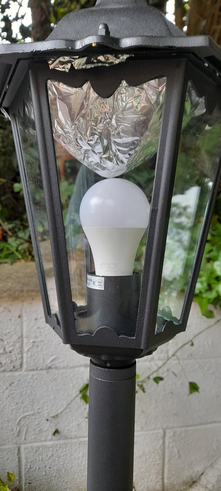

I have 8 other outside lights around the house, some are no longer needed where others are now lighting the area better. But it does seem our lights are still designed for tungsten bulbs, I tried with this one 20230518_174342.jpg to reflect the light back down, I later reversed the tin foil so not so visible. With some 4 to 6 foot drops around the house, when we have visitors I want it lit well enough so no one falls into the drops.

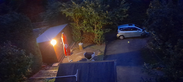

PIR control was a failure, lights were switching on/off all night. Anyway, may need to move the umbrella, but otherwise seems OK 1757100406068.png as it gets darker. Tonight on a timer, but really want some other method of control.

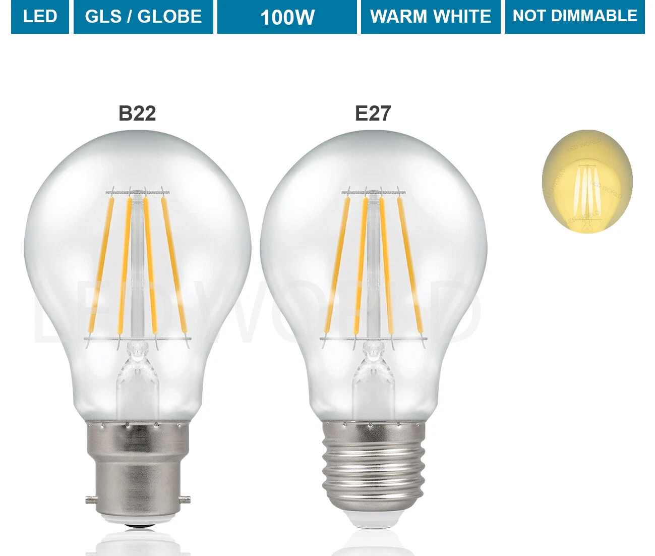

Exactly this. Filament lamps put the light out sideways, and not up/down.
Old LED lamps put the light out 240°
Filaments put the light out 330°
But select on a case by case basis. Sometimes you want the light focused up/down (but not in this case)
There is also another variant, inbetween. 330° but not filament. (basically no plastic white cone at the bottom to block light)

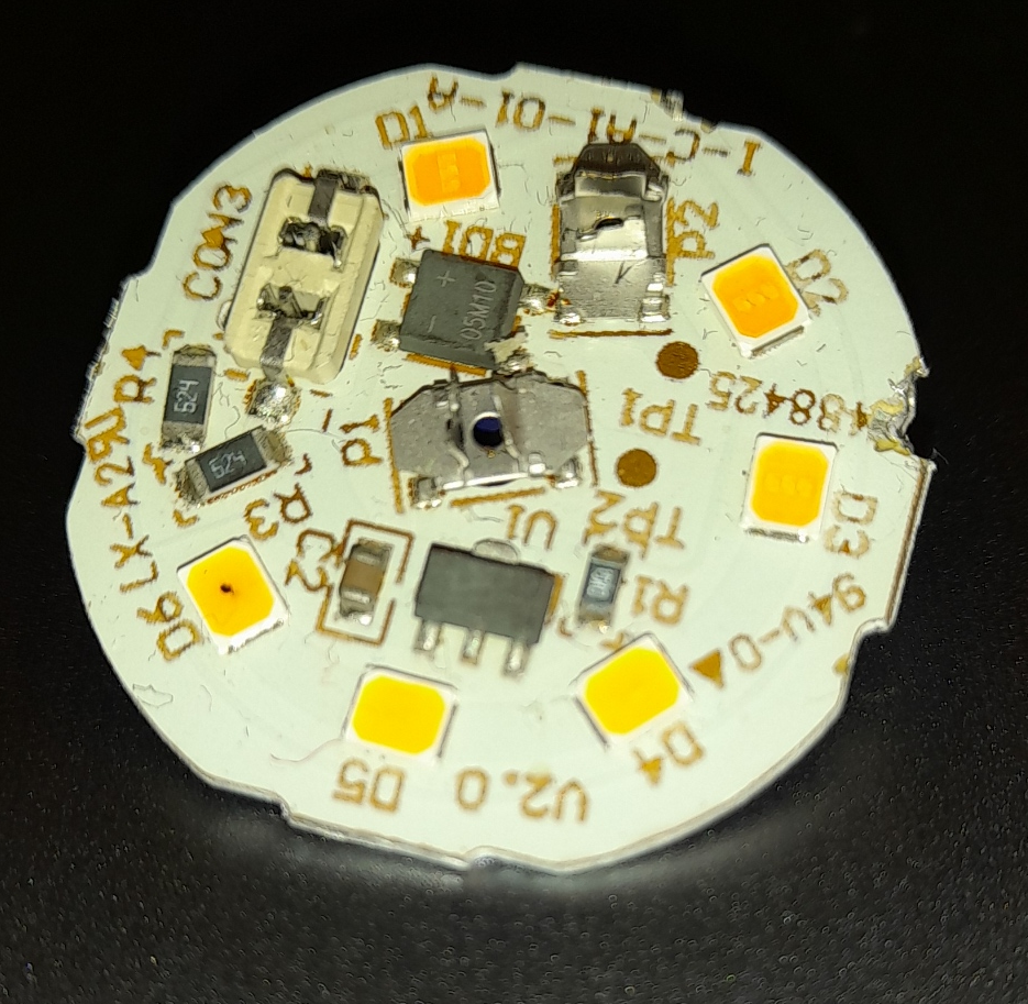

Looking at this
it seems I can get away with a lower wattage, and since the base of the bulb is at the top. Having a bulb with a plate of LED's inside bulb inner1.png will not really matter in this case. I have tried a bulb in a table light at the location, and it could connect to the zigbee hub, I have not tried as yet a socket adaptor, and not really an option to try a switch or relay, as ones I have are not portable, the socket adaptor is more expensive at £10, but will allow me to use the stock of CFL I have in stock, but the smart bulbs at £5 have a screw E27 base, the BA22d base versions are more expensive, the other option is an E27 to SES (E14) converter, as I have some SES smart bulbs in stock, were going cheap in PoundLand.

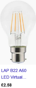

At the moment, just plugged in while I make up my mind, so looking at the filament type 1757152825865.pngyes 470 lumens at 3.4 watt, so very economical, but is 470 lumens enough? The 22 watt CFL rated around 1300 lumens, the smart bulb considered is 806 lumens, 8.7 watt and costs £8, but I really don't need colour changing or dimming, but may want dusk setting, not sure if there is a dusk setting with socket adaptor. But first job is testing if it works at that distance.

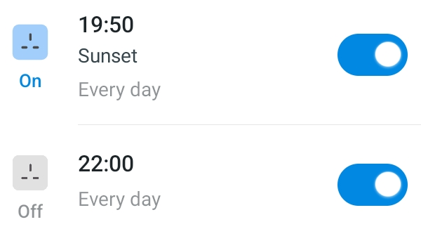

Well I have taken the TP-Link P110 socket adaptor from my bedroom fan, and tried it in the shed, it works OK,
only just, but it works, the option is there for Sunrise and Sunset, 1757158775739.pngso think all I need to do is tidy up the cable. I will give it a few days to see how it goes.
