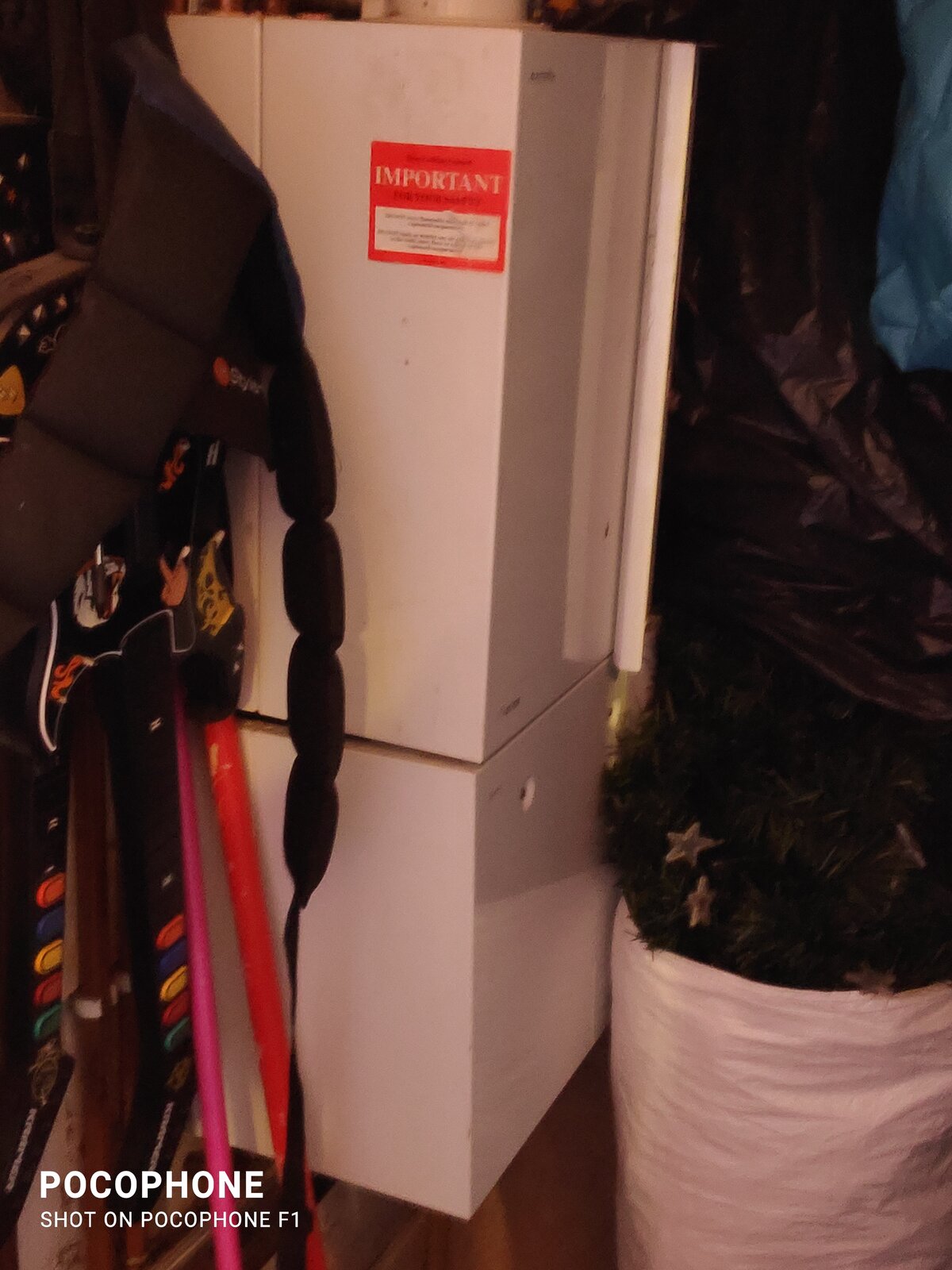

Too be honest I don't really know, I'll try and find out the model, it's a council house and it is a really old boiler, it has two old fashioned looking lights on it one green the other red, I could send a pic if you like?

Hi thanks I've been in the house for twenty years, but I garantee you the boiler is much older than that, the house is built pre war or post either 1945 or 1950, I can send a pic?

I will send you all a pic of the boiler when I get home thanks for your help so far.
A picture speaks a thousand words...
Here's a pic guys if you want other angles just say
From those pics, I can't see any manufacturer's name or read the control panel. It is not something I readily recognise, is it wall hung? Some clearer pictures taken from further away may help. Also, clearing out the stored items might help it. They could be blocking ventilation or air supply.

It's a Potterton Suprima at a guess
