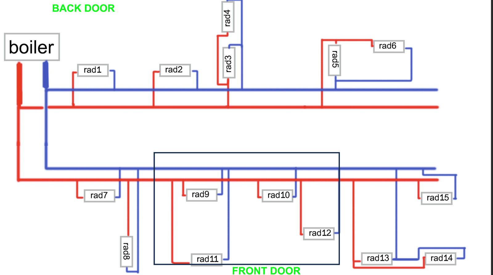

I've tried to draw the layout from memory so it wont be perfectly accurate, but probably very close to this.
Very thick lines - 28mm
thick lines - 22mm
thin lines 15mm
Black square around rad9-12 are the triple column ones.
I hav e wondered if the design of the layout could be a problem, but im not technical enough to know either way.
When it was installed im not sure if it was flushed actually. But it did have inhibitor in last time I bled it, and it does have a mag filter yes.

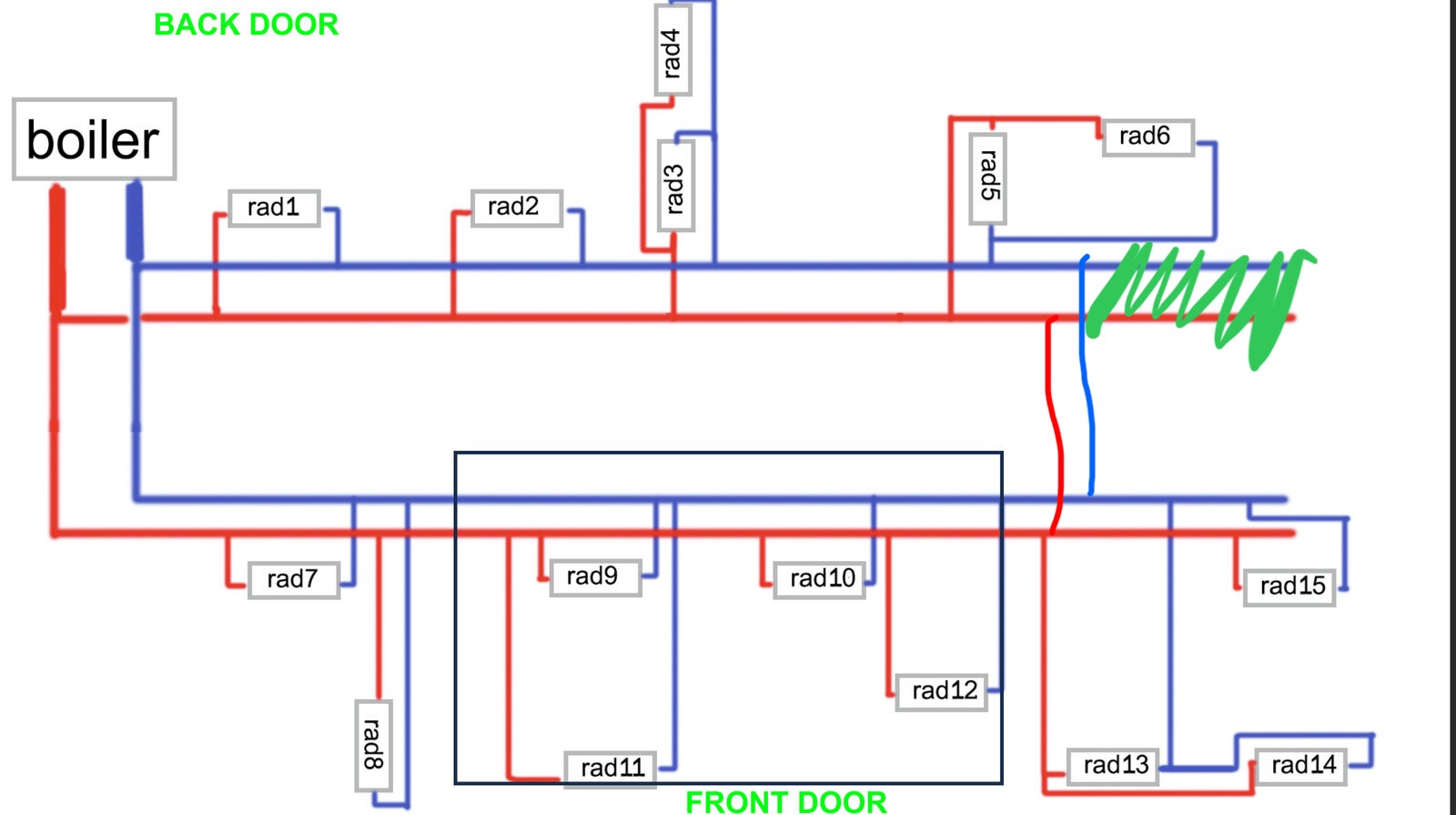

Well yep, that layout is a bit of a mare - could have been made a lot more intuitive by connecting each of those 22mm's together creating a single looped circuit. If the current runs could be coupled without too much of an issue then that would probably go a long way to evening out the system. At the moment each run has quite disparate loads and being extended like that would always cause a major balancing headache. How large are the other rads, not the columns, on average?
Balancing that setup would require a long time to get it right. Especially if you have those 4 large triple columns right in the middle of the 2nd circuit.

I suspected as much… to my untrained eye it looks as though that’s been setup to be zoned… but I never did ask for that so I did think it was potentially non optimal running two unconnected parallel runs like that
It should be relatively straight forward to connect them, it’s good access down the sub floor fortunately. I had a guy coming round in a couple weeks to take a look and see if he could find any obvious wrong doings, like a flow connected to a flow allowing short cycling etc. so I could always ask him to add a couple L / T fittings to hook those 22s up to a loop and chop the dead ends off to cut the loop a touch shorter
Excuse the phone “art”
Like this?

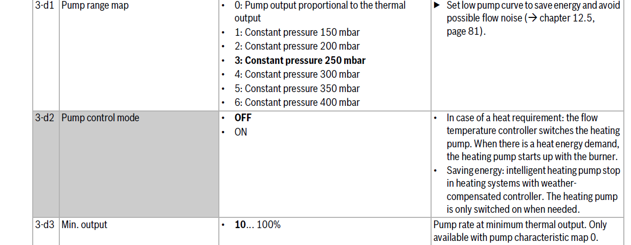

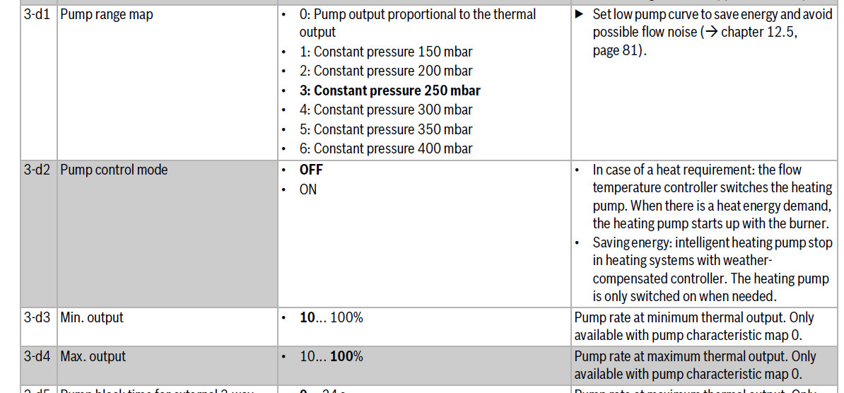

That evening from fiddling around with the settings one last time before giving up, i noticed that the pump output % was modulating down alot, sometimes even as low as 30% even when I had it set to run at constant pressure (option 6 of 3-d1) of 400mbar.
I noticed in the manual if the pump is set to option 0 (the option where the pump is relative to the burner). It allows you to set a min and max % range for the pump output. So as a test I set the pump to max 100% (default) and min 80% (10 is default). And this has made a world of difference.
:-Outlet pipe and rads got hot to the touch within 20mins, even the triple column ones which usually take much longer.
:-Boiler modulated down to 30% after everything got nice and hot, and stayed at 30% for the remainder of the demand.
:- Delta between flow and return stayed at 20 for about an hour, it did eventually close to 13 but the boiler continued to condens. So assume this is fine albeit not ideal.
So it would appear the pump was indeed the problem, essentially being too lazy. Now i just need to work out whether I leave it setup like this, or run an external pump instead.

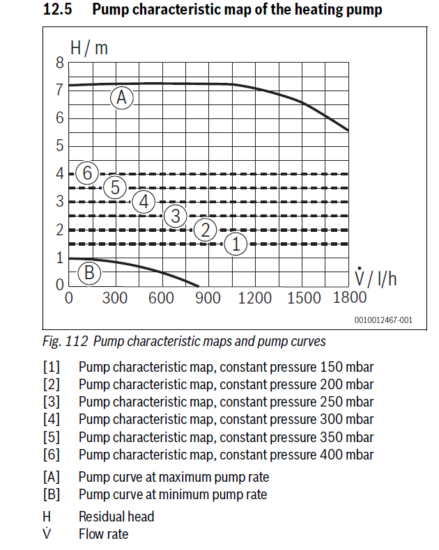

Yeah, a max 400mbar, 4.0M pump head always seems to me to be a bit on the low side, especially with a massive (if this one) circ pump like this

A bit strange why the pump output was modulating at all on option 6 at a fixed constant pressure of 400mbar and also now at a far greater pump head and circ rate and rad output (if at the same flowtemp) that the boiler output is now only 30% vs ~ 40% previously.
Yep… wondered exactly the same myself…. How can it be constant pressure if it’s modulating the output?
And I wondered if that was actually a printing error on the manual… as that means at 100% on setting 0… it’s operating at 700mbar?

If the pump head increased from 400mb to 700mB then the increase in flow should be the flowrate at 400mb x a factor of Sqroot of (700/400), 1.32.
