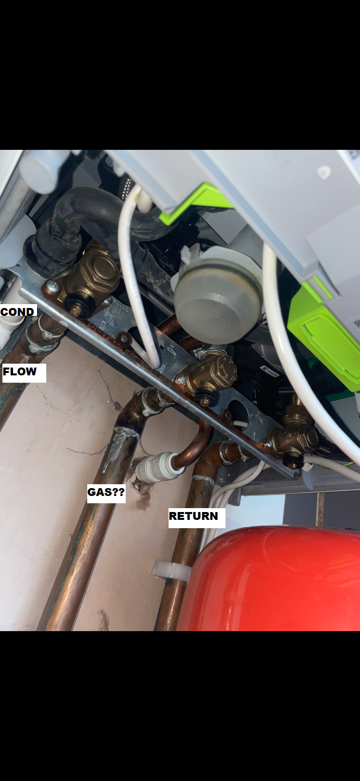

Had a look on the inside, do you see anything resembling a 3 way diverter in there? I didn't but im certainly not technical.
Also is the red capped thing at 18seconds some sort of blow off valve to prevent airlocking etc? If that was set incorrectly could that be causing the problem?

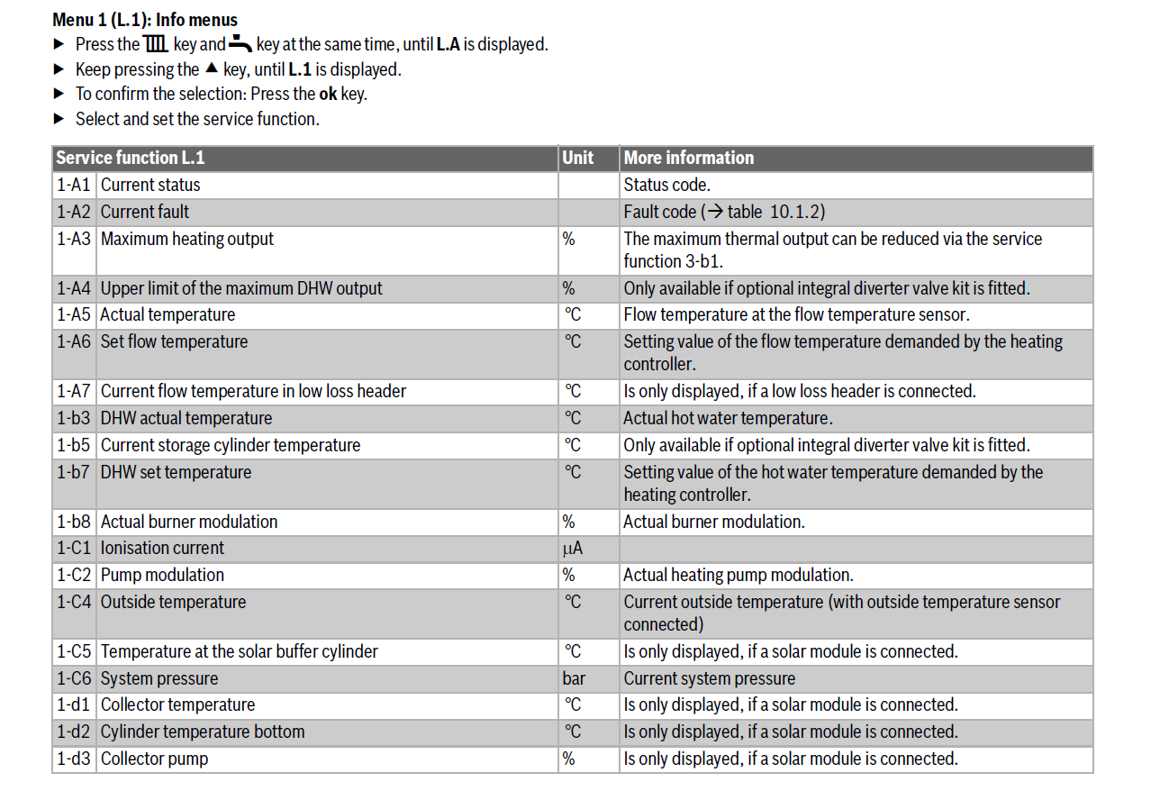

I'll list out what it said below. Though first worth mentioning I set the A2 to 0 and it still did the jumping from 20 to 80% thing once it reached target temp on the boiler of 80'c. So i've turned it back off now. the below is the read outs all whilst there's no CH demand.
A1 - 203
A2 - 0
A3 - 100%
A4 - this wasn't in the menu
A5 - 45.8'c
A6 - 0
A7 - this wasnt in the menu
B3 - this wasnt in the menu
B5 - this wasnt in the menu
B7 - this wasnt in the menu
B8 - 0
C1 - 0.0
C2 - 0
C4 - 3 dotted line (not fitted)
C5 - this wasnt in the menu
C6 - 1.6bar
D1 - this wasnt in the menu
D2 - this wasnt in the menu
D3 - this wasnt in the menu
D4 - this wasnt in the menu
D5 - i have a setting for this on the boiler but its not in the manual anywhere.

Can you follow the menu instructions in post 63 to see can you get those other readings.
If you can't access those values then OK.

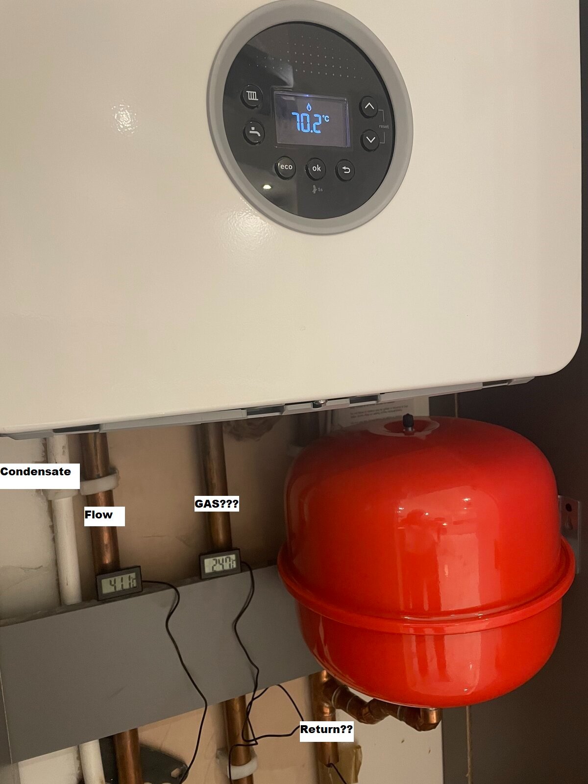

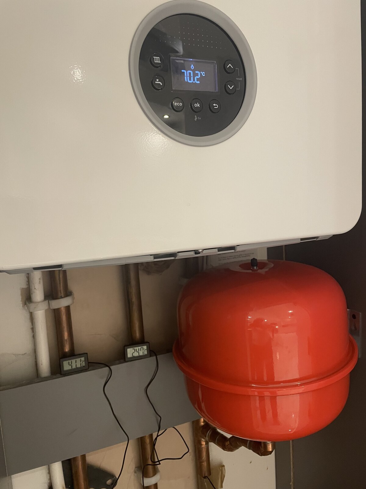

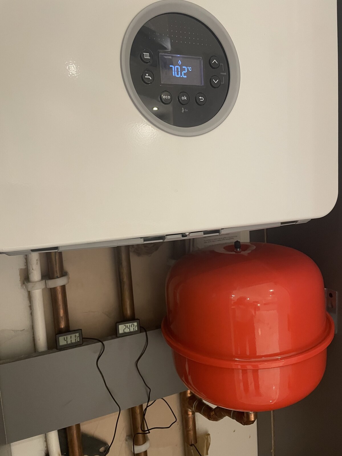

Feeling the boiler outlet directly beneath the boiler, photo attached. .. Left read out was flow, right read out was return. But thermometers aside even to the touch there was a massive difference between boiler lcd temp and outlet temp.
Comparatively (and I know this is silly to say) but we have a 40kw conventional boiler upstairs and with that, you turn it on, and the temperature of the flow pipe of that one is always pretty consistent with the LCD read out. Leading me further to believe something is wrong with this downstair one that we're discussing.
Slight hiccup??
The pipe where the 24.7C sensor is attached to is the GAS inlet I'm pretty sure and the Boiler Return is most certainly the one with the expansion vessel attached, so might learn something further when/if you move that sensor.

Slight hiccup??

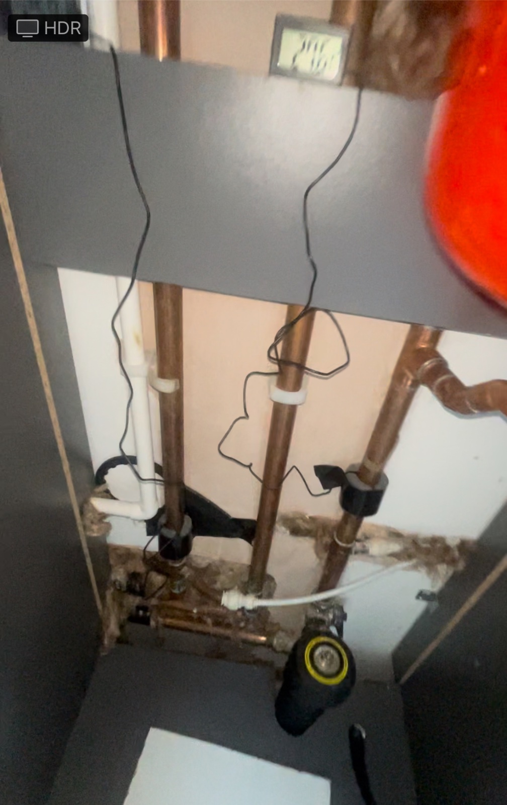

Ah, I see what you mean… no, the 24.7 sensor display is in the middle but it’s metal sensor is inside some lagging wrapped around the return pipe below where the exp vessel is.
I thought the "gas supply" was a bit on the hot side allright at 27.6C.:giggle:
I think you're next move will be to try and convince WB to revisit (under warranty) so maybe supply them with some info which "proves" that the flowtemp cannot be 15C+ higher than your readings.
