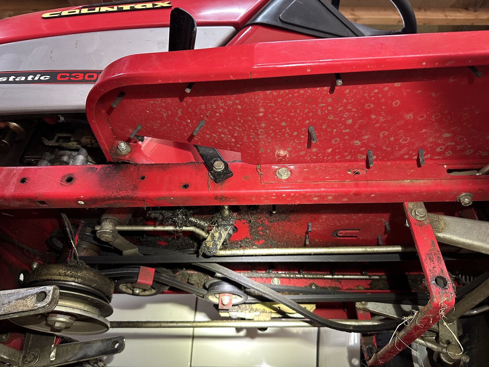

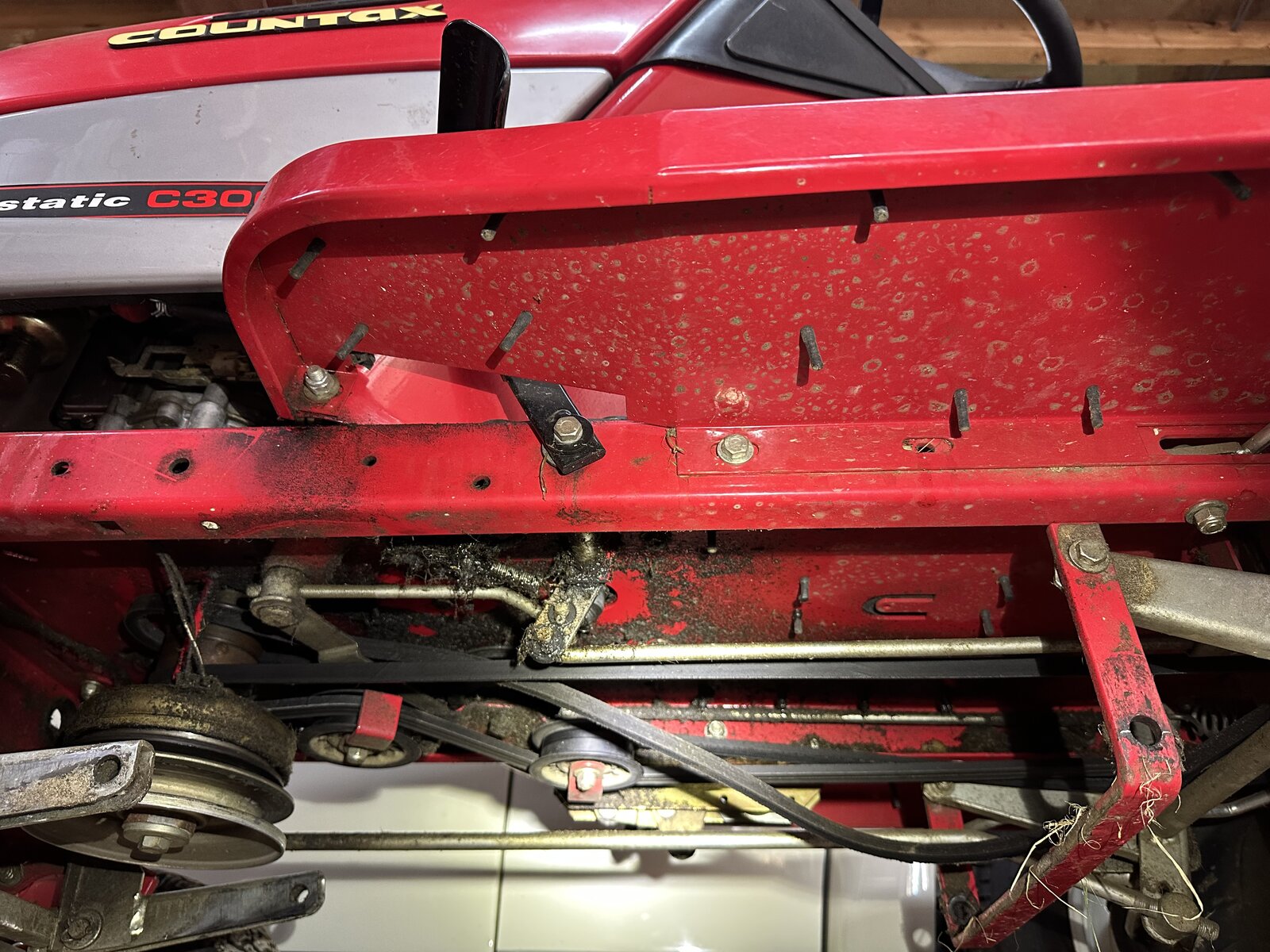

I'm having a bit of trouble with my C300H.
The engine to PTO belt keeps slipping off the PTO pulley at the transmission end. It's a right faff getting it back on each time I want to engage the PGC and wondered if there was any adjustment on the belt pulleys (I've had a good look and can't see anything) or if it's time for a new belt?
Hi yes it’s the one with the powered grass collector on the back.
The pto power comes from the engine via a belt under the chassis see photos
Very unusual for there not to be some sort of tensioning system - often spring loaded?
If there definitely isn’t, check the belt for fraying along one edge.....if faulty it does cause it to fly off.

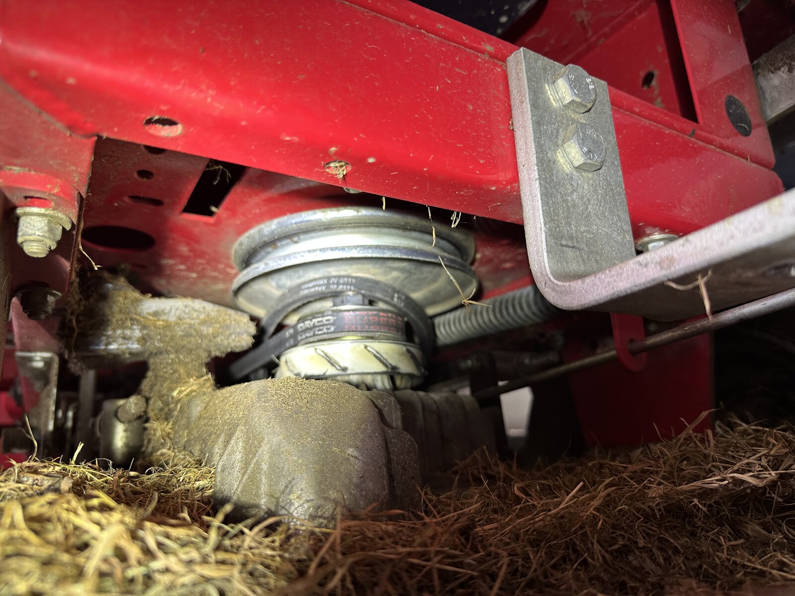

Look to see if there is a loose pulley, which has lost it's spring. That is the tensioning pulley, tensioned by a spring.
Unless the belt is in an obviously very poor state, it is not usually the cause of the belt slipping off.
Just coming back to this to share what I hope is the resolution.
The four bolts that mount the engine to the frame. One was missing altogether one was missing a nut and had vibrated against the frame causing the hole to elongate and the bolt to bend and the remaining two on the other side were loose.
The outcome of this was that the engine had moved sideways and backwards which I think might have made the pto belt loose.
Fingers crossed this has now sorted the issue out!

I must have my doubts about the loose bolts allowing enough slack to let the belt jump off.......the engine would have to shift a fair way back for that.
Anyway, you've sorted that one which must be good so lets see what happens!
John :)
I’ve given it a good run (my grass is basically a meadow as the machine has been out of action) and the pto belt hasn’t slipped off once so I’m confident it’s resolved.
