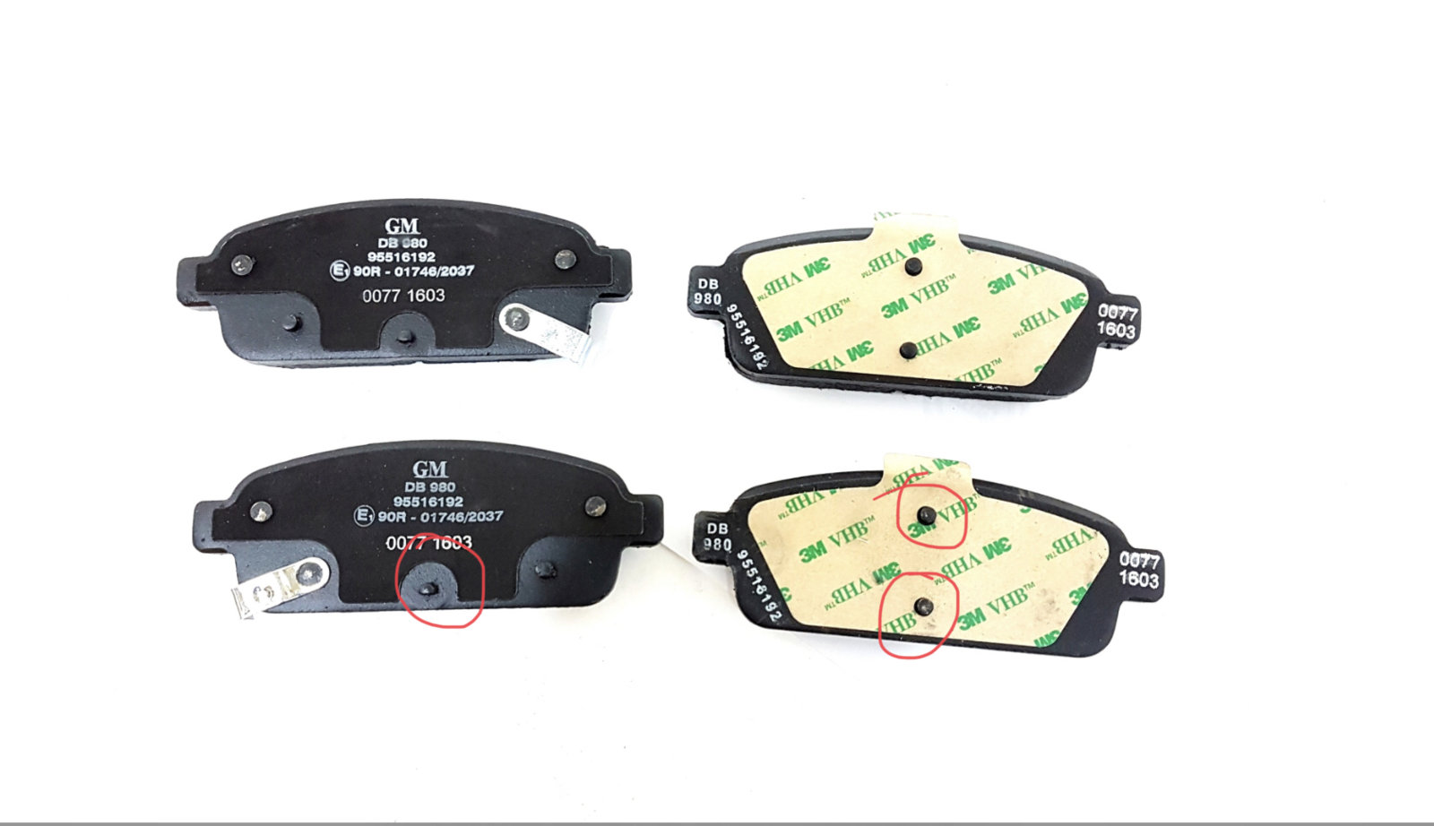

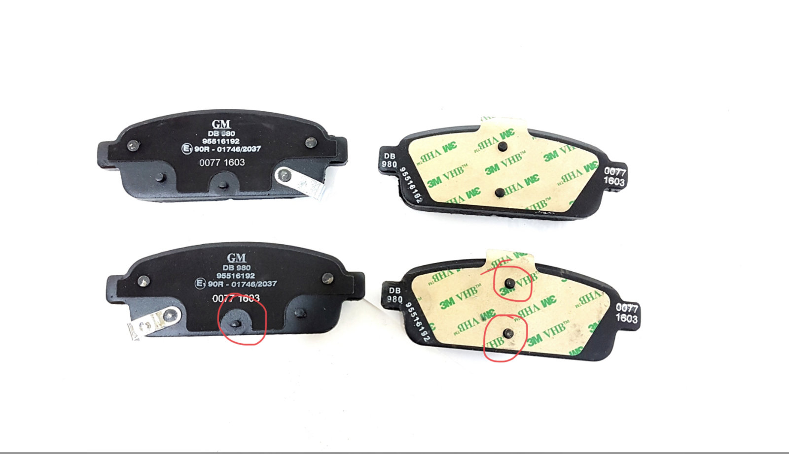

As for the rear brakes I haven’t done Vauxhall ones, but on the Ford Mondeo its vital that the pads lock into the calipers properly - there is a peg which if it isn’t properly located causes exactly what you have found.
Maybe another pin in a hole situation!

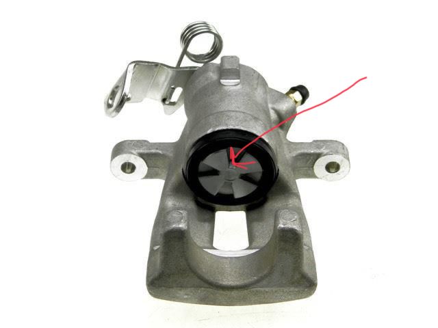

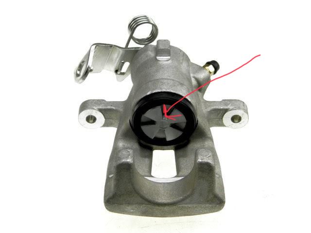

If you have pads and callipers similar to these, make sure any pins on the rear of the pads locate into the slots on the piston. If the piston slots don’t line up with the pad pins, you can rotate the pistons by putting a large screwdriver in the slot and twisting it.
So, I’d check the pads first, one side at a time.

A rear caliper foot/hand brake is self adjusting.
The best way to see the lever working on the caliper is get someone to pull on the handbrake lever in the car and have a look to see what's happening on the rear of the caliper with the lever. With the handbrake off, is the caliper lever returning to the off position?

With a combined foot/hand brake caliper, the piston gradually pushes out as the pads wear but the piston is also on a screw spindle that operates the handbrake. Depends on what part is seized as to the course of action.
This caliper is a VW but will give you an idea of the internals.
