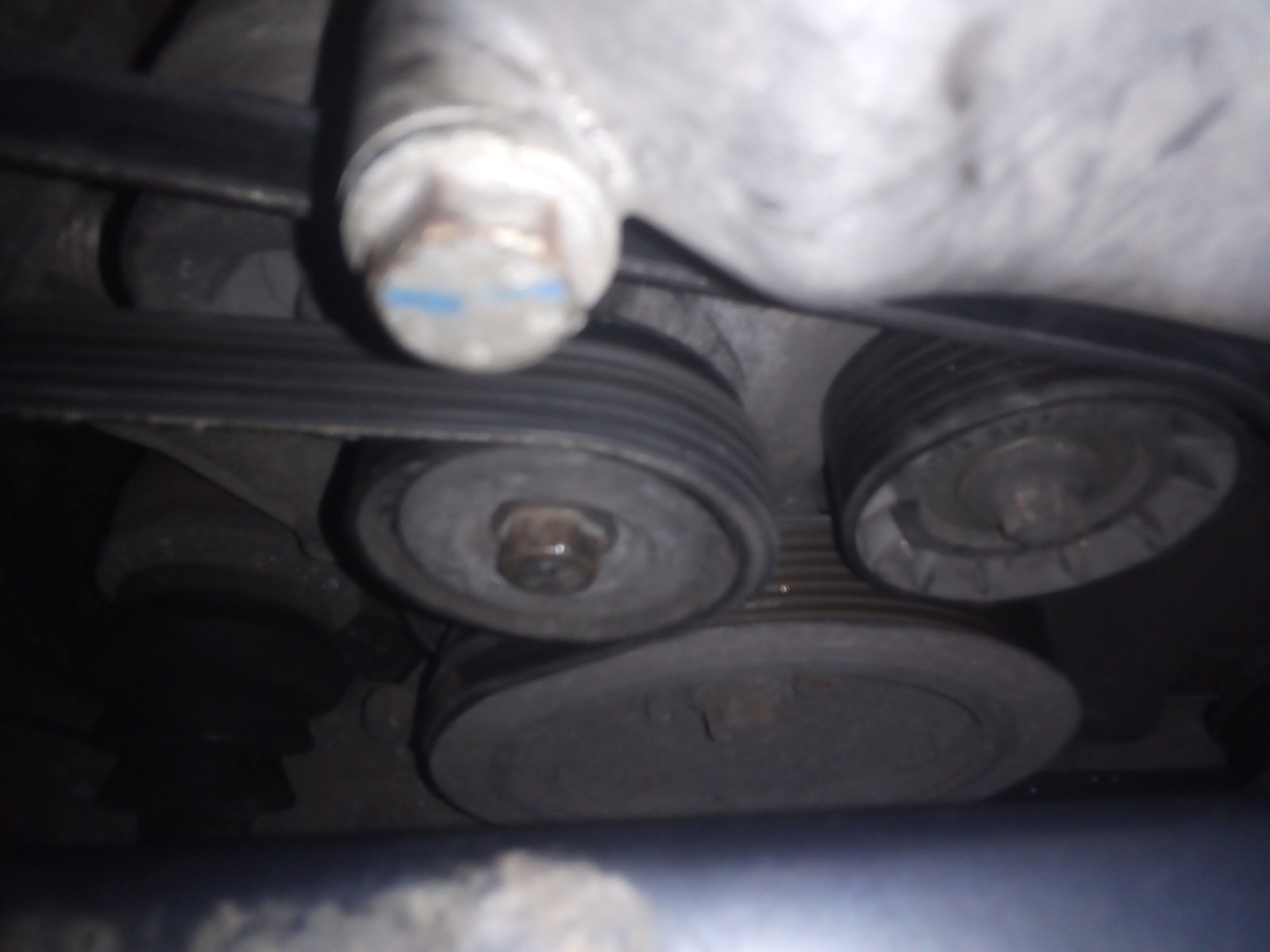

car is a 57 plate Vectra C 1.9 cdti 120 bhp , When I undo the tensioner bolt it only loosens the bolt on the tensioner and does not actually affect/loosen the tension on the belt to get it off .
the belt has shredded and the belt has also come of one or 2 of the pulleys a little bit it isn't full on the pulley
anyone have any ideas?

Hi there ! Not sure what a spring tensioner means but apparently it has one.
There is something further back that looks like an Allen key may fit in. What would I do, just put an Allen key in and loosen and undo it while tugging the belt off ?
On YouTube on same engine it shows him just undoing the 15ml bolt and it released tension on belt . Showed nothing about Allen key .

As above its spring loaded 15mm socket or spanner turn clockwise with on hand and pull belt off with other hand.
Hi
Yes it is 15 ml I was turning it anti clockwise to loosen it as shown on YouTube on a car with the same engine, all what happens is the bolt on the tensioner comes loose with and no tension release on the belt. Is it true you have to put Allen key in the hole behind it and undo it ?

Forgive me mate but what I see there doesn’t look like a spring loaded tensioner but rather an ordinary one.
More pics of the belt run please, we’re looking for other tensioners or the alternator.

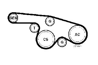

Hi and thanks for helping me !
I looked up the routing it shows this as being the tensioner pulley.
I will try to take more photo's tomorrow in daylight, it is difficult trying to take photo's of some of the pulleys they are in awkward places.
the photo here shows diagram for belt routing, I don't understand why it says on tutorials undo the tensioner nut anti clockwise and it will ease tension off the belt, all it does it loosens the nut though and no release on belt tension.
there is a small allen key looking hole further back, is that possibly needed to release belt tension ? I see nothing on tutorials about this though.

Allen key, drill bit, thin screwdriver just holds it in the untensioned position until you put a new belt on.
