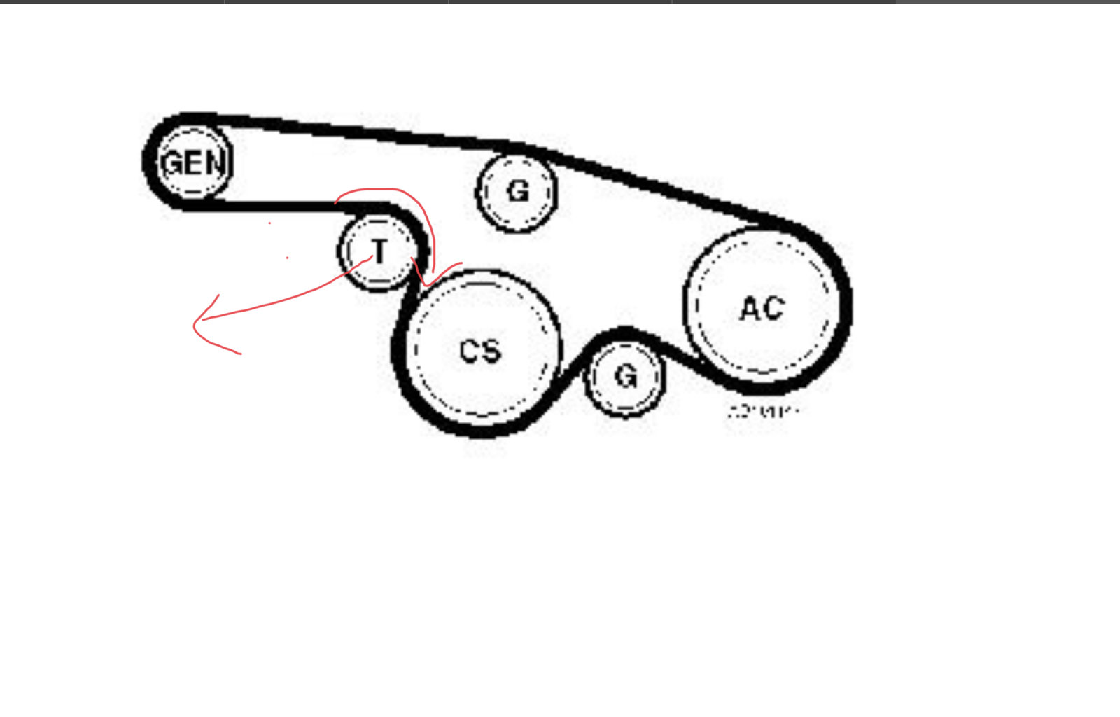

Tighten the tensioner bolt clockwise and it will untension the belt against spring tension. Once the belt is off I gradually let the pressure off until the spanner hits on something or the tensioner stops moving. Fit new belt, tighten again clockwise until you can slip the belt on. I always draw a picture of the pulleys and the routing of the belt.

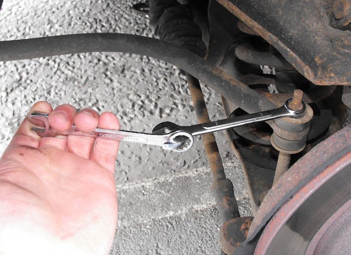

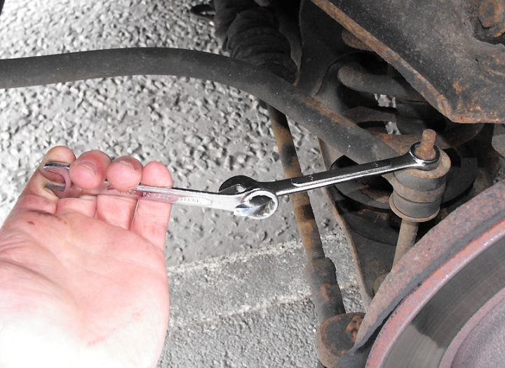

No. All spring tensioner are loosened by tightening the tensioner nut. You won’t break it but you will see the tensioner move. As you have found out, loosening the bolt only removes it - this is so you can replace just the pulley. Grab hold of the belt and pull it outwards an you will see the tensioner move. This is not your car but the same principle applies. See how tightening the bolt, loosens the pulley and look at the length of the lever he is using.

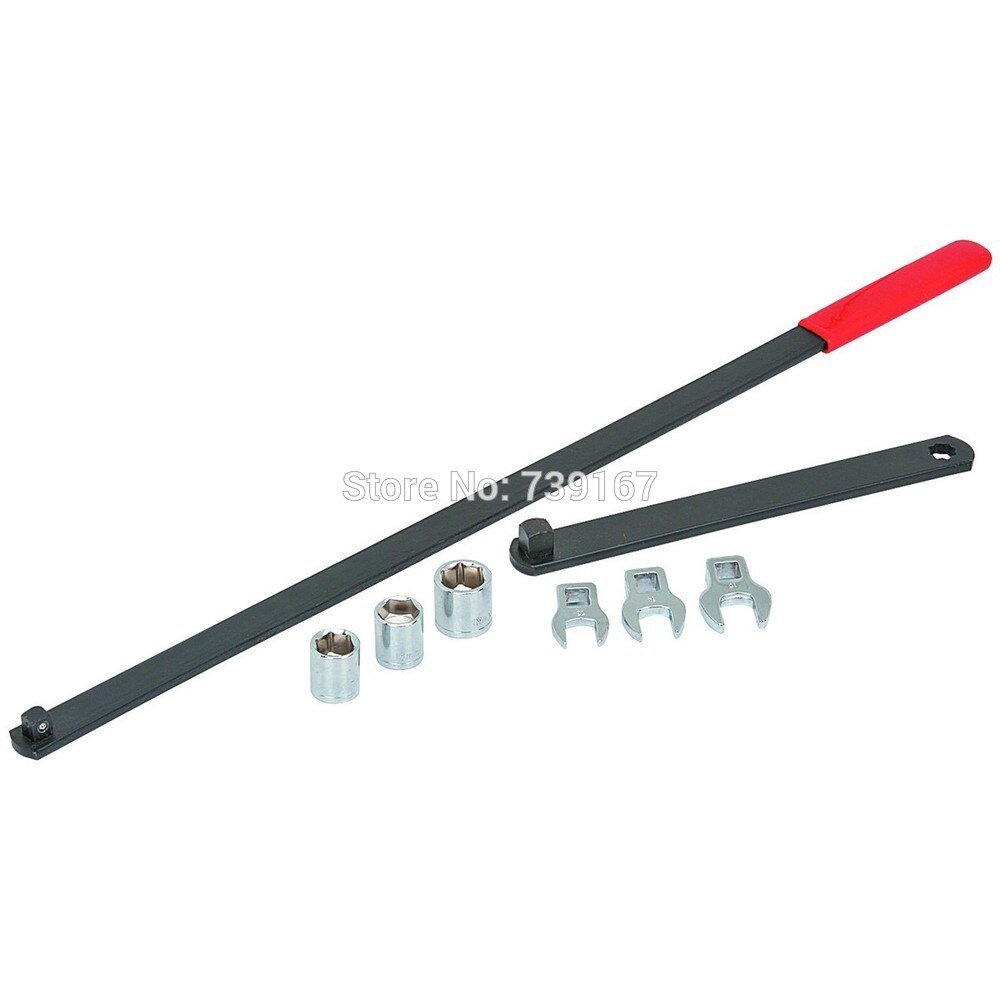

If access is tight I sometimes find I'm not strong enough to move the tensioner without a length of pipe or whatever on the end of the spanner.
I'm sure it will shift if the bolt is turned clockwise.
John :)
I use an 'extension spanner'. ;)
Although I keep threatening to buy myself a Serpentine belt spanner set.

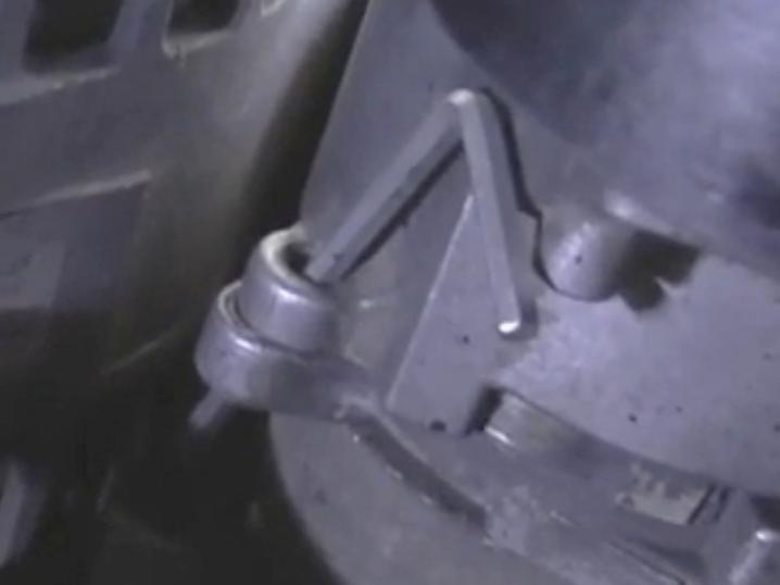

I have taken off the old drivebelt, I was able to release the tension on it. Now I want to know do I need to lock the drivebelt tensioner to fit the new belt on or not ?
I could only see one hole on the tensioner that may be for locking it in and I was able to pass a very small allen key through it but It is a very thin allen key I don't see how that would hold it back, I don't see 2 holes for 2 allen keys as shown in the tutorial. I tried to line it up with a hole (don'tthink it was on the engine) but even thoguh I pulled it all the way it was not going into any hole other than on the tensioner hole.
