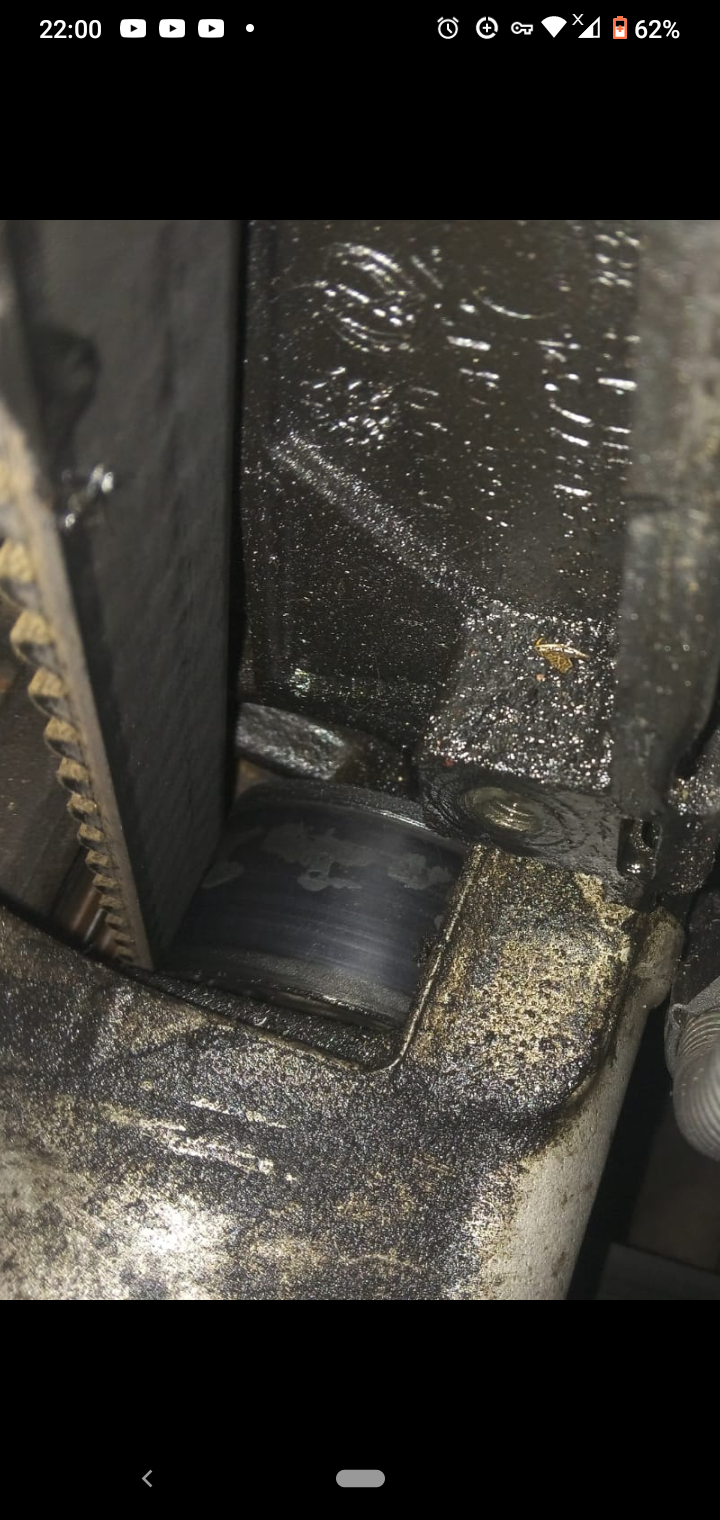

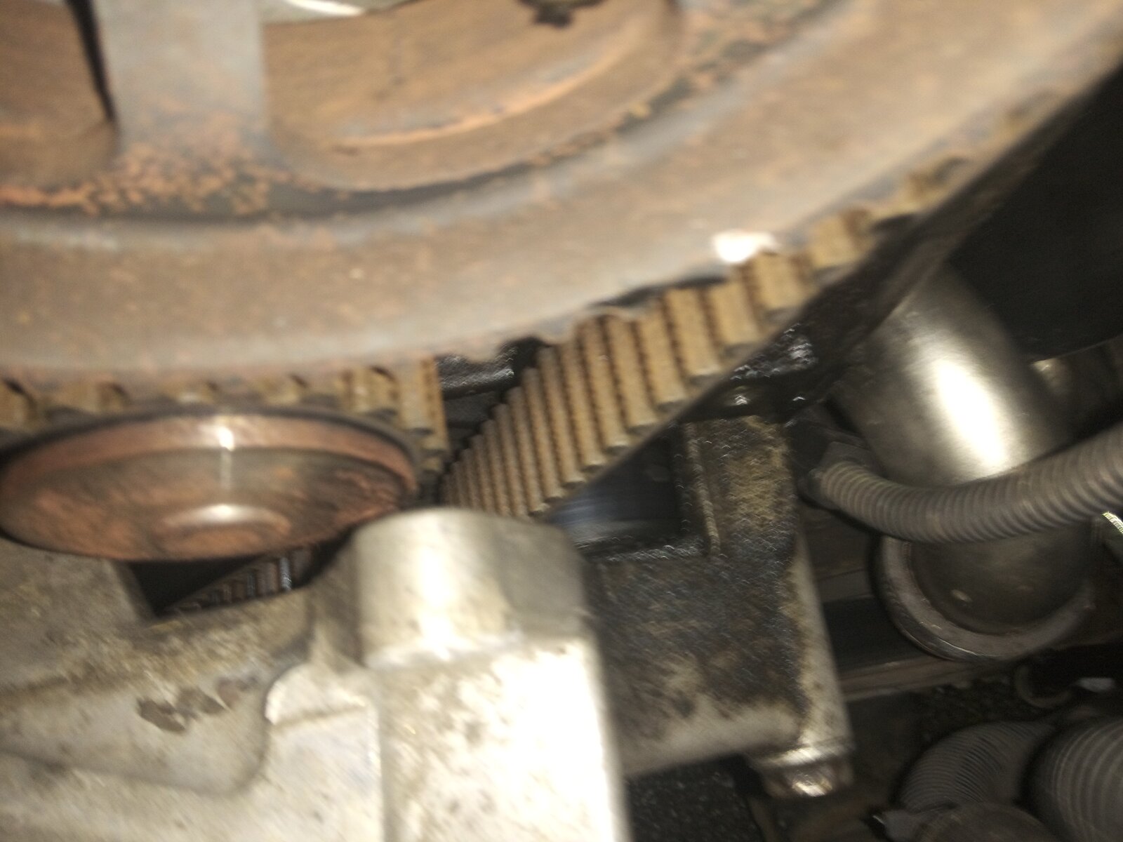

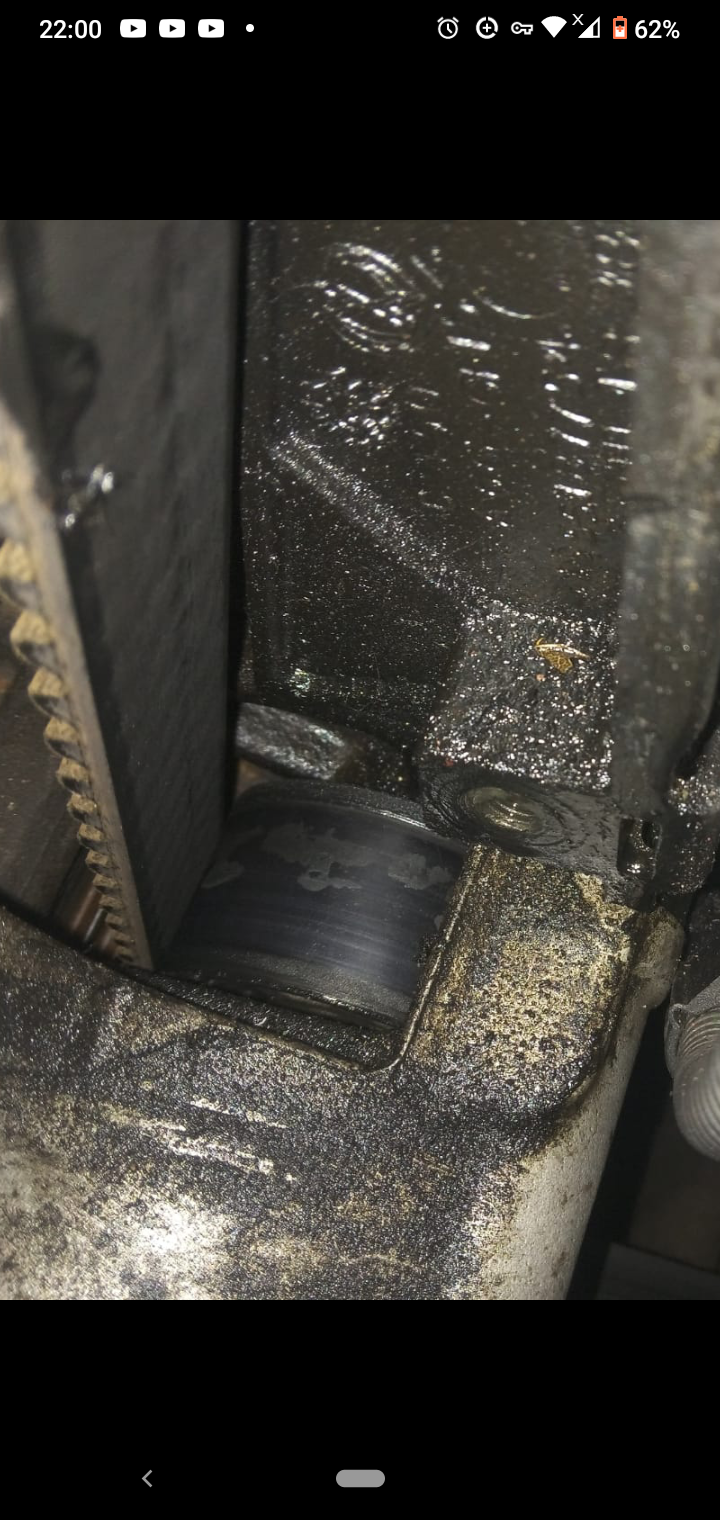

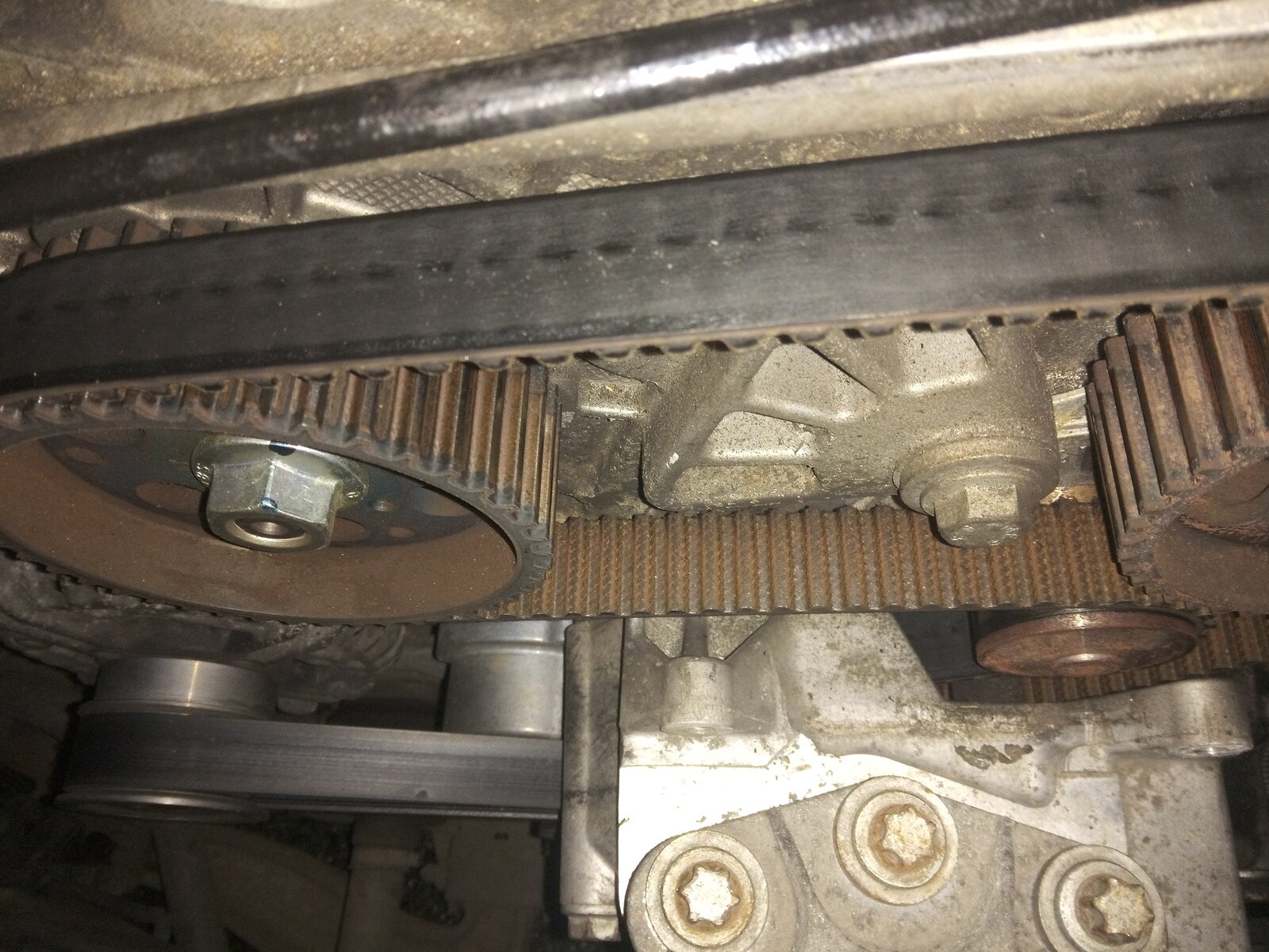

I removed the timing belt top cover today on my 2007 Vauxhall Vectra 1.9 cdti 120 bhp. Just to inspect it for maintenance reasons.
I noticed a missing bolt on the timing belt cover and near this bolt was oil on the outside area of the timing belt cover. because the bolt was missing I think oil has got in as the timing belt looks contaminated somewhat with oil.
do you think i will be ok to wipe this down with wet wipes /water ? thanks
Any oil in the timing belt area doesn't come from a missing bolt but rather from an oil seal on the camshaft or crankshaft that is past it's best.
Oil contamination of a timing belt isn't good but nothing to panic about unless it's been like that for a good while.

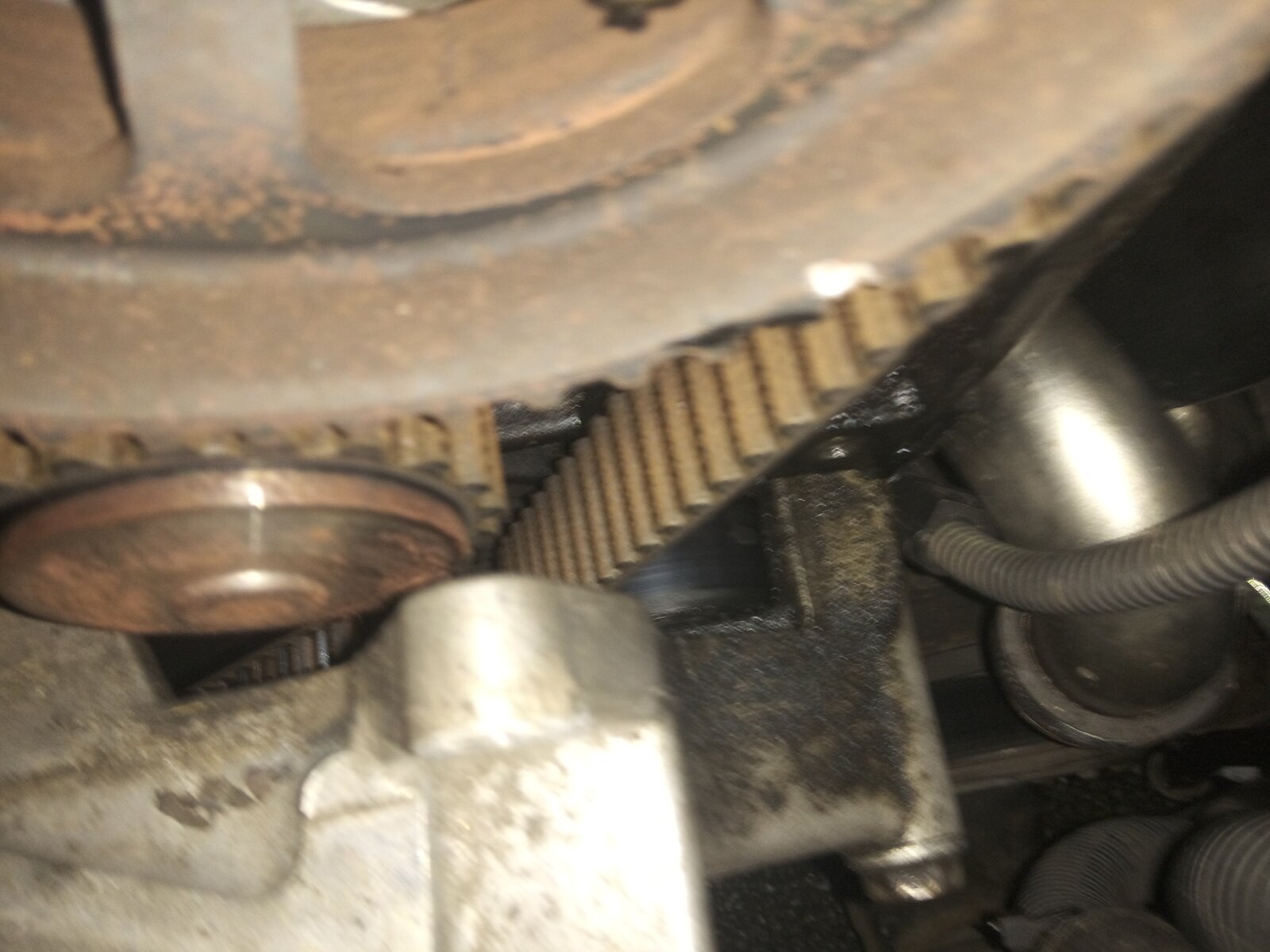

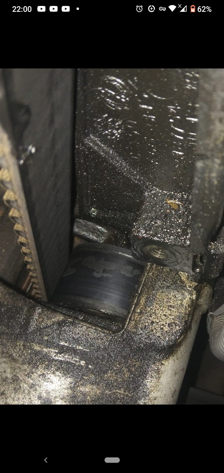

Thanks John. I wondered if the oil had got in from outside the belt area as there is wet oil outside belt, near where the bolt is missing for timing belt cover. here are some pics of the belt /area with oil contamination
please see 3rd picture, I think it shows most detail of problem.
can i use wet wipes to clean oil off the belt ?
thanks

There is a bit of contamination there but it's not too severe.
You need an oil solvent to wipe the oil away so wet wipes won't do any good.
Maybe a rag wet with white spirit or whatever will do....modern belts have Kevlar in their construction so aren't affected by solvents like the early types.
John :)
