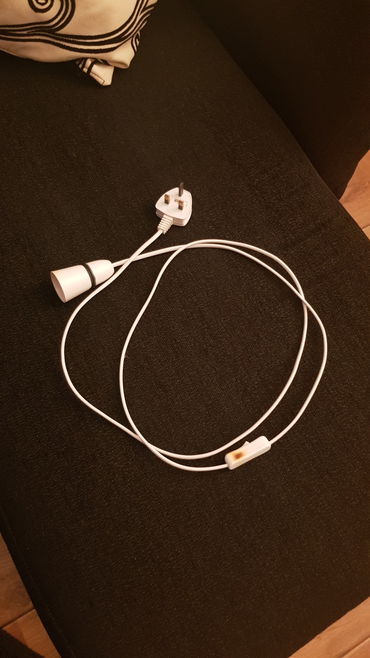

Hi All,
Question to expert diy! :-)
how do you call this? gone on amazon and b and q website but without luck so far.
there is a head for a bulb, a switch and a plug and it goes inside a light appliance but it has overheated so need a new one.

The part that appears to have failed is an inline cord switch
https://www.tlc-direct.co.uk/Products/DT102.html
When you fit an energy-saving LED lamp in future, the electrical load will be much lower so the next one should last longer.
You will also need some small screwdrivers.
Cut away the heat damaged ends of the wires inside the old switch. It will be less than an inch.
