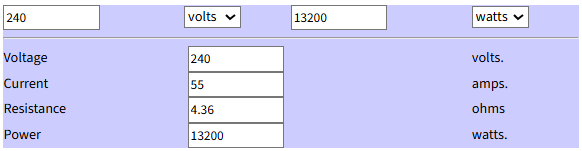

13,200W / 240V = 55A. (actually 52.8A @ 230V but don't bother with that)
45A x 0.3 = 13.5A + 10A = 23.5A

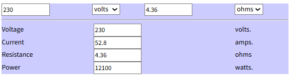

The Wattage figures quoted for your appliances will have been given for 240V therefore 13200W/240V=55A.
To calculate for 230V is not simply a matter of dividing 13200 by 230 because If the supply for these items is actually 230V then the Wattage and Amperage will be lower - that's how it works because their resistance is the constant factor; not the Wattage.
So 55A x (230 / 240) = 52.71A (not sure how I got 52.8 before) and only 12100W.
Ah. That says 52.8 so not quite right.
I'd be more likely to assume it's given for 230V, that's the european standard.
Either way, induction hobs are far from a purely resistive load (it's in the name) so you can't assume the current drops with the voltage.
