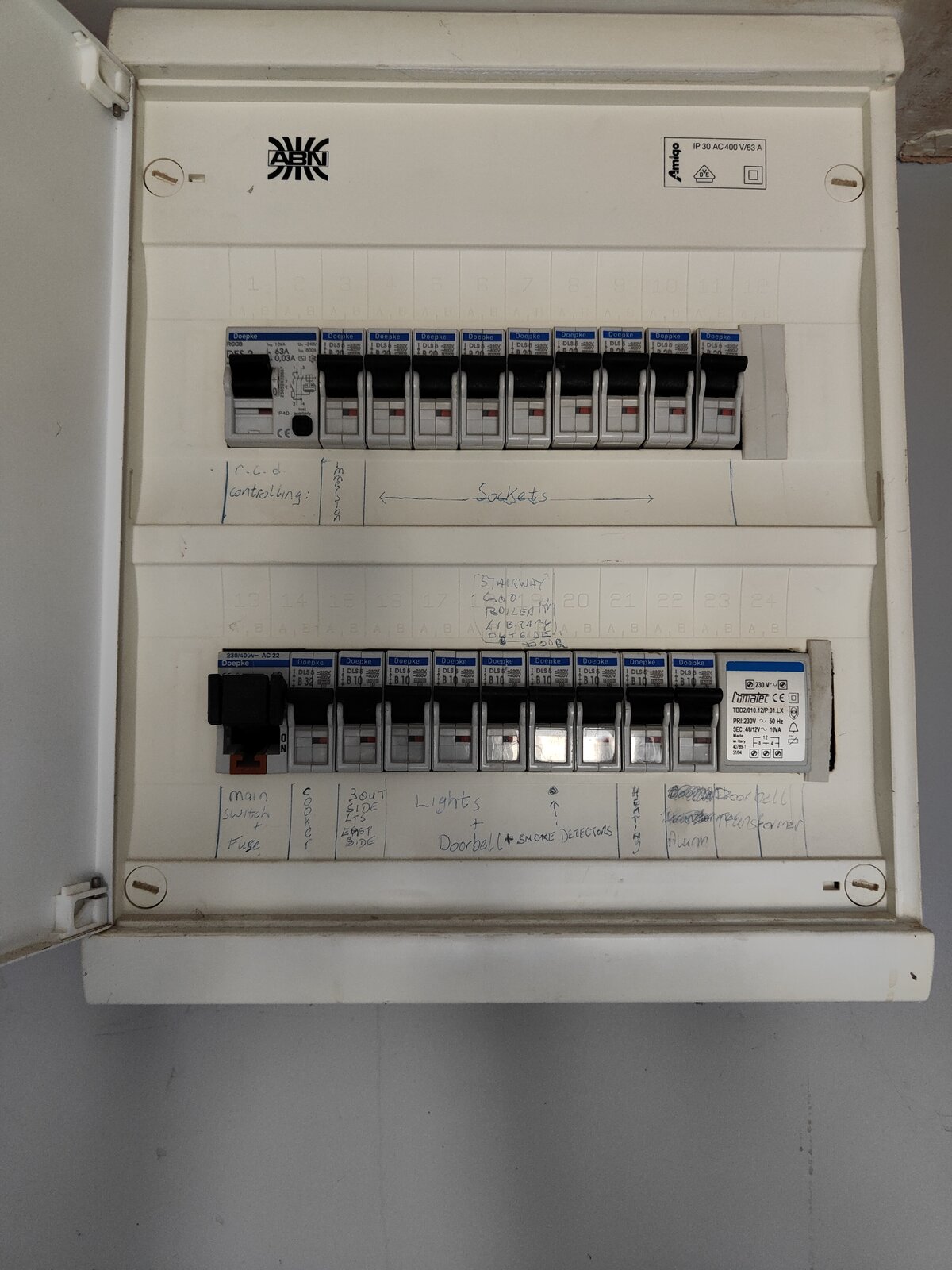

This is my electrical panel - am I correct in thinking these are 10amp circuits ?
B10 is 10 amps
B32 is 32 amps
It is permitted to run lighting circuits in 10A, often done in offices and shops with lots of lighting.
In a house it is a rarely needed, except perhaps for people with lots of energy-wasting downlights and spots. With modern LED lamps, unnecessary.
10A circuits must have 10A rated switches, junction boxes and lighting fittings. Many are, if they are standard size and reputable maker. Some small and novelty devices may not be, especially cheap imports which may be 5A or 6A
