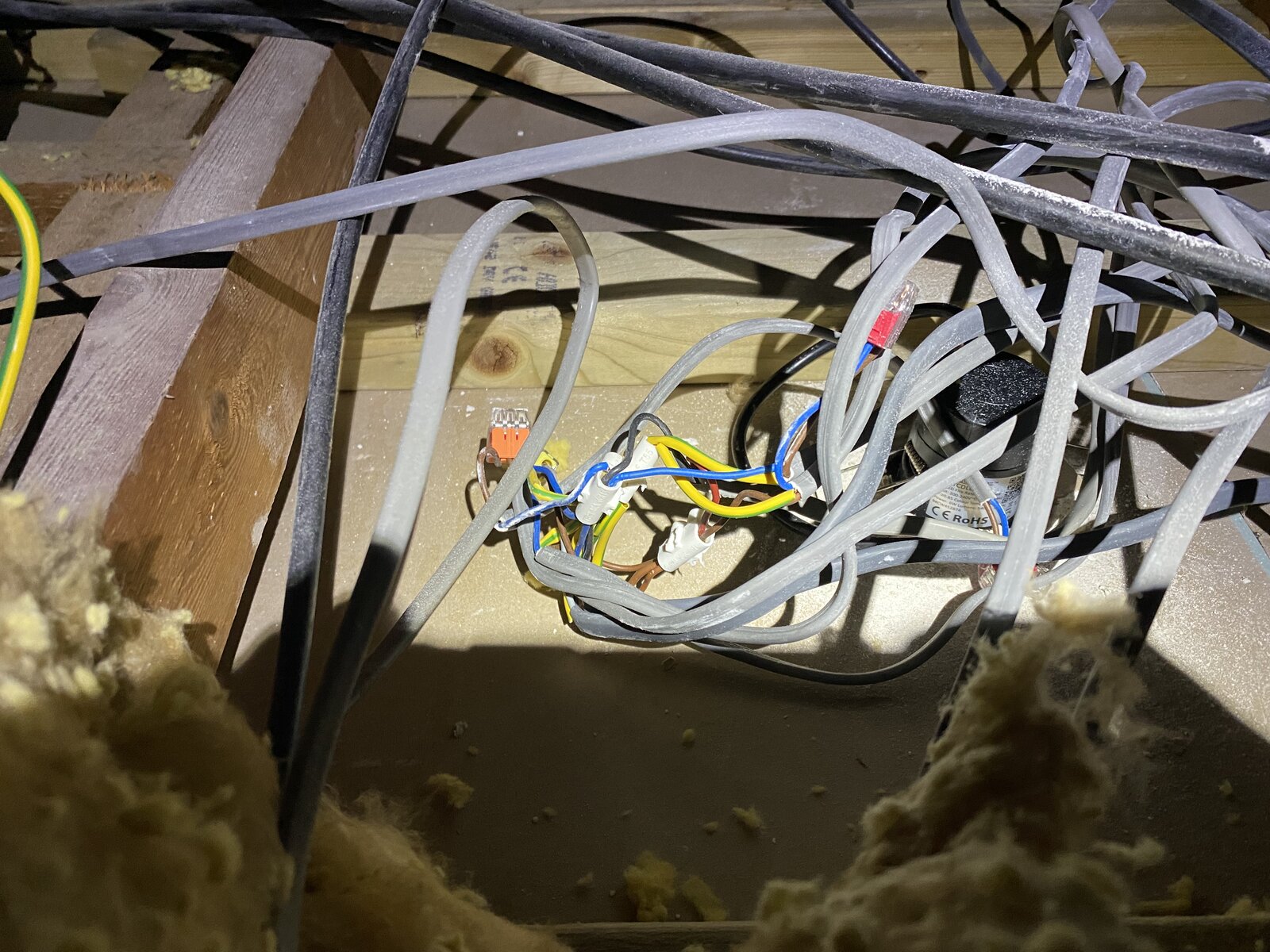

So, I am having a builder to redo my main bathroom and he has called-in a part p registered electrician (or so he says) to do the electrics.
What has been done is:
-fitting shaver socket
-fitting LED downlights
-fan and related isolator switch
-fitting a switch (out of the bathroom)

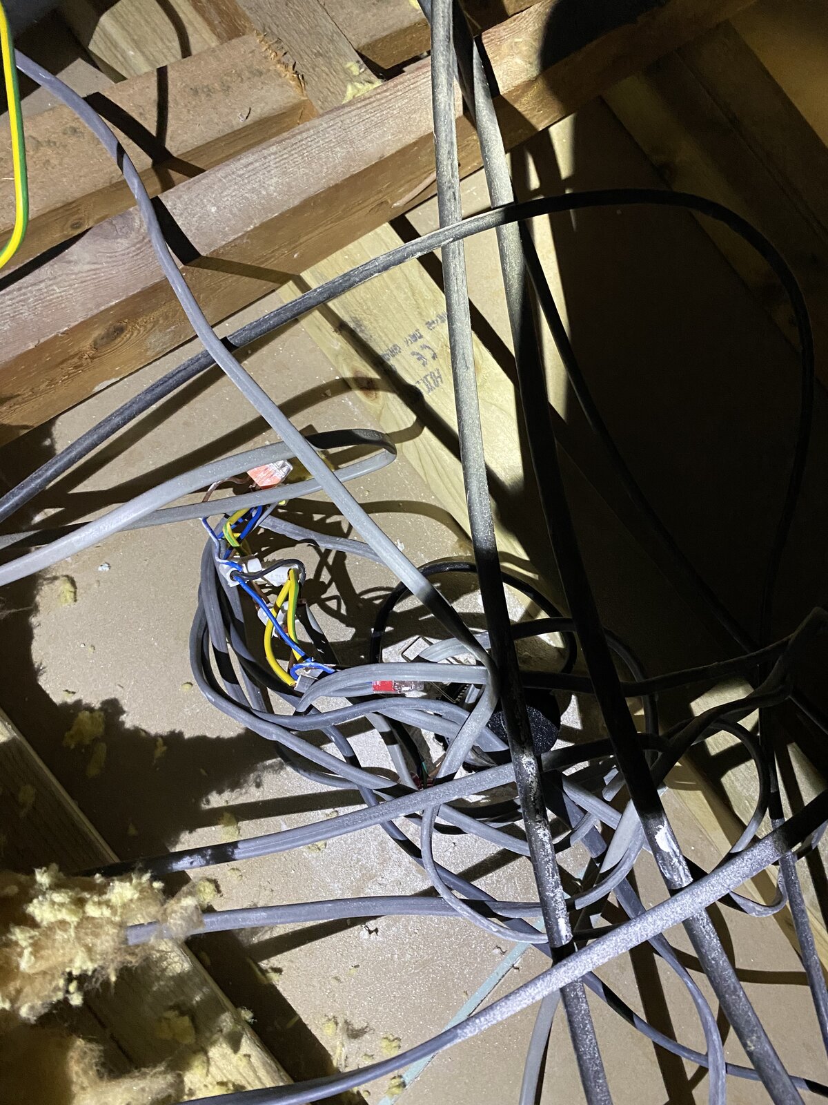

Now, today I was checking something in the loft and I've seen how the connections have been done. He has used WAGO-style connectors but not in boxes. The connectors are basically just hanging there on the plasterboard with no protection.
Now, I understand that, as the loft it's not boarded, this does not require a maintenance free setup, however, is it OK to have cables connected like that?
Just for the records, I live in England and the circuit is already MCB and RCD protected.
WRONG very Wrong and when he does put it right make sure all single insulation is inside the box ie Brown Blue and Cpc (earth)....And tell him you know what the P stands for in part P and he is one
that's what I suspected :(
Tomorrow the builder is here again so I am going to have a chat with him. In case they try to claim it's OK like that, is there something that I can refer to to prove my point?
I can do basic electrics but honestly when it come to regs I am not very well versed... that's why I don't do this stuff myself, although I feel like I'd probably would have been way more scrupulous.
Take photo,s...ask who he is registered with ask about a cert and then quote reg 526.5
Every termination or a joint in a live conductor ( L and N) or a pen conductor shall be made within one of the following or a combination thereof:
(i) A suitable accessory complying with the appropriate product standard
(ii) An equipment enclosure complying with the appropriate product standard.
(iii) An enclosure partially formed or completed with building material which is non-combustible when tested to BS476-4
In other words tell him to put it right and use appropriate junction boxes
There you go…
It goes without saying that I also need to put the insulation back

You should also tell him there is no such thing as “a part P registered electrician”. Part P is one sentence in the building regs not a registration scheme.
Perhaps they are only temporary fir the moment?
Yeah, that is how I intend to approach the subject with my builder. If he says it is temporary, then I’m happy. If it’s supposed to be the finished work then I’ll point out why it’s not OK. I’m not competent enough to say if the wiring itself is done properly but at least the “cable management” part is not
OK, Just had a chat with the builder... it was supposed to be the finished work (electrics-wise)
:censored:
Try telling that to the people who have done their trials and been inspected and hold their part P registration documents.
Next thing you know he was also not planning to provide minor works certificate :mad:
If he does not put this right, I am considering suggesting him to dismantle the stuff he has installed and call in a proper electrician and deduct the expense from the agreed price for the whole job. Especially in a bathroom, I think it is unacceptable to have the modification not tested.
I think your first course of action here is to offer for the builder to sort it out and engage a 'proper' electrician who will issue the appropriate paperwork or if they wont then you'll need to get your own electrician to quote how much it will cost to resolve and provide the paperwork and deduct that from what the builder is still owed. It's rather worrying that there are people out there who carry out work like this to such a poor standard when you the customer are happy to pay for it to be done correctly.
