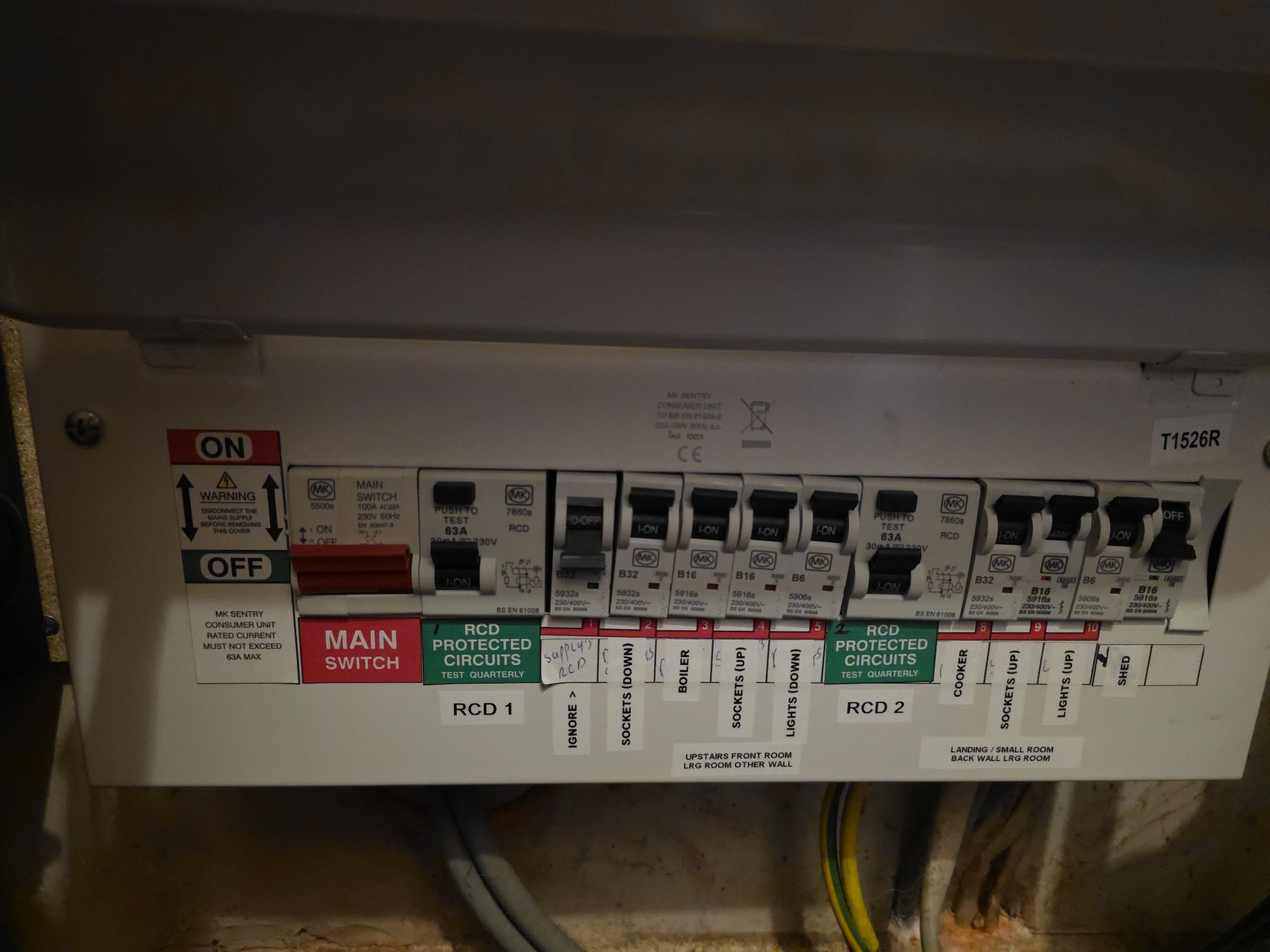

Hi all,

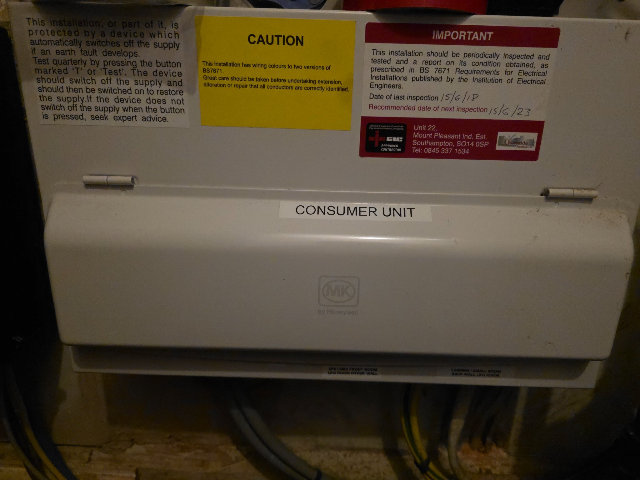

When we moved in to our house back in 2018 we found the CU had been upgraded (seemingly anyway, it looked new to me) but when I mentioned it the seller could not provide certification. As part of the sale we got an electrician out to make sure all circuits were safe and they provided a report.
We've not had any issues since but in the interests of safety (and to provide certification should we decide to move) I thought it might be good to get an electrician out to upgrade the CU.
Now its an MK model (pic attached) with 2x 63a RCDs and a load of MCBS. I was thinking it might be more cost efficient for me if an electrician were to swap the MCBs for RCBOs if the existing case will take them. It seems a shame to rip the whole thing out when it’s not even 10 years old.
What are your thoughts. Will the cost difference between a whole new CU versus swapping out MCBs be negligible? Is this even something a sparky would consider? Just trying to get it clear in my head before I request a couple of quotes.

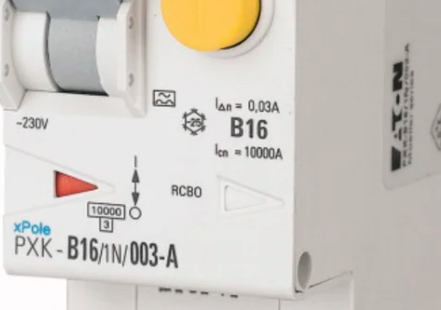

MK is an expensive make, so swapping the MCBs for RCBOs and getting a new bus bar kit, will likely cost more than a new Fusebox consumer unit populated,
Maybe, but per current TLC prices :
Fusebox: Type A RCBOs ... £13.10+ VAT
MK: Type A RCBOs ... £10.60 + VAT
Appreciate the advice - another consideration (again I want to be as informed as possible before I accept a quote) I've read about is RCBOs that need to be bidirectional should I opt for a plug in solar panel system when they're made available. Should I state to the sparky that I want them to be bidirectional or will it be assumed/expected that they will be in 2026? If there's little cost difference I'd elect for all to be bidirectional rather than the specific radial I'll be intending on using.
Whats wrong with it? Couple of C3s maybe
We were never provided with certification so cannot guarantee the previous house owner didn't just DIY it. Also I like the idea of RCBOs should we ever have circuits tripping - and DIY solar requires a bidirectional RCBO apparently so rather than getting a sparky to quote to replace a single MCB, I thought I'd enquire about getting the whole thing replaced so all circuits are safe and certified.
It’s a bit of an amateur installation but if it’s not causing issues then leave well alone
As a matter of interest... other than for the fact that the MCBs are all a bit wonky (which may have arisen subsequent to the initial installation) what is it that tells you that the installation is "a bit amateur"?

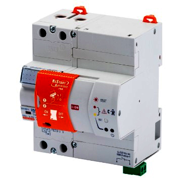

I lived for years with just two RCDs, I keep considering an improvement like one of these auto resetting types temprcd.jpgor one with warning X-pole.jpg built in, but it's a lot of work for little return, and I never got around to it. This house had no RCDs in main house, so when doing the job went down the all RCBO route, for one thing it makes the consumer unit 4 modules shorter.

The RCDs in the existing unit are Type AC which are unsuitable for solar, EVs and the majority of everything else that is in use today.
There is no surge protection either.
Suggest the whole lot is replaced, preferably with items from a manufacturer who actually designs and makes their own stuff.
