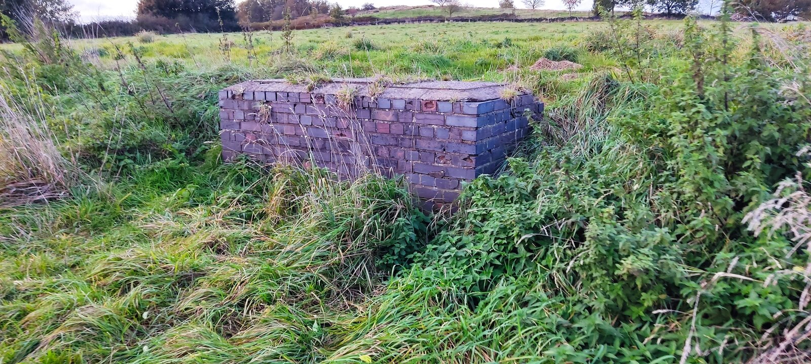

A property in looking at has three manhole covers together which didn't add up to being any of the usual things.
On lifting one of the manhole covers, I could see this on the wall inside.
I am presuming that they are mains electricity supply lines?
If they are...
Does the utility company need vehicular access to these? It would pedestrian access suffice?
If required in the future, could a domestic supply be added to this (obviously by the correct people)
Three phase electrical supply.

There are three of these manhole covers in a row. I only lifted the right hand one but I could see the cables sent straight down into the ground below and through to the middle manhole cover.

Certainly fits being a three phase mains supply, the colour's are correct. But what are those fittings on the end? I've never seen anything like that before. The way the bright metal tapers down to the fitting, could it be hoses, hydraulic or some such?
Are the 3 manholes fairly close to each other and in an area of paving slabs of possibly a concrete surface?
Photos of the area around, including gates and fences would help
The three of them are all on the top of that. They are basically touching each other they are that close together. The two outer covers are those heavy concrete ones. The centre one is a metal cover with CEGB written on it.
I have found that CEGB stands for Central Electricity Generation Board. Basically the National Grid from a few years back.
When I took that photo, I'm stood on a gravel track suitable for driving along. There is a gated access to the track 30m or so to the left of the photo.
After you go out of the track, you go on to a shared farm track which is only really suitable for 4x4 vehicles, this then takes you up to the road.
