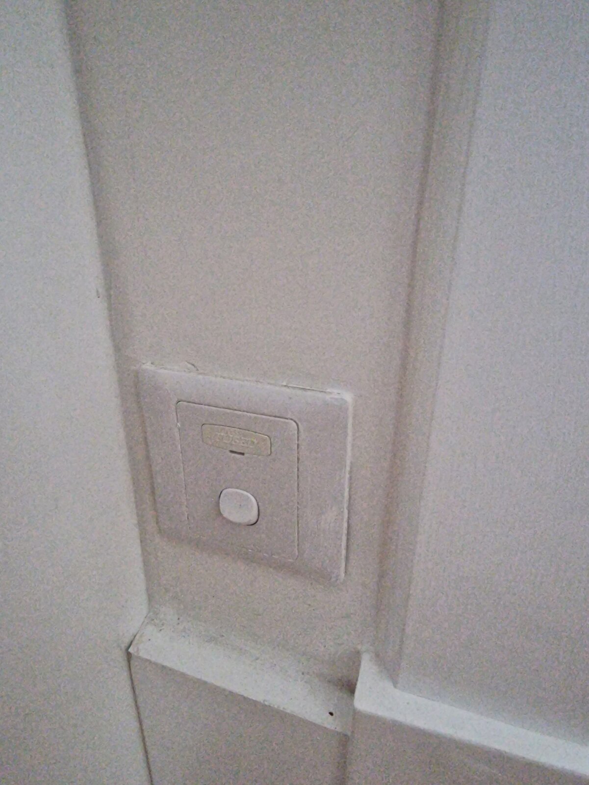

Can I have a thermostat attached to this radiator, or even a timer switch to replace the socket with?
I'm looking for a better solution than the on/off switch. My bathroom is constantly cold and I want to have some control over how much electricity I'm using...
I take it the switched fused connection unit is outside of the bathroom?
If so, it may be easy to fit a regulator above it.

Precisely, the switch is outside the bathroom. Do you mind sharing a link to one, as I don't know what to search for?
Do I add this, in addition to the existing switch?
How about a timer switch though? Is that possible?

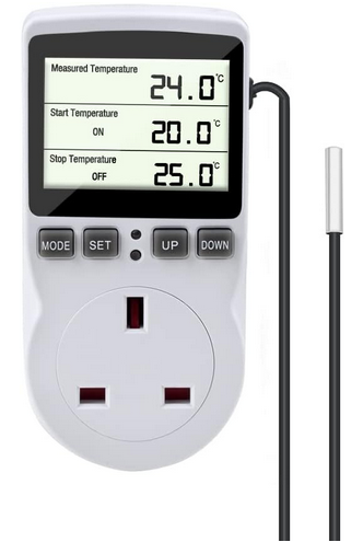

I used thermostats to control my beer brewing which can handle 13 amp they are also used for reptiles, and can be bought as plug in devices, but it would mean two devices one for time and one for temperature.
When I get to PC I will see if I can find a link. With water easy fit a programmable TRV.
The Inkbird ITC-306 is a plug in thermostat with a sensor so sensor can be in bathroom but thermostat in the location where plugs are allowed. When I came to do beer the 306 was not around, so use an STC-1000 there are many more plug in devices 1700612392021.pngwhere the sensor is not part of the thermostat. This advert seems to do what you want but I can't find the current rating, and this is the problem, loads of devices where the sensor is battery powered so OK in a bathroom, but most seem to be limited to 3 amp. So not really suitable for a towel rail.

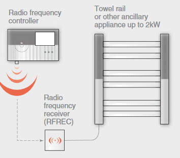

This is designed again for a towel rail however to work it would need to be in same room as towel rail.
