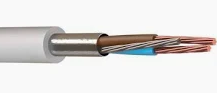

But it would seem silly for an electrician to take the chance, so question is are you sure there is no earth? There was at one point a move to using alitube cable 1725879534785.pngit did not catch on, two expensive, it was designed so you did not need RCD protection for the cable, this one shows an earth core, but not all of them had an earth core.

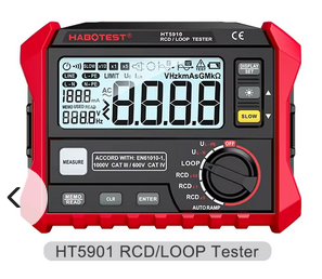

As long as you have tested the earth, there is really no problem taking it from else where, but the cheapest tester I can find 1725880811872.pngis £64, so is it worth it?
