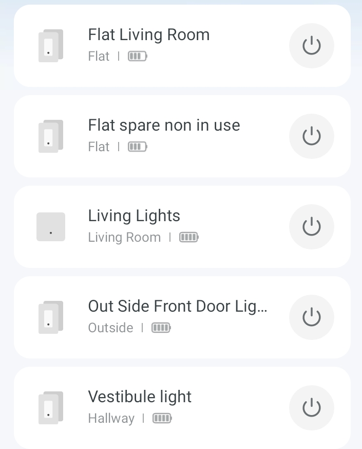

Also making sure the batteries are charged, my google "Home" app will work all my smart lights, does not matter what make, but the dedicated app there is so indication of battery state. View attachment 387485 Only when using the app for that make, can I see if the batteries are OK. And I have no idea when using timers, if that timer is in the device, the hub, or part of Nest Mini system, I know I can say "hey google turn off bedroom lights in half an hour" and it does, but no idea where that timer is.
There is also the power up state. In the main, a bulb will turn on when power is restored after a power cut, but tried to get an outside light to do that last night, and it failed. The wall switched seem to be reverse, lose power, and on return they stay off. Some will not change state in a power cut, I use light switches with batteries because they do not change state with a power cut.
