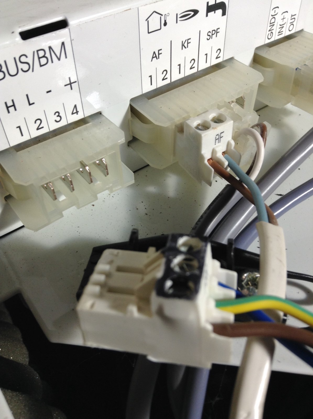

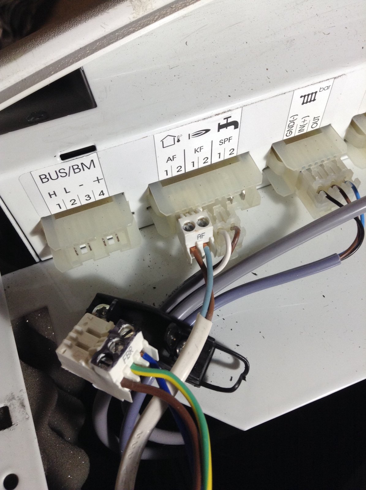

Hi all I've been looking and scratching my head if i can do the hive on my oil heating only system i have in France.. Its an Bosch olio condens f3000 (only sold in France) same as a Geminox FCX.. There was an internal room stat in the lounge (was a 3 core bosch reg103) but when i opened the rear of the boiler the terminal block was a 4 way so i wasn't sure which way it plugged in because it had been butchered a bit and i didn't want to plug in wrong and blow a board! . My electrical friend came out with me last week and thinks i may not be able to fit Hive due to the boiler using a BUS system and hive can't cope with this.. Is this right ??? here is the photo of the rear ... thanks for any advice ... Would be lovely to turn on heating before i leave UK to a heated house...
