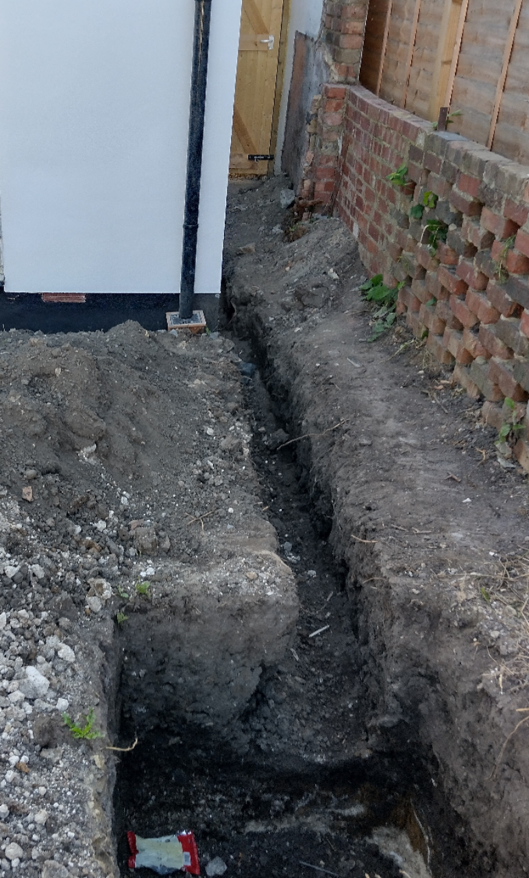

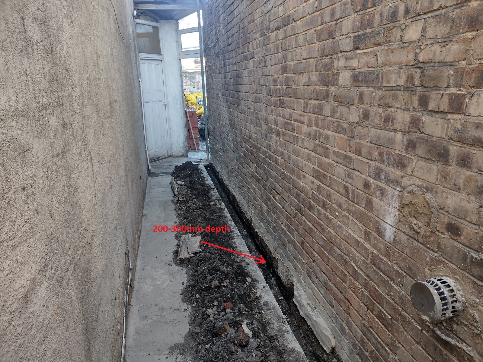

I would like some garden lighting
1. Is it best to run the SWA cable directly from the consumer unit?
2. Is it okay to lay the SWA cable in the chase pic 1? The depth of the chase is between 175-300mm
The chase is filled with a membrane and 20mm gravel
The SWA cable would then run along side a plastic pipe (depth 300-450mm) which would be connected to a soakaway crate (depth 800mm)
The soakaway/ SWA cable will be filled with gravel, sand and soil
Is there anything wrong with the above? If so, what can I do to get around this?

In pic 1, the depth of the chase is 175-300mm. Can I place the swa cable here? The chase is filled with 20mm gravel.
Generally is it okay to place gravel on top of swa cable then back fill? Or will this damage the cable.
And I plan to use one cable for outside lighting like a floodlight and one outdoor plastic socket.
Gravel with sharp points can damage the outer sheath of the SWA which will then allow moisture to reach and corrode the steel strands of the armour
So is there a way around this? For example, is it acceptable to duct the cable with something like solvent weld plastic pipe. Then place the gravel on top?
You could do that. Alternatively, if you are concerned about the possibility of gravel damaging the cable, you could use sand immediately around the cable, and then the gravel.
