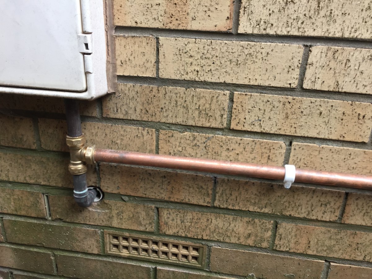

Are compression fittings allowed on gas pipework ?
And even if they are then the dummer should have at least cleaned the corrosion of the existing pipe before making the joint to it.
Has he used compression on the gas pipes inside the house ?

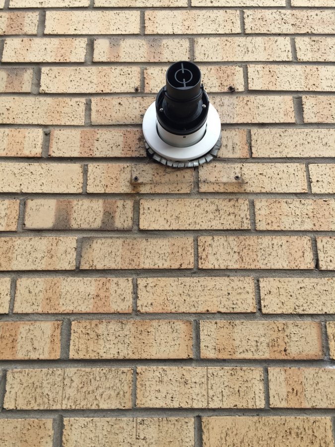

Back to the picture of the top of the flue, is that white blob to the right daylight from outside?

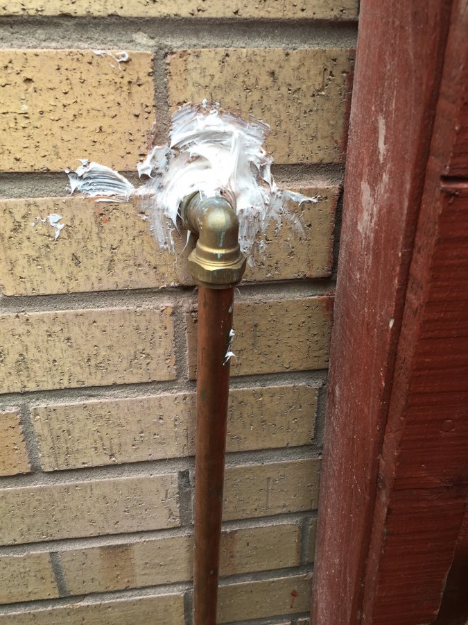

It's sad for you because the job is lousy, the chap doing it was both hamfisted and couldn't give a damn (just the sealant round the pipe entry shows this).

Gas Safe are unlikely to be much help as the flue has screws in it and the compression joints are perfectly allowable if they are accessible. In other words, their inspector would be dismayed but wouldn't have enough to enforce upgrades of the general installation.

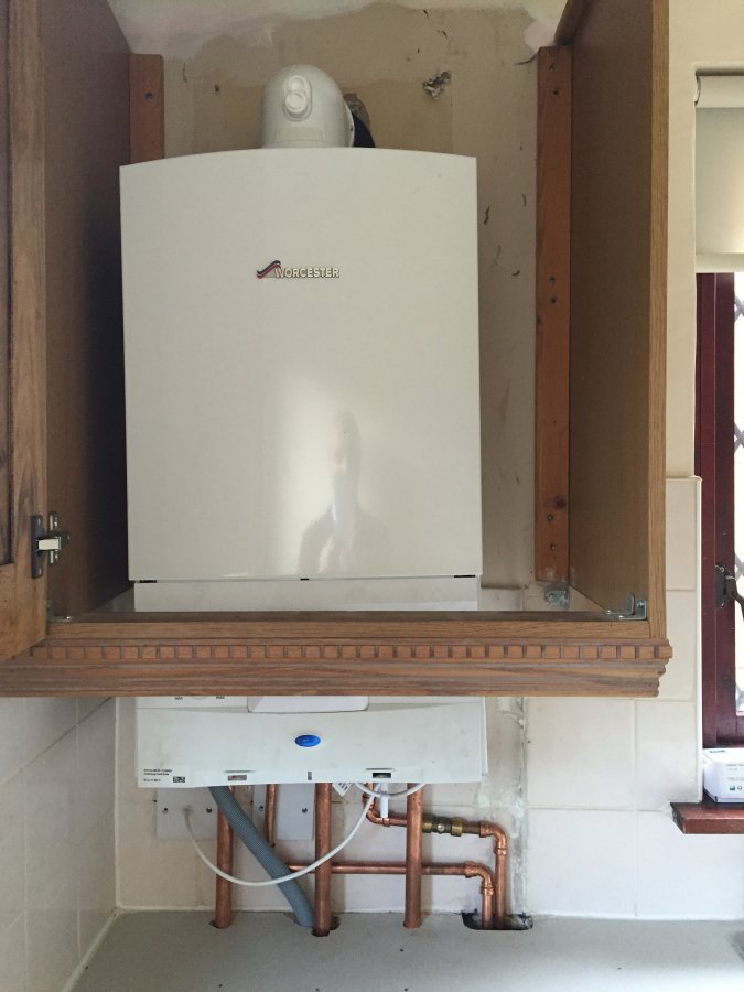

Wow.... ! The boilers not even straight on the bloody wall!
So looking at the picture you took, underneath the boiler inside the cupboard, he's tied the filter to the gas pipe ( with the 22 comp elbow )

You are right, I do not have the qualifications to judge, but I do have the experience to see when a bodger has been at work. Yes I realise now that compression joints may be used on gas pipes when the joint is accessible BUT solder jpoints are ( according to the three GasSafe registered gas fitters I am friendly with ) prefered.
And is copper oxide dust a gas tight material ? It isn't when dealing with compressed air.
