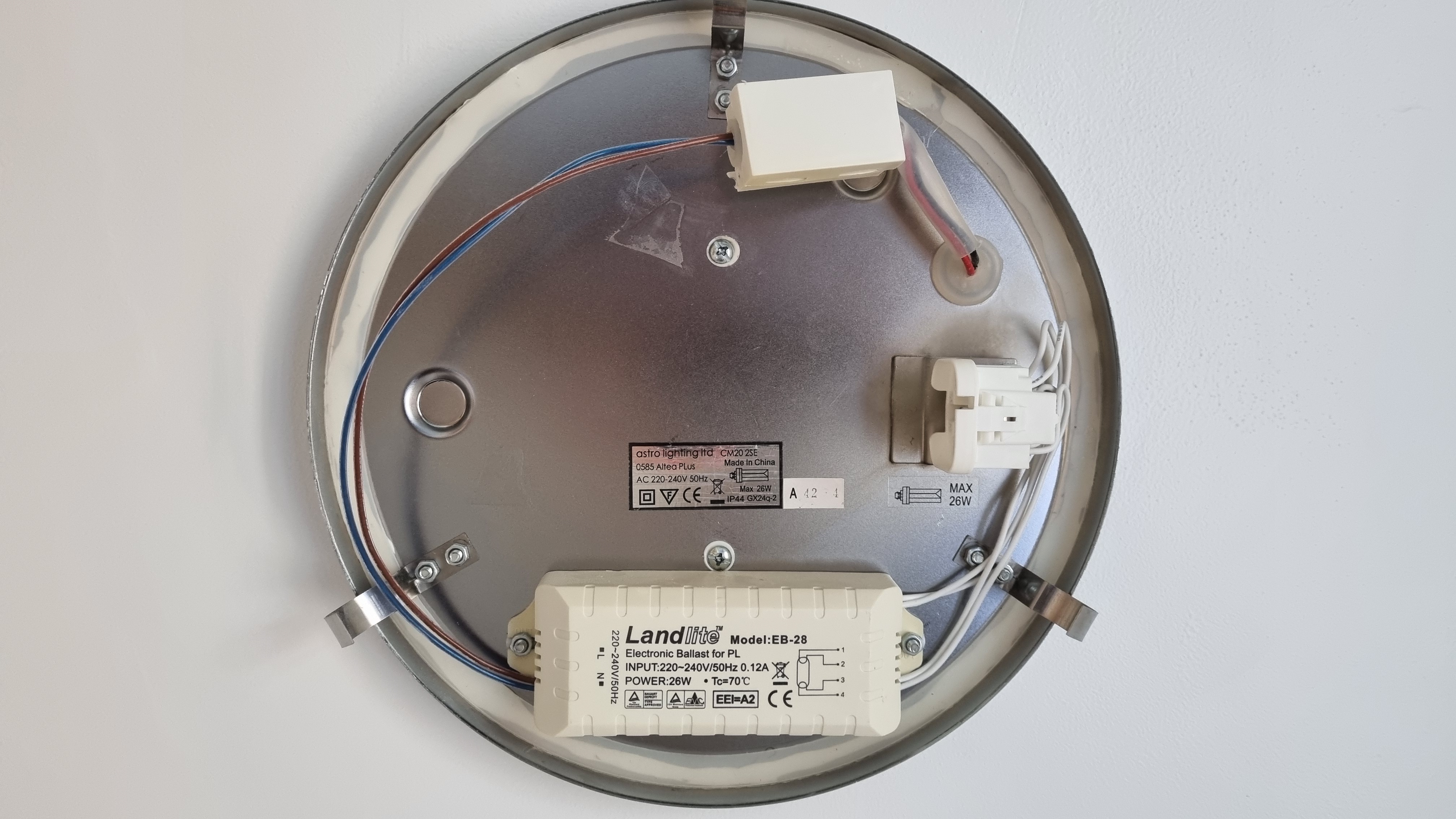

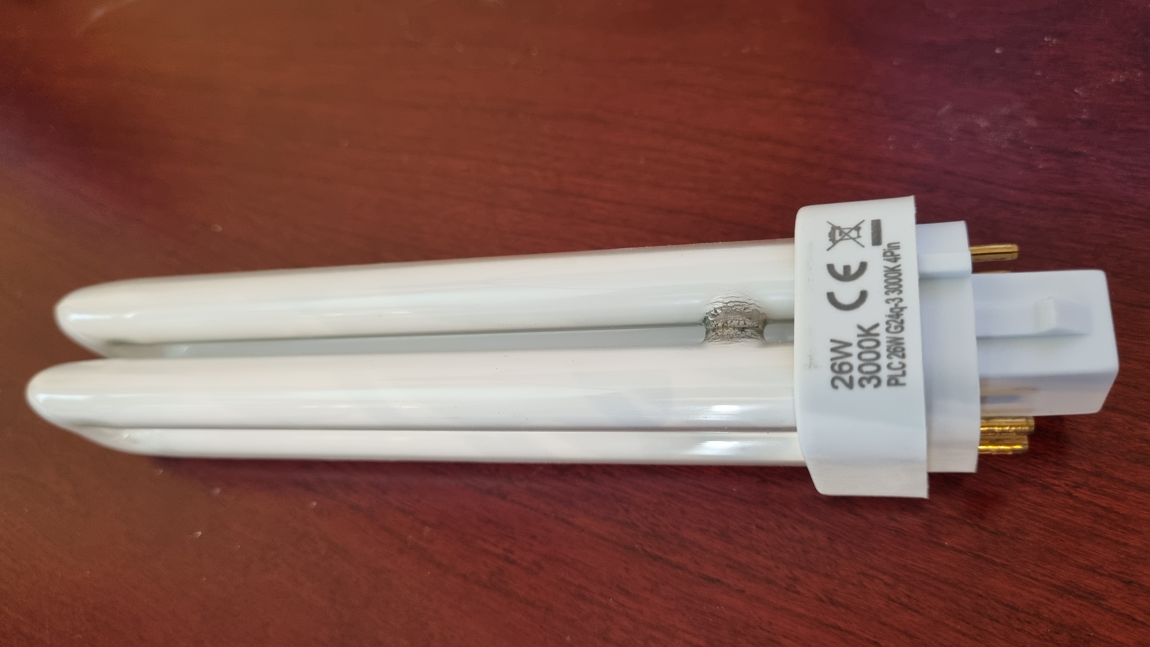

I have a light fitting in a bathroom that is around 14 years old and uses a 26W 835 G24q-3 4 pin bulb, like the following:
The bulb has lasted 4 years and now no longer works. It has now become more difficult to purchase this bulb and our local screwfix no longer sells it. I'm also not 100% sure if the bulb has gone or the ballast, or possibly even the transformer!
I can see LED equivalent bulbs, but obviously the light fitting won't take these without modification.
Can the following light fitting be easily modified to accept a LED G24q-3 4 pin bulb? Here's a photo of the fitting:
Is this a simple case of removing the transformer and replacing with a junction box, so the 240V is supplied directly to the LED bulb?

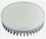

As it is an electronic ballast, at some point likely it will fail. As to LED I am sure there are some units which would fit, be it a strip light 1748944457748.png or 1748944539898.png GX53 lamps, I am sure it could be converted, but why bother? If it is something special lamp-landing_1.jpg I love our landing light, then OK may be worth converting, my problem is I hate integral lamps, I want to be able to change a lamp without the need of screwdrivers, drills etc. If it fails want to simply pop in a new one, and also want the option to make it smart.

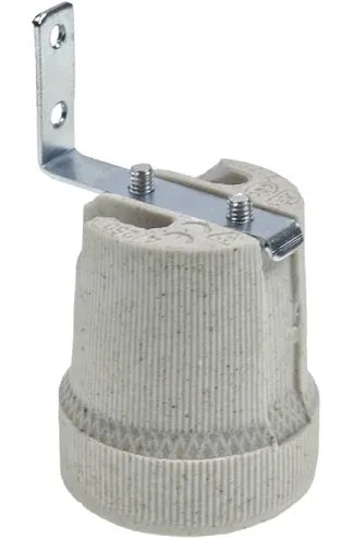

If your handy you can simply screw in a lampholder like this, cutting the brown and blue wires and connecting direct, then fit whatever lamp will fit
Yes, one of my concerns about converting the fitting to use a 240v bulb is the existing bulb holder. Is that specifically designed, especially the 4 cables, to only expect a lower voltage? I described the larger device (Landlite model EB-28) as a transformer, but I guess this is the ballast and is therefore used to start the light fitting and not to reduce the voltage. If so, then I guess the existing bulb holder will be working with 240V, so bypassing the "electronic ballast" shouldn't be an issue?
I guess I could look around for a different bulb holder, but why bother if the current bulb holder can be used with a 240V G24q-3 LED bulb (assuming the electronic ballast is removed)?

Not exactly, but something like that. The only lamps you’ll find to fit that 4-pin socket are 4-pin compact fluorescent tabes like the one you have (*), where two pins go to the filament at one end of the tube and two pins go to the filament at the other. The “transformer” converts the 240V mains to what is required by the 4-pin tube. If you want to use any other sort of bulb you’ll need to change the lampholder to a regular one and remove the “transformer”.

Yes, I was planning to use one of those "weird" LED replacement bulbs, which would then require me to simply remove the electronic ballast. The other "small white plastic box" in the fitting is simply a plastic protector and has a cable connector within it. I assume this gives the light an IP rating for the bathroom.
I was thinking if the red and blue cables coming out of the connector (plastic white box) and going to the electronic ballast were removed, then the 4 white wires from the lamp fitting could be routed into the plastic box instead and connected directly to the black and red mains cables. This should then allow a 240V LED bulb with a G24q-3 connector to be installed in the fitting.

I would hope that the manufacturers of the LED G24q-3 lamp would provide advice about this. If they don’t say anything, then the lamp presumably expects the electronic ballast to still be in place.
Edited to add: reading the description on the web page you linked to, it’s clear that the lamp is intended to work in an unmodified light fitting, i.e. with the ballast still in place: “this bulb works with Electronic (HF); Mains (AC) Without Starter ballasts only. If you need more information about ballast compatibility, contact our customer service team.”

I confess, when I read that part of the description stating "... Without Starter ballasts only" I had assumed it was saying the bulb didn't need a ballast to work, so I had assumed the electronic ballast in the fitting would need to be removed. I agree, the "Installing this lamp.." section does imply it can simply replace an existing bulb, but then it talks about being an alternative to a "standard W PL or Dulux lamp". I'm not exactly sure what this means.
I will reach out to their customer support and get confirmation. It would be great if this is, as you say, a simple LED replacement bulb.
