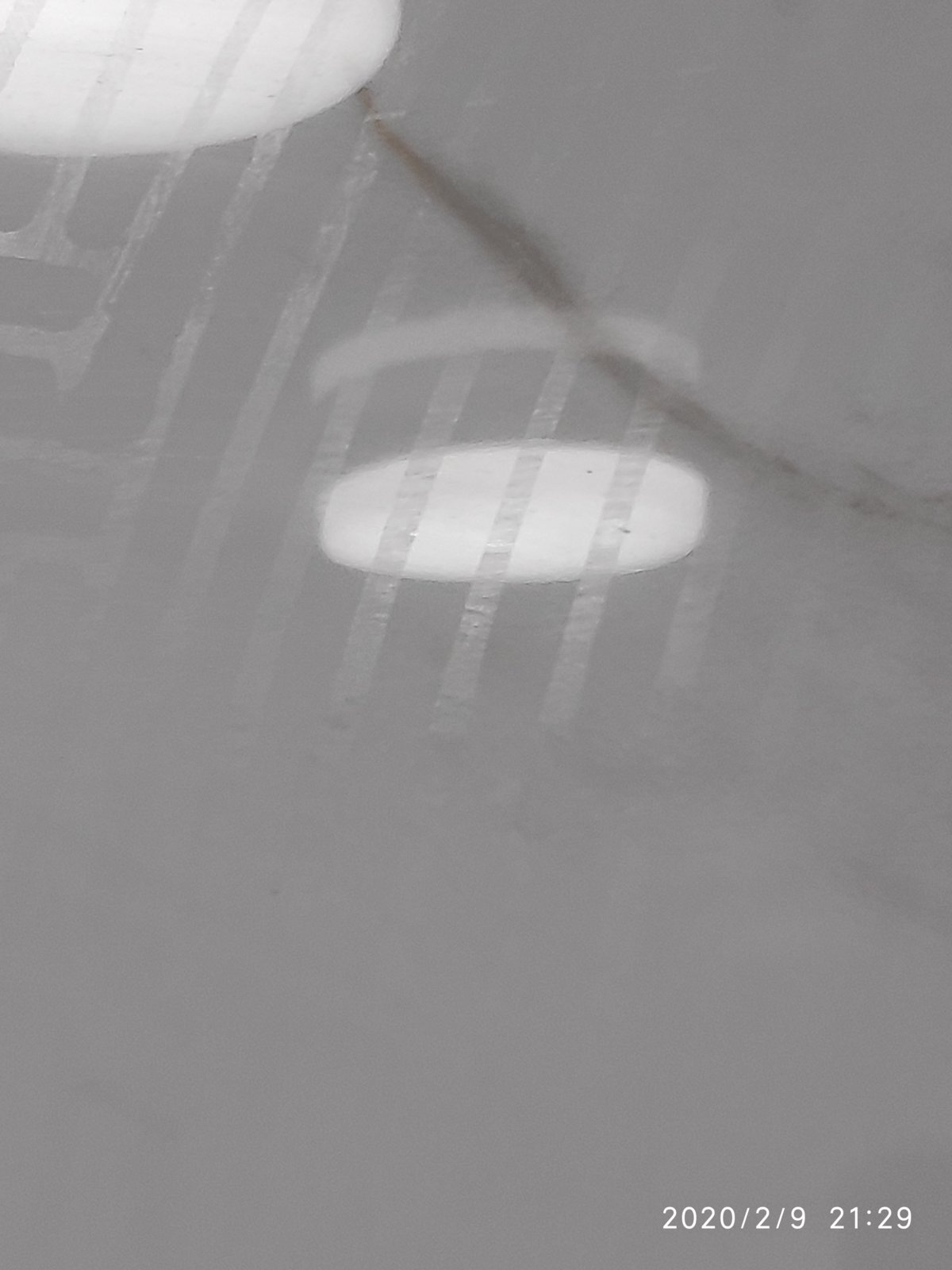

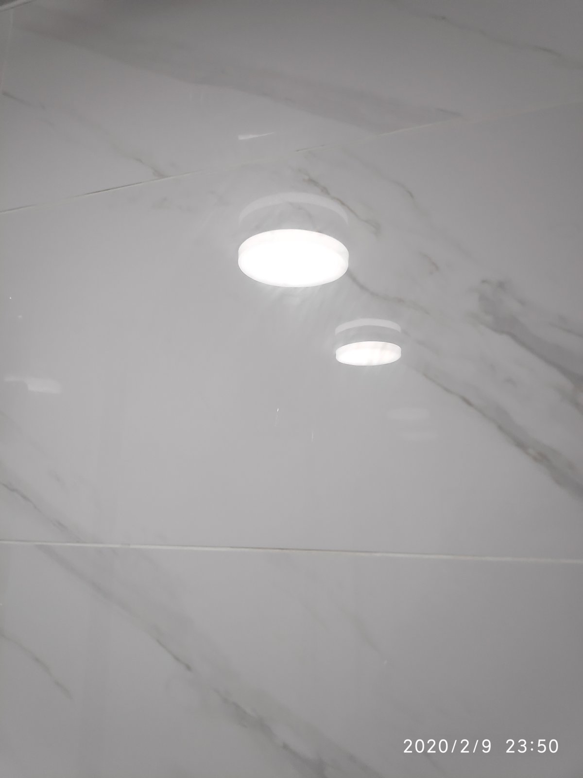

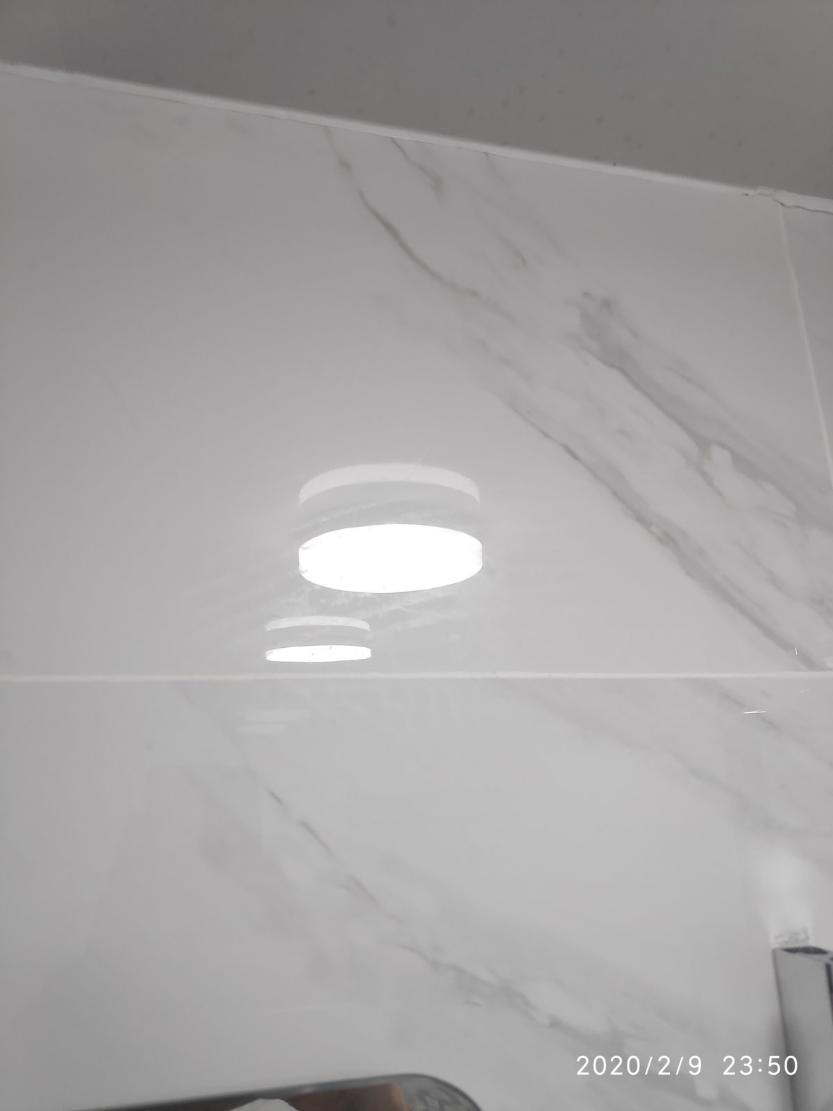

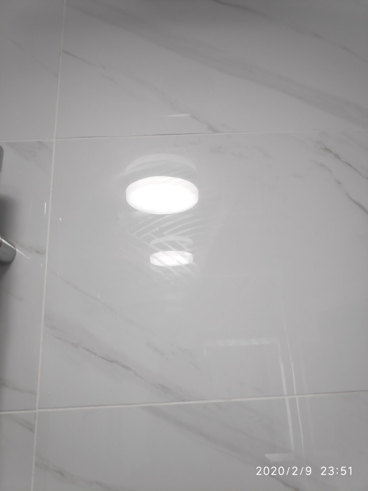

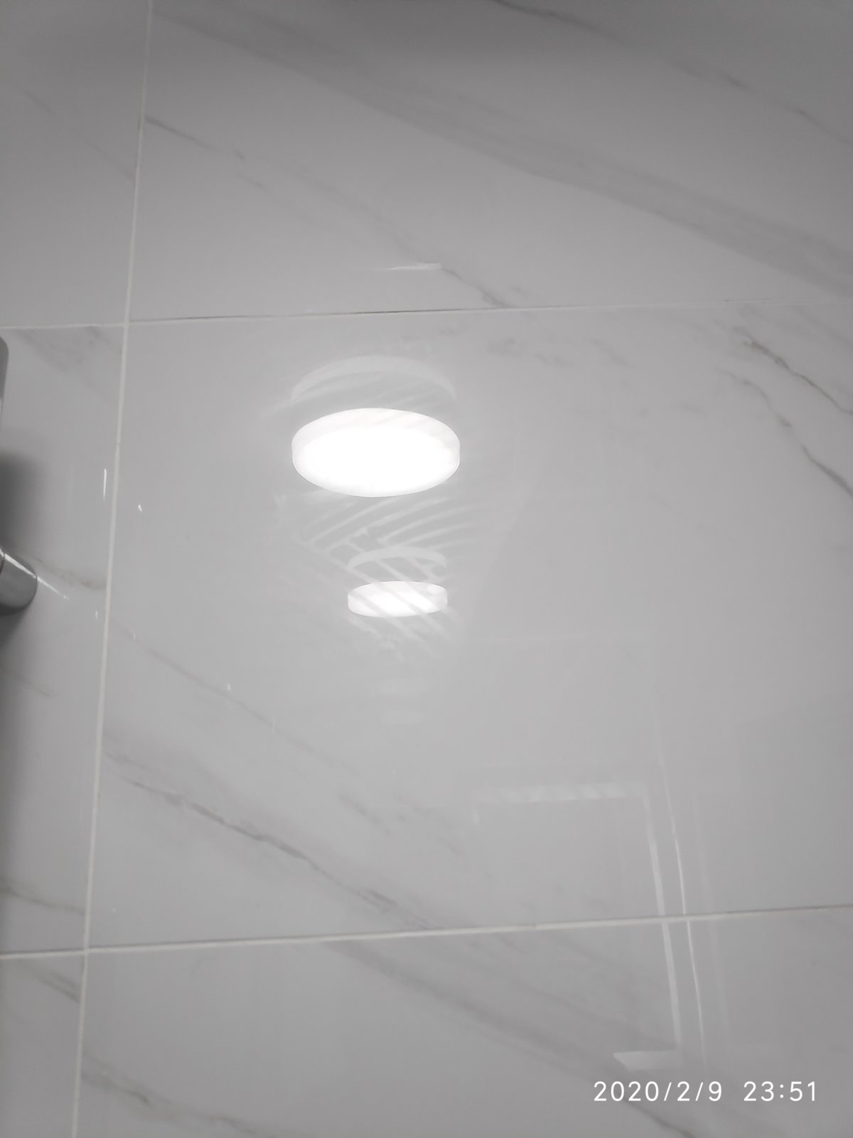

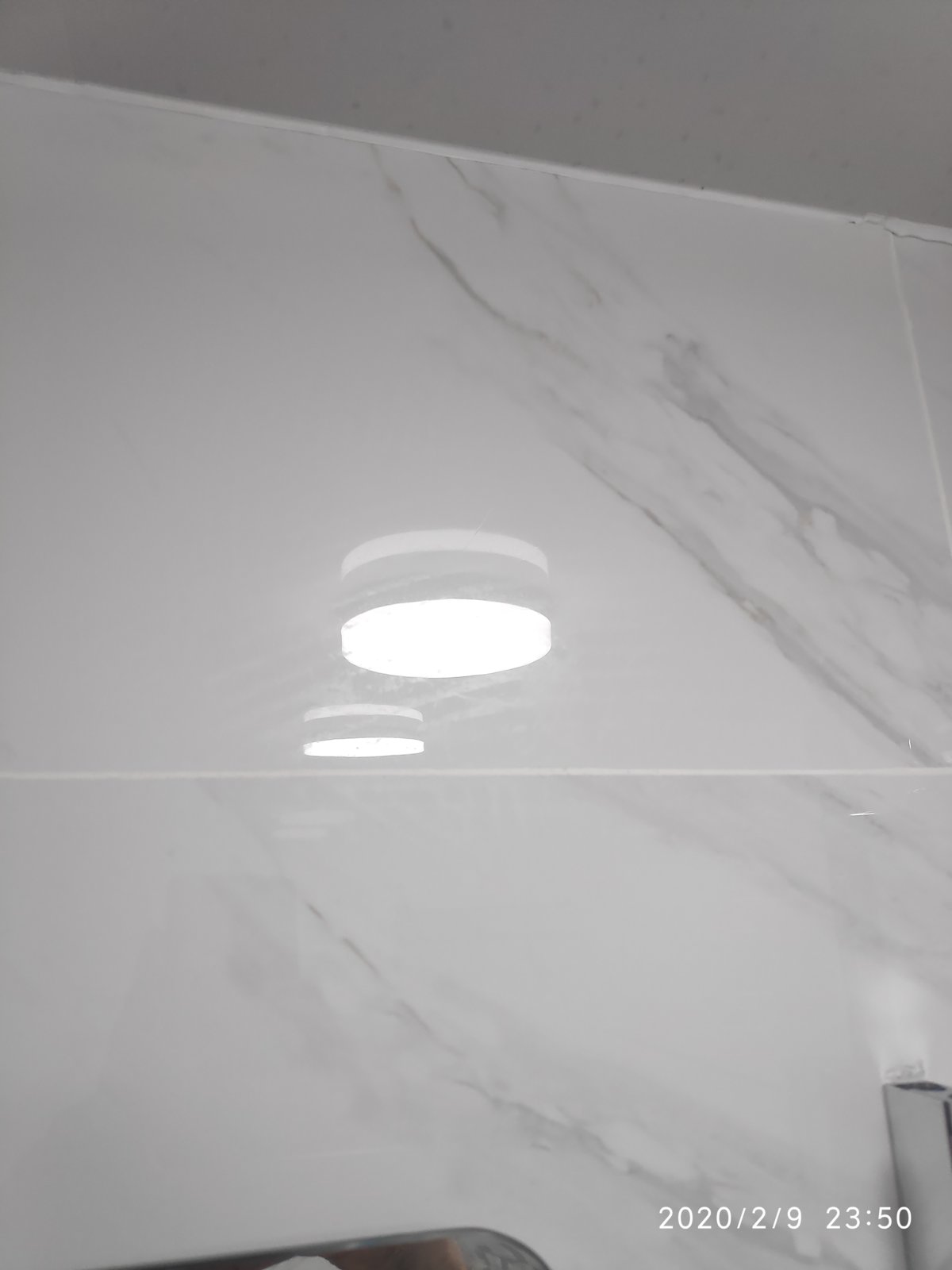

Hi,
I had my bathroom refurb done including new tiles. Once the bathroom was complete we did not clean the tiles as there was other work happening in the house. We have just got around to cleaning the white tiles, but there are so many marks still visible on the tiles and it looks like trovel marks - it may be grout.
I've tried to scrub it off with bathroom cleaner, but it just won't come off. Any suggestions please?
put something in your pic to show scale
also stand back and show the whole wall.
Maybe try a window scraper? - plastic tool with a sharp blade in. Used for getting paint etc off windows. Should be ok on smooth tiles.

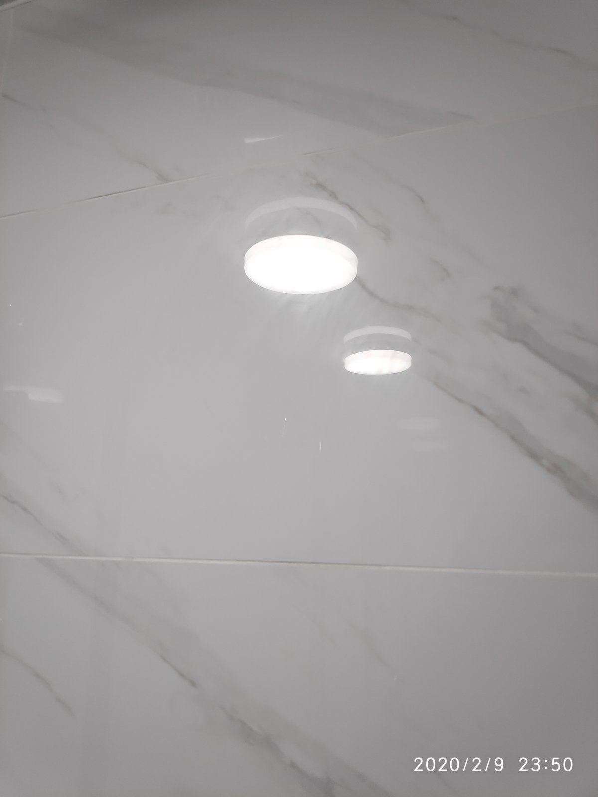

Sorry all the tiles are like this. It's hard to show in pic. Here are some more pic.
Scraper will not work as it's like almost stained.

Have you buffed all the tiles with dry coarse cloth? A must to remove any bloom.
I have never seen that before. I wonder if the wrong tile adhesive was used and that something is leeching out through the stone tiles. Marble is quite porous and should be applied with adhesive that is designed for stone tiles. Those adhesives are typically white and rapid drying to prevent the risk of the adhesive bleeding through the tile. AFAIK you should never use grey adhesive.
Have you asked the tilers what the marks are and which adhesive they used? If you know where the tiles were purchased you could try asking the supplier.
Although marble tiles should be sealed prior to grouting, I don't think that the marks are the result of grouting. You don't use a notched trowel to apply the grout, you use it apply the adhesive.
Sorry, I hope I am wrong but it does look like the tile adhesive has bled through. I don't know if it is possible to rectify the problem.
I sincerely hope that other forum members can help you. If not it might be prudent to go to a dedicated tiler's forum and ask for advice their.

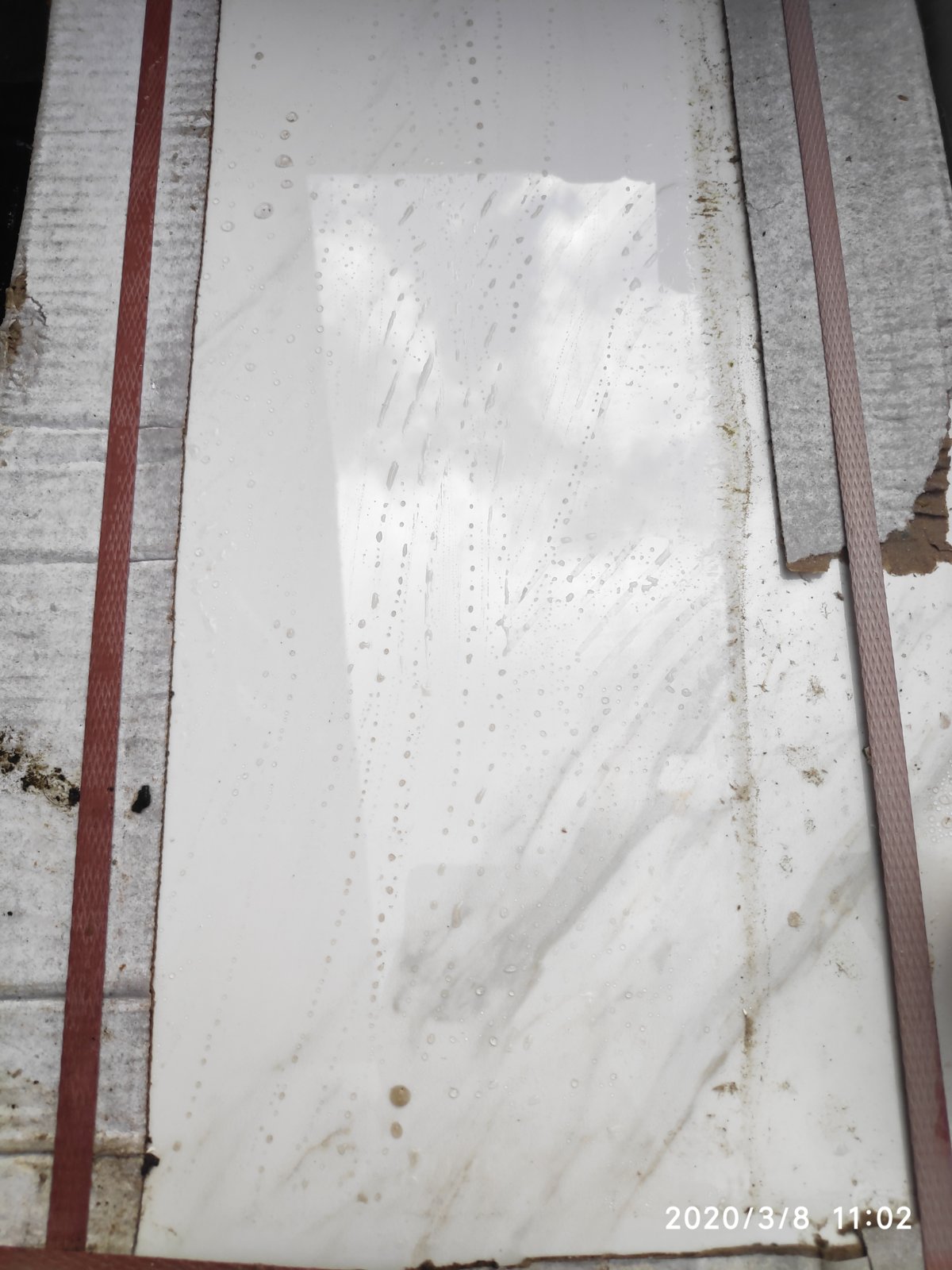

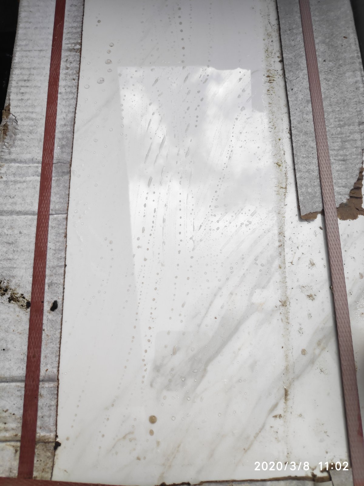

Hi, thank you all for your replies.
I was putting away the extra tiles packs from the refub (6 new packs), that have been sitting in the garden covered. Some of these packs got wet and dirty. I decided to have a closer look and to my surprise, these tiles also have this strange pattern on them. So this had nothing to do with the adhesive but more a manufacturing fault\defect. It's been months since I bought theses tiles, but will contact the suppliers and see what they have to say. I will keep you updated. Thanks
