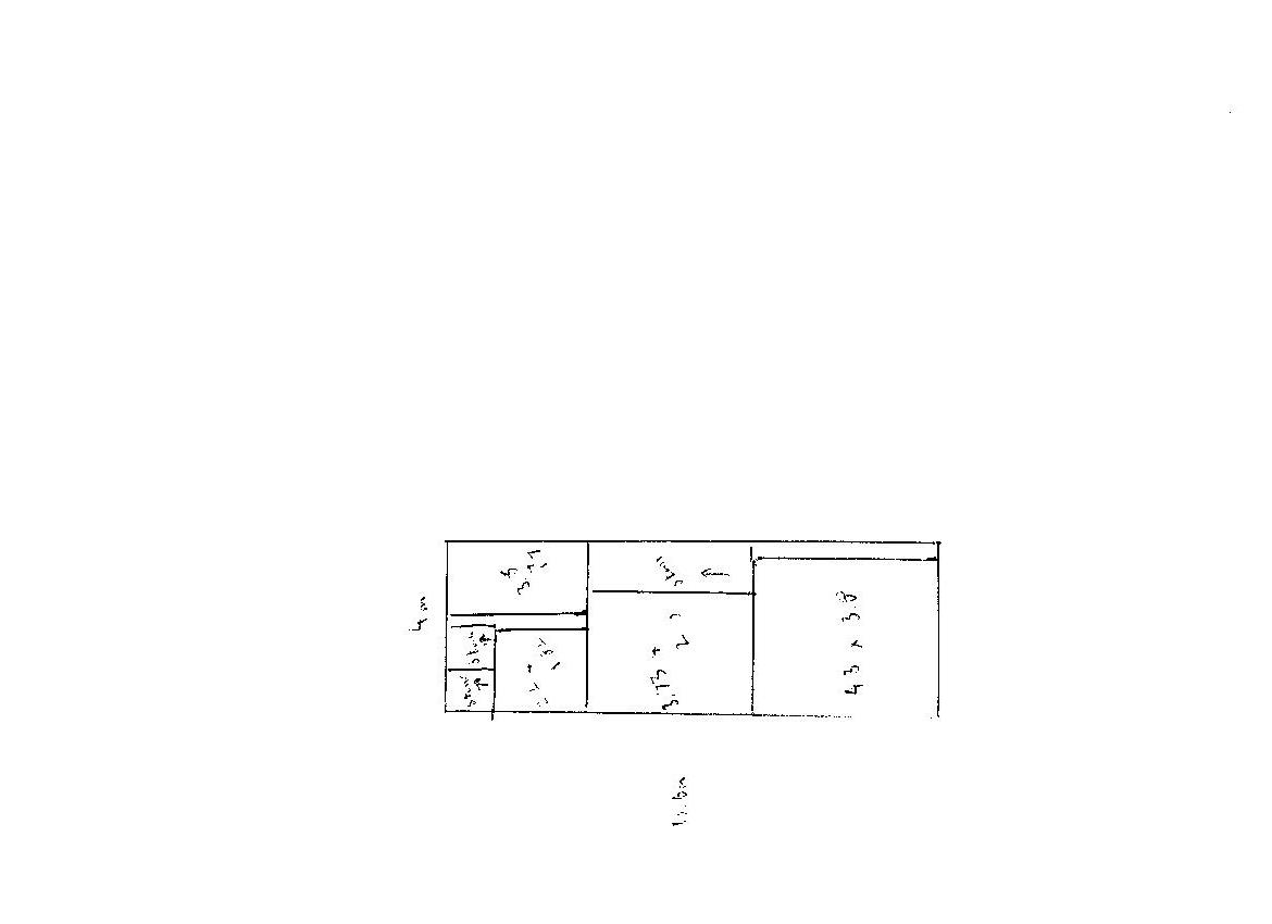

Hi Guyz
My carpet fitter is on holiday, The wife has found a carpet she likes, so Im ordering it up for when the fitter is back, can anyone let me know please how many m2 I would need to get please
Room 1
4.3 x 3.8
Room 2
3.73 x 2.8
Room 3
2.2 x 1.82
Landing
3.5 x 1.7
Stairs i have 13 Stairs
900mm wide
Tread is 250mm deep & 200mm high
the sizes above are exact sizes
I can work out the rooms, but i have offcuts that may do the stairs etc, this is where I get stuck,
thanks in advance if anyone has the time to work it out for me
Al

Why don't you find out how wide the roll is and work it out on a bit of graph paper?
The roll is 4m wide, Thanks for your help mate, thats what Im in the process of doing, Im trying not to waste any, which is the pain the bum bit

11.6m of a 4m wide dead plain roll if you are OK with joints on the stair run.
That's maths not a carpet fitters calc.
Diag attached

Hi bigal993
First thing I would do is add 10 cm per room length to allow for cutting in the carpet, so
Room 1
4.4 x 4 = 17.6 SQ MTR
Room 2
2.9 X 4 = 11.6 SQ MTR
Landing
1.8 x 4 = 7.2 SQ MTR
Not enough waste from these areas to find the stair carpet
Room 3 and stair
2.8 x 4 = 11.2 SQ MTR
SPLIT THIS DOWN THE CENTRE SO YOU HAVE 1 PIECE 2.8 X 1.92 THIS WILL FIT ROOM 3
THE REMAINING PIECE IS 2.8 X 2.08 WHICH WILL FIT THE STAIR IN TWO PIECES, EACH COVERING 6 STAIR TREADS
THE 13th TREAD WILL COME FROM THE ROOM 3 WASTE ( 1.92 x .5 )
This way the carpet pile on the landing and stair carpet is laid correctly brushing down the stairs.
You could order this in separate cuts or 1 roll
Other guys might have other ways to plan it but this would be my way
