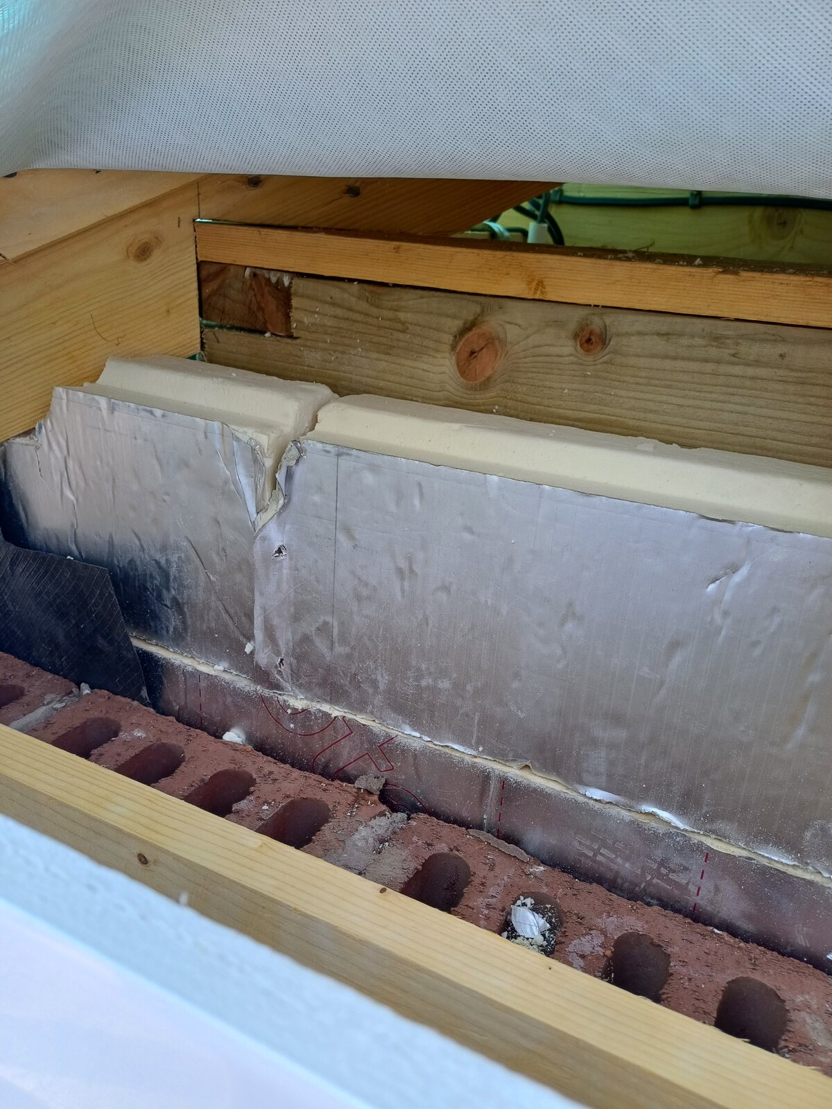

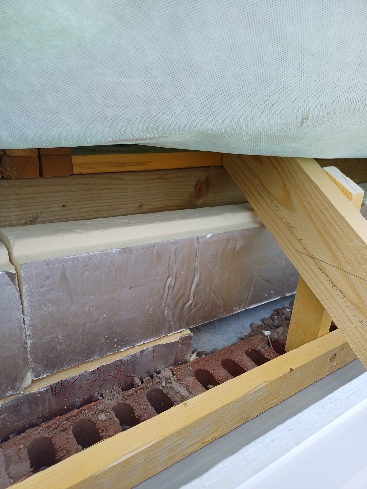

Some photos...

It needs to meet with the roof insulation, which we can't see.
There appear to be gaps, is he using expanding foam to fill them?
Roof insulation hasn't gone in yet so I'm keen to ensure we proceed correctly beforehand.
So are you saying the Roof insulation needs to go over the top of the wall plate and meet the top of the cavity insulation? Presumably something is needed to keep the roof insulation off the roof membrane and maintain a gap?
Are you recommending expanding foam for the gaps around the cavity wall insulation?
What insulation is going in, and what is the final roof covering?
The and roof insulation must meet, otherwise you'll have a cold spot. Whether a gap need to be left depends on the other details. Are there drawings for this build?
Yes, they should be fitted as tightly as possible, any joints that don't quite meet up should be foamed. Ideally joints should be taped too.

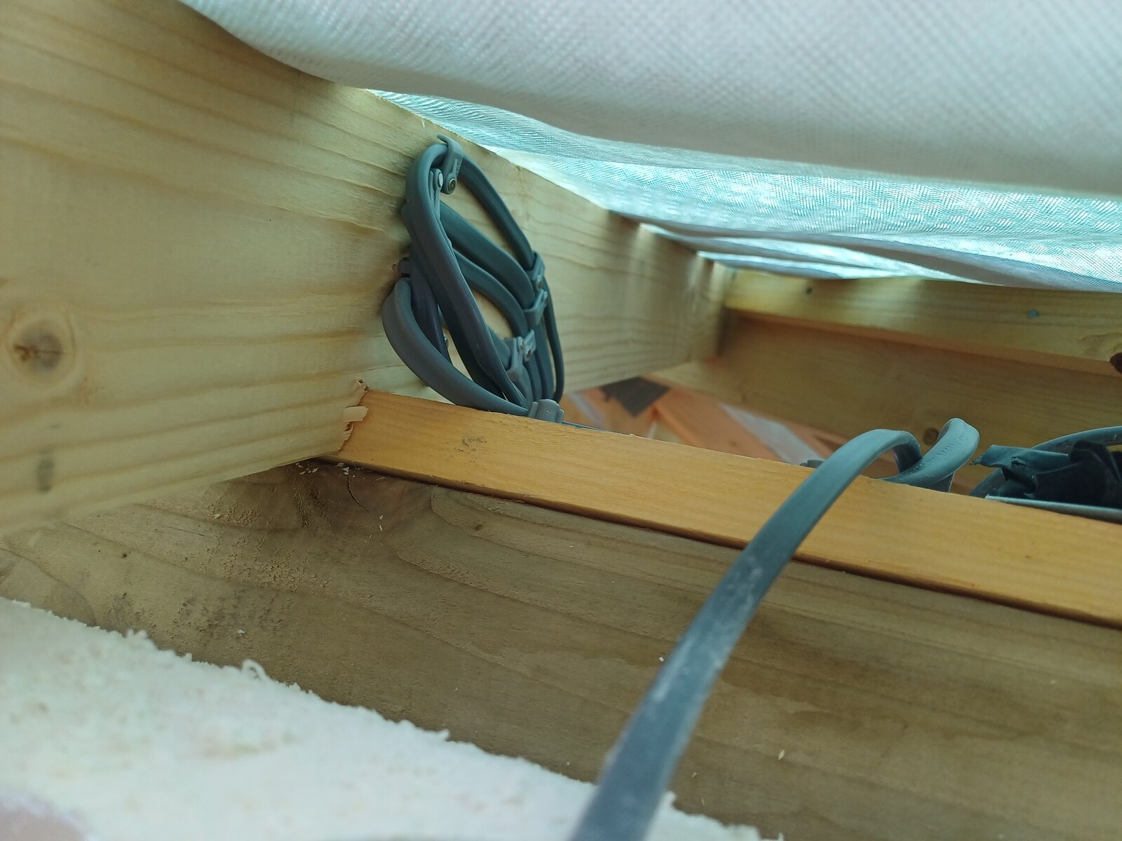

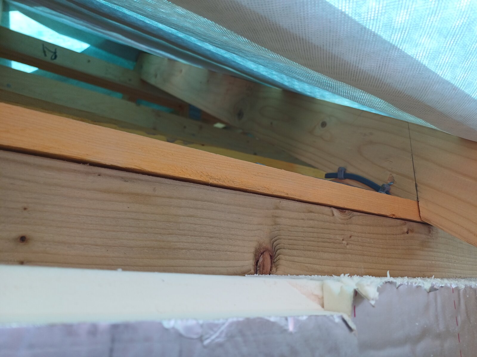

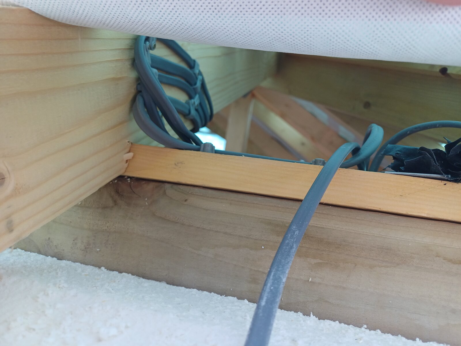

These might show better what I mean about the limited space between roof membrane and top of wall plate...

Plenty of space in there for an eaves ventilation tray, they aren't very deep.
The question is, why are you using loft roll insulation when you can use PIR at half the thickness? 100mm between, 50mm underneath.
It's around 60mm at the tightest point, partly because the wall plate had to be raised owing to the truss design.
I've spoken to the BC inspector and he has said with the need to keep insulation away from the felt (what is the required gap, 50mm?), that the main thing is to have insulation to the top of the wall within cavity and over the internal space within the loft. The actual wall plate doesn't necessarily need the insulation over it. So this helps.
Right, so a flat ceiling is going in? It did look to me that this was a vaulted roof extension, hence he confusion.
Eaves tray is available in at least 30mm depth, possibly less.
When you mention 50mm gap, you may be referring to a cold flat roof, which requires 50mm under the deck, not so the case here.
