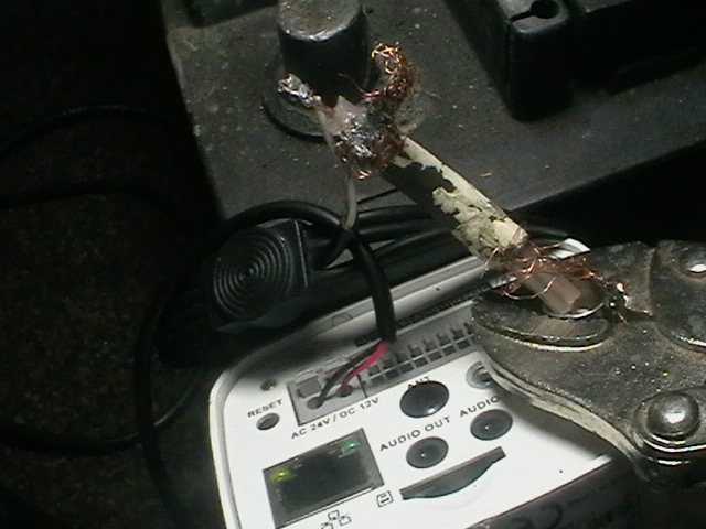

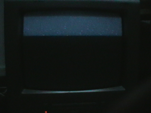

I had a go making up the cable, soldering together a coax cable onto a phono cable. I even found a lens from another camera that I swapped over.
I tried it on the TV and I now have a signal comming into the TV. But it is just a fuzz with and with out the lens
Well done to get a signal - that's certainly an important first step!
Are you sure that the lens is compatible with the camera you swapped it into (and that you have 'installed' it correctly)? Did it come from an identical camera and, if so, why didn't you do your test with camera that already had a lens installed?
Kind Regards, John
Yes it cam from an identical camera, i tried the other camera first but there was no signal on the screen
Interesting. That, in itself, is a little surprising - I suppose it suggests that the other camera is either ill or dead.
Kind Regards, John
or it could of all been bad signal from my soldering
... but didn't you use the same lead (soldered together by yourself) for both 'other camera' (when you got no signal) and the one to which you swapped the lens (when you did get a signal)?
Kind Regards, John
Kind Regards, John
I ordered the fitting so when it arrives it is just one problem to eliminate, presides I was told on a sound engineering forum that due to the high frequency of the TV signal a proper cable that has good resistance (75 Ohms) will be required to carry the frequency wave
I would have expected you to get some sort of signal with almost any type of (short) cable.
Kind Regards, John
For the very short cables you are testing with, it will make no difference. It would mostly affect the picture quality anyway, and quality is not important at this stage, just a functional test.
It’s not transmitting by RF , it’s video 1v peak to peak…….
I agree with your implied bottom line. As Harry and myself have said, virtually any sort of (short) cable (quite possibly even if there is a small 'air gap' at what should be s 'termination'!) ought to produce a picture of some sort.
However I would say that "not RF" is a little more debatable, since composite TV signals can be anything up to about 6 MHz, maybe even more :)
Kind Regards, John
