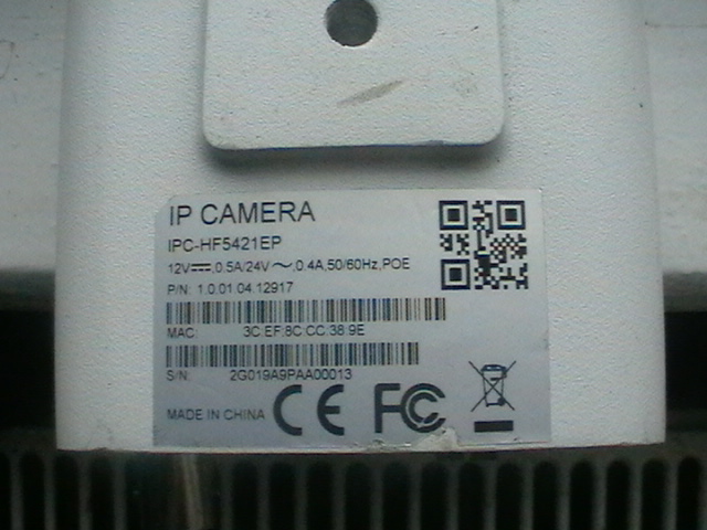

It will accept AC or DC anywhere between 12 and 24 volts, to power it.
Not quite, the markings clearly show AC24V / DC12V These devices are frequently just a single diode for half wave rectification and trying to run at 24V DC may possibly cause overheating, leading to failure.
12V DC or 24V AC, can be either...
Find yourself a 12V DC PSU.
Polarity is not marked so it makes no difference which way you connect it.
The polarity is clearly marked.
It may not work if reversing DC due to half wave rectification. Equally it may not matter if bridge rectified and you are if you're using a single local psu... but if a common psu for all cameras it's very important to observe polarity.
probably still ok

It will accept AC or DC anywhere between 12 and 24 volts, to power it. Polarity is not marked so it makes no difference which way you connect it.

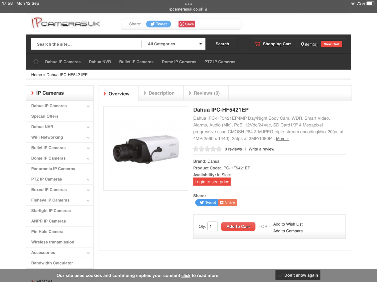

...just looking at the datasheet, and it will also accept PoE
Polarity is not marked; so I guess thats why it will run on AC as well.
It most certainly is polarity marked; black = negative, red = positive. I haven't handled this model but others have the negative terminal connected directly to the camera earth as is the BNC socket, so it's essential the supply is connected correctly if there is any chance one side is at the same earth potential as the video and if the PSU feeds more than one camera they must be connected the same.
For completeness the yellow arrows point to the 2 supply options, unless the manual says otherwise it's 24V ac OR 12V dc, the data sheet seems to agree.
Data sheet: https://www.ipcamerasuk.co.uk/pdf/HF5421EP-Datasheet.pdf
It mentions "Video Output 1 channel BNC(1.0Vp-p,75Ω)" But as this is still a current model it wouldn't surprise me in the slightest if it's 4in1etc multistandard.
