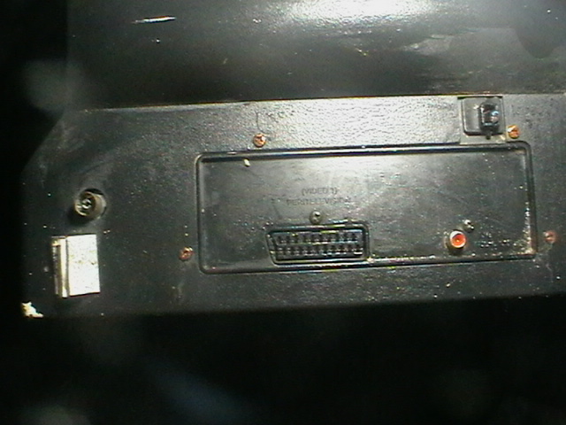

I though I would upload a photo of the back of my TV
So coax to coax no good then?

I though I would upload a photo of the back of my TV ... So coax to coax no good then?
No - but with a bit of fiddling, you might be able to get the video from camera into that SCART socket (the big multi-pin thingy).
